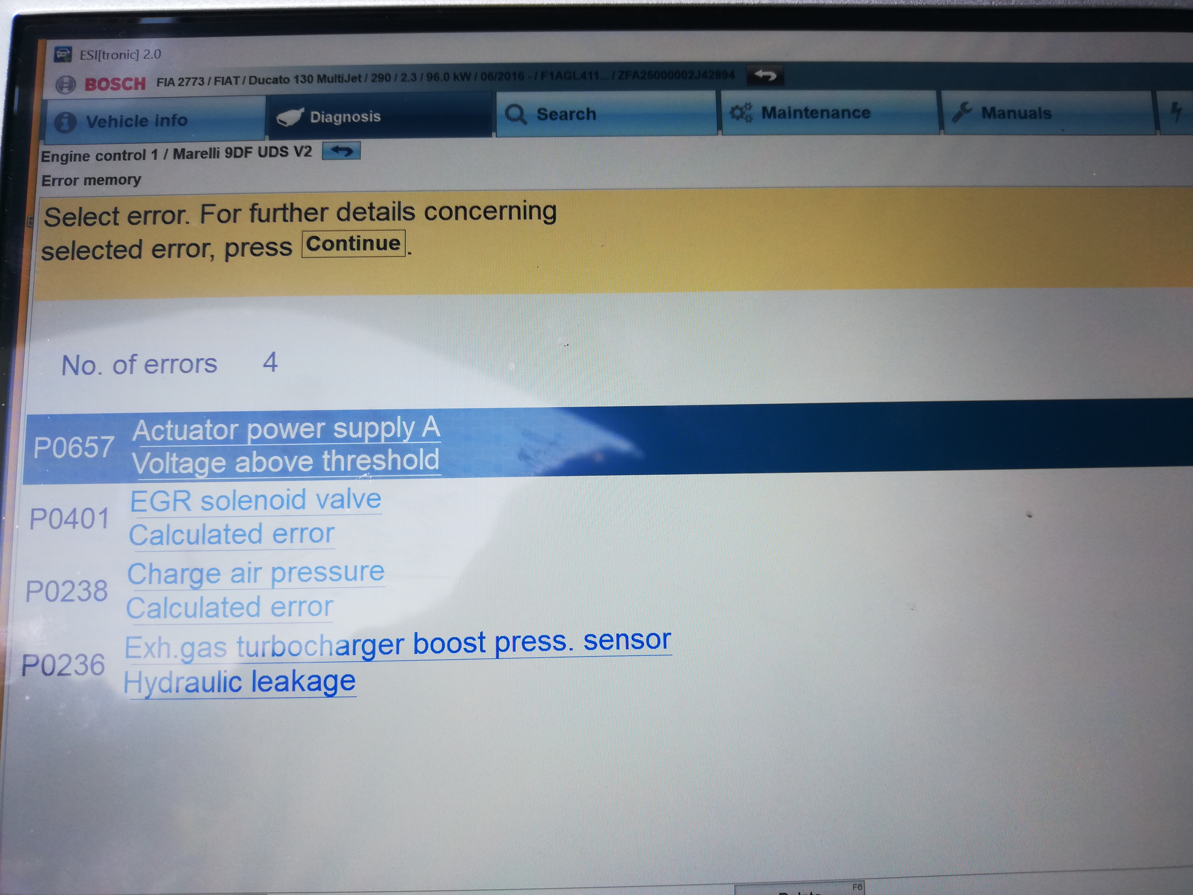

Technical Ducato P0401 P0402 P0236 P0238 and limp mode its 2017 Euro 6, EGR changed, What do I check next

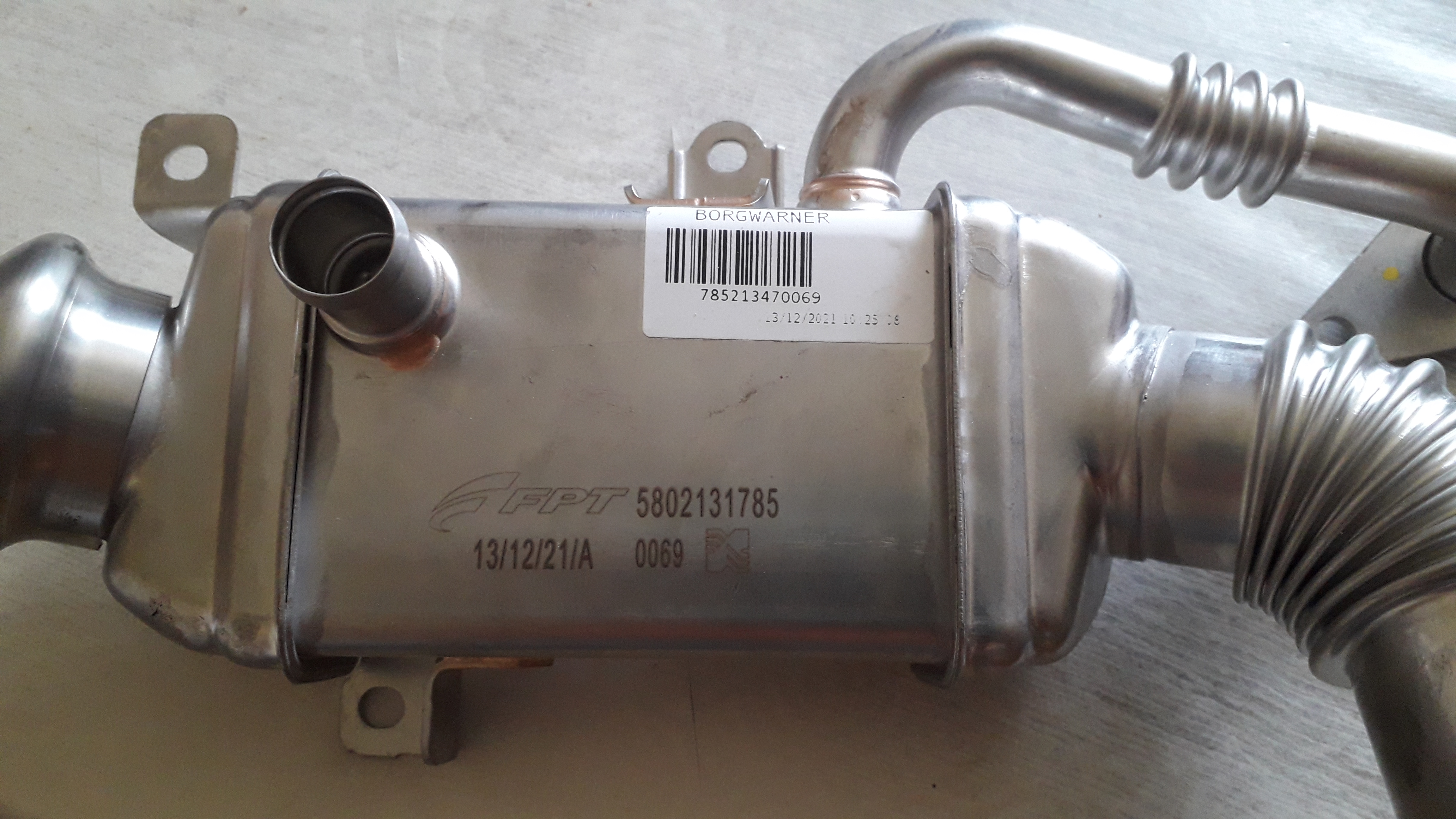

refroidisseur achete chez fiat 180euros au mois d avril aucun changement sur la piece je crois elle existe que chez fiat
vous pouvez netoyer l ancien refroidisseur avec de la soude caustique
bonne journée

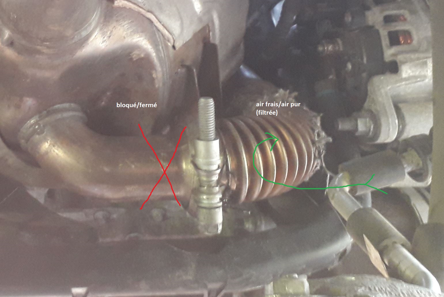

Bonjour Cariou,
Pour voir si j'ai bien compris, vous l'avez modifié comme sur cette photo?
Merci d'avance.

Unfortunately I don't know any French and my phone won't translate it. However, of note the photograph of part number shows it to be the same as my 2017 removed cooler. Please can one of our members provide a translation?
bonjours
c est exactement cela mais il faut que votre refroidisseur soit propre
hello it is exactly that but your cooler must be clean
bonne journée
hello
cooler purchased from fiat 180 euros in April no change on the part I believe only fiat supply it
you can clean the old cooler with caustic soda
have a good day
Hello Cario,
To see if I understood correctly, you modified it as in this photo?
Thanks in advance.
bonsoir
exactement j ai fermer avec une plaque et mis un filtre sur l entrée du lpegr cest un preparateur automobile au circuit de NOGARO FRANCE ma dit de realiser ce schema
good evening exactly I closed with a plate and put a filter on the entrance of the lpegr it is a car preparer at the circuit of NOGARO FRANCE told me to carry out this diagram

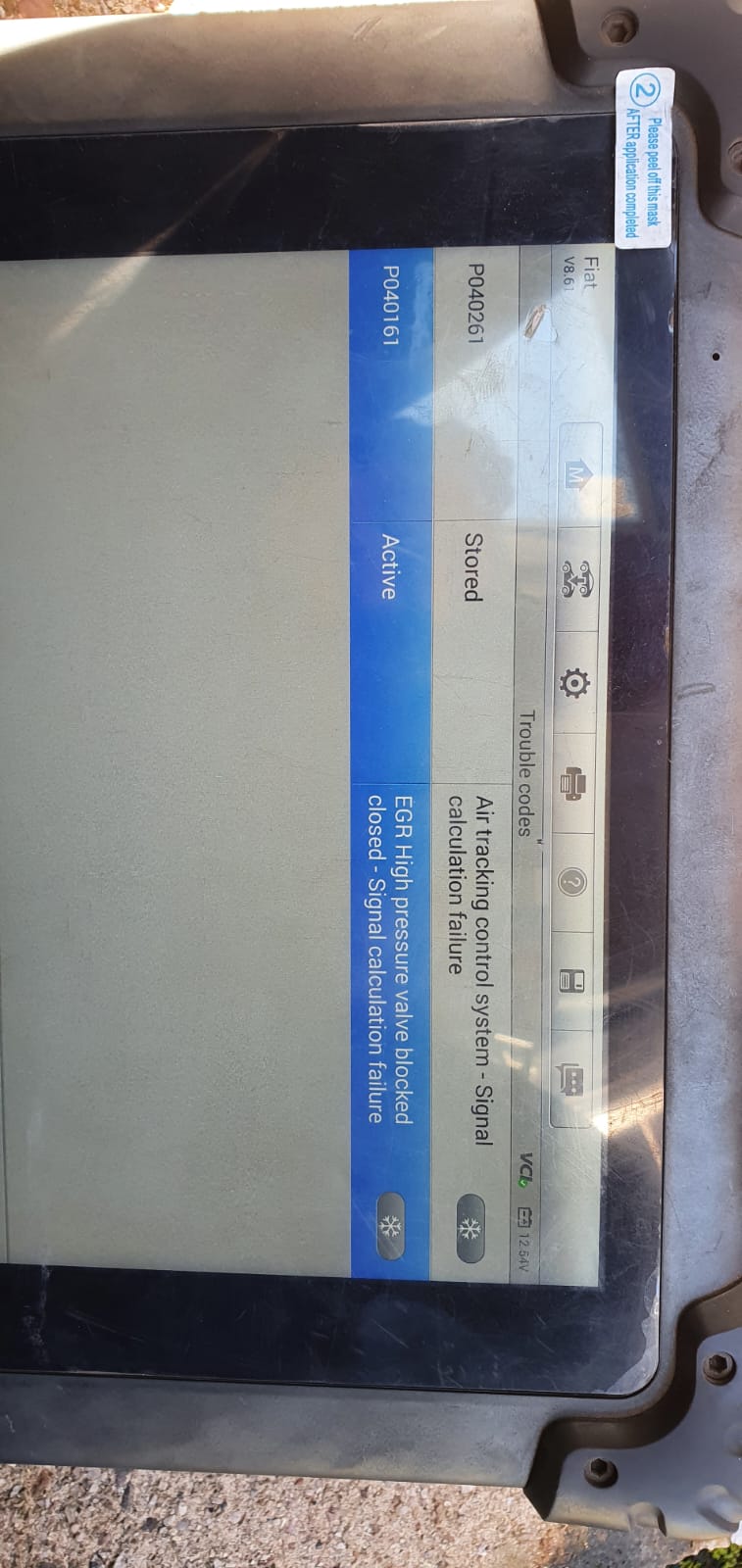

Hi
Although MHome registered 2019, i checked the VIN and its a 2018. I don't have adblue. The codes seem the same, refer attached. Work done so far has cleared the warning light but Fiat mechanic says diagnostics still find a code. Will find out later which one.

Hi
