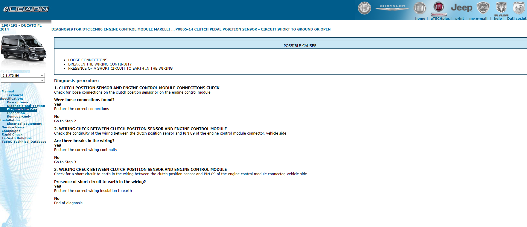

P0805-14 Clutch pedal position sensor - short circuit to ground or open
