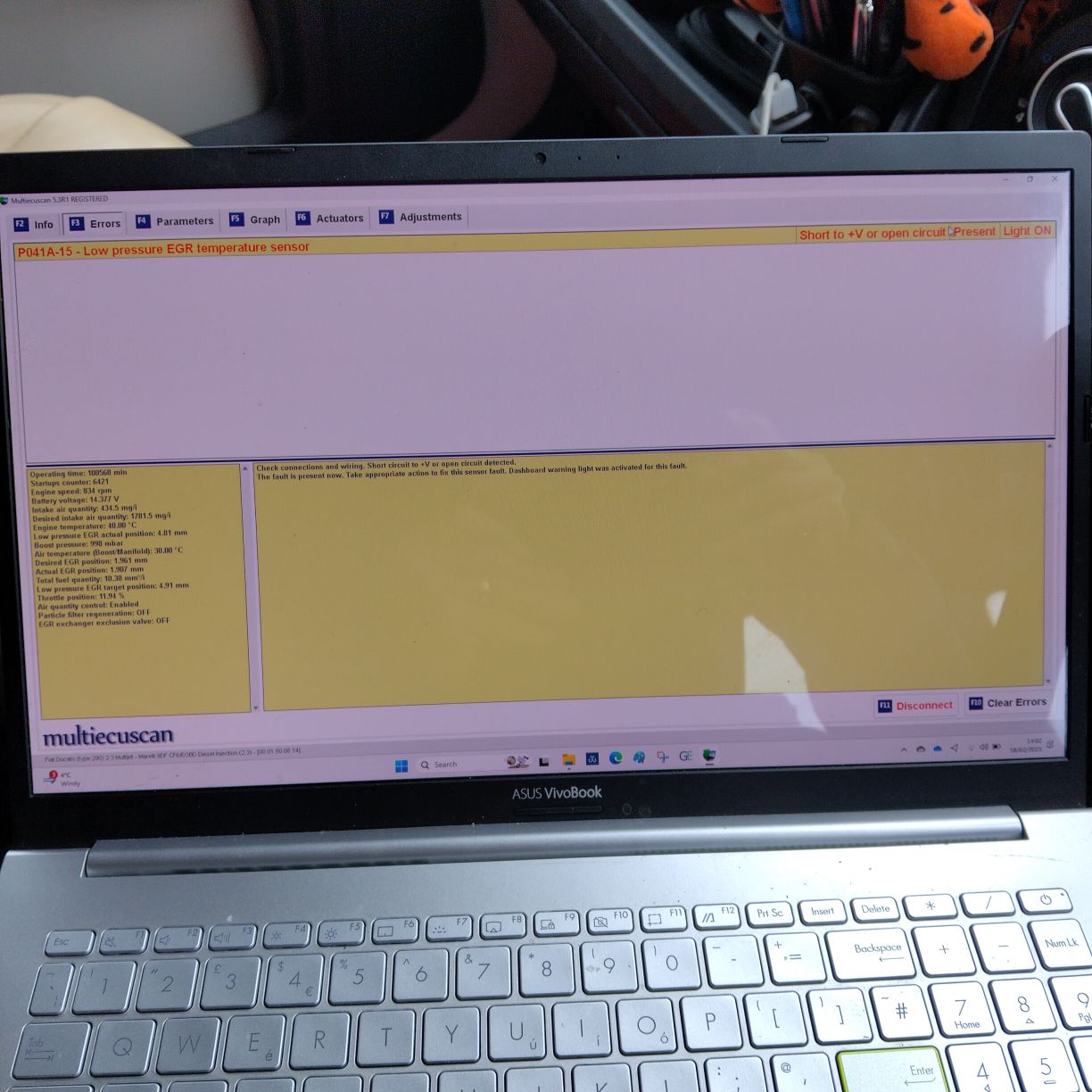

Engine light came on in France and the garage diagnosed EGR fault and changed the EGR. 200km down the road engine light back on but the van drove OK but did go into limp mode 4 times on the way back to the UK.
Message from Multiecuscan says P041A-15 Low pressure EGR Temperature sensor short to +V or open circuit.
My question is "where is this located" so at least I have a starting point.

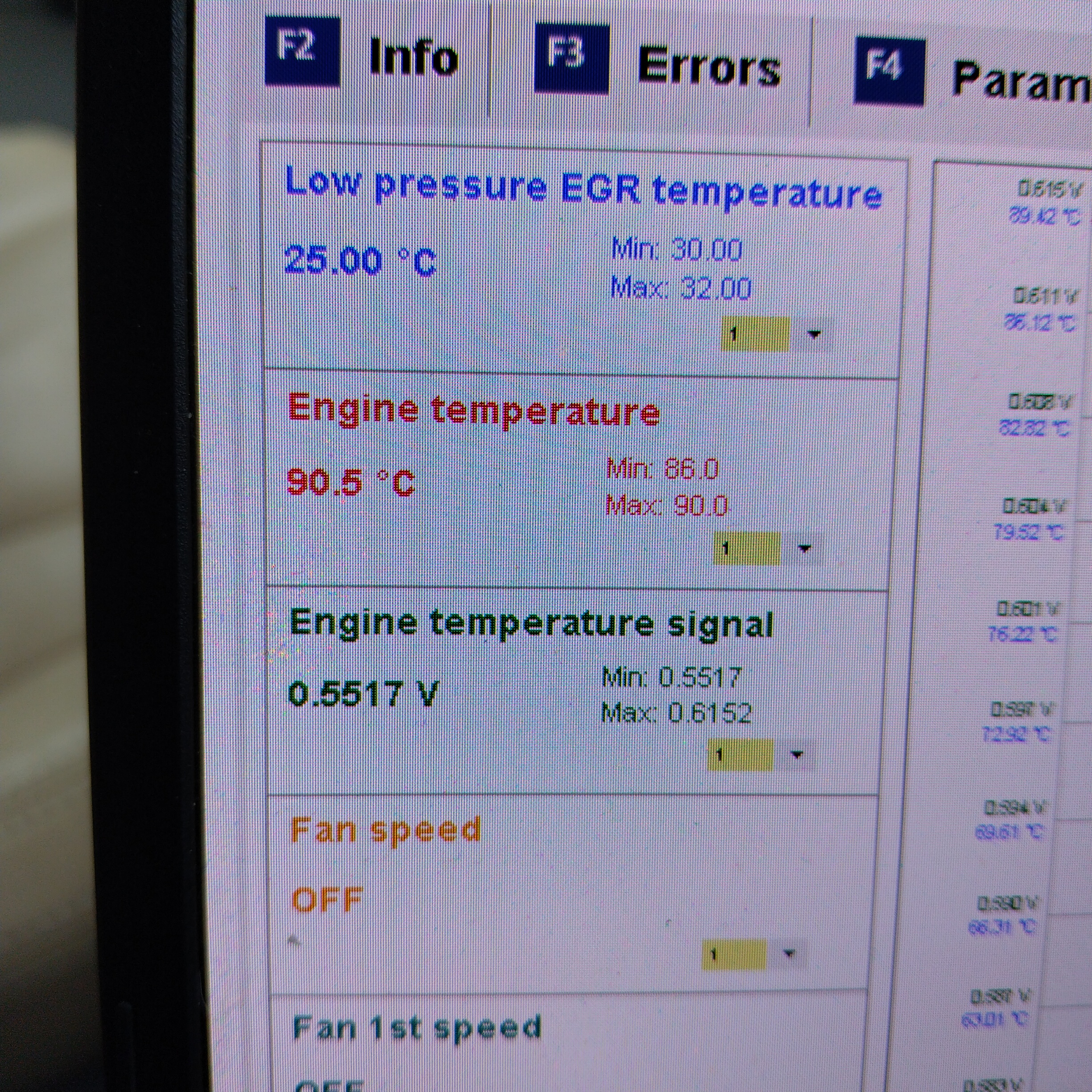

Other thing I have noticed is that when this fault is present the radiator cooling fans do not come on when I park up even when coming of the motorway
which seems odd.
I have tested the fans and they work ok via Multiecuscan.

I ran multiecuscan again with the EGR temperature sensor on graph along with Engine temperature and Fan speed 1 and 2 as well.
Noticed that the fans didn't come on at all even though the temperature gauge was sat at normal when the engine temperature was 90C (see picture) according to multiecuscan. So maybe a fault with the dashboard or the temperature sender.
Low pressure EGR temp sensor seems to be reading fine so I don't know why it sometimes shows code P041A-15

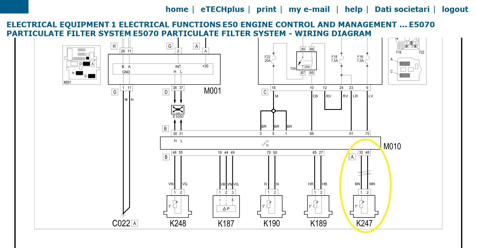

Marked sensor is LPEGR temp sensor. this shows ECM connections
Not easy to get at. drop sub frame and 8 hrs plus or remove battery box view through hole, white arrow is temp sensor
Note as yet not identified LPEGR valve connections, the MES run with above template will identify if LPEGR is moving or if temp sensor an issue.

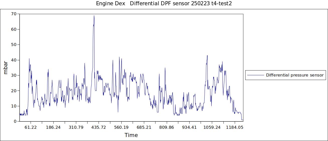

@dextron16 whatever you do , DO NOT replace the hpegr valve. Read these first i will look at your data a little later.

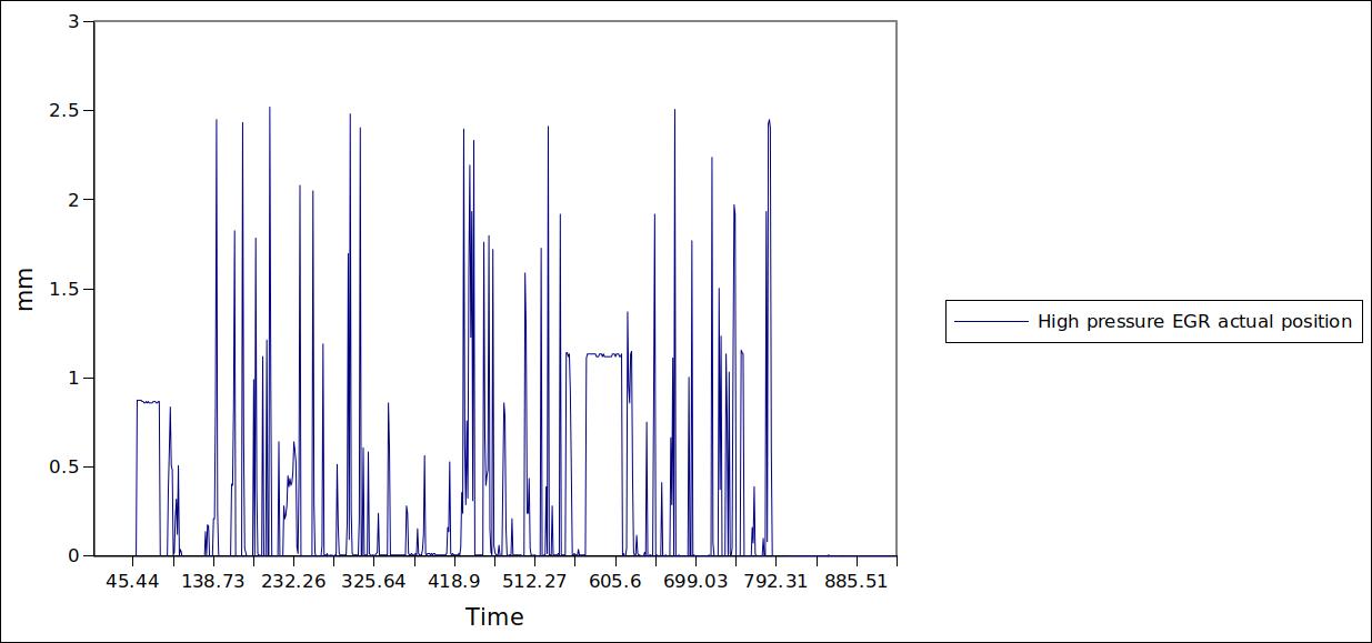

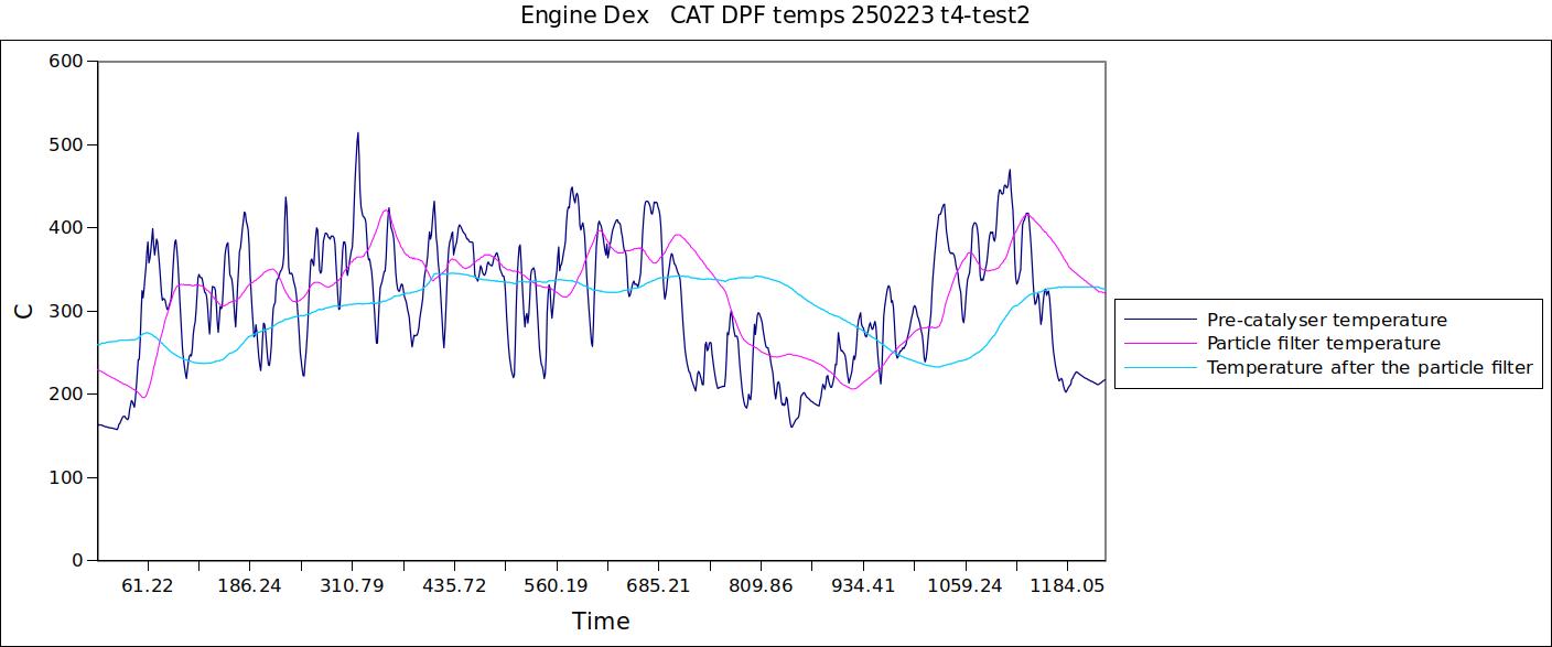

Having fully looked at your data i can see a few things

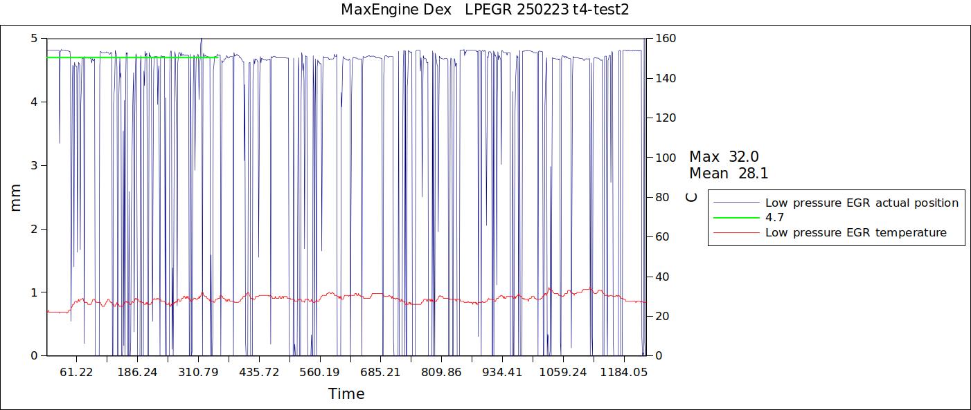

1 you are suffering from LPEGR cooler syndrome ie the cooler is blocked and i wouldnt be surprised if the exhaust pipe is sooty please take piece of kitchen roll and wipe it out.
2 the lpegr max temperature @30 is the lowest ive seen it could be this that triggered the P041a-15 error
3 the dpf regeneration didnt completely finish the temperature 644 is OK 400 miles between regens ok
@Fredastaire
there is another thread on this subject its short only about 69 pages, you ought to read it and introduce your problem there as its the repository for egrcooler problems.
so a few questions what software version have you got. F2 on MES
This graph is indicative of a blocked cooler
the valve varies between max an min with little area of control in the 1-3 mm region (see guide refered to earlier)
A typical good engine has max temp upto 160C (140C typical) and mean about 100C
Engine Dex   CAT DPF temps 250223 t4-test2.jpgEngine Dex   Differential DPF sensor 250223 t4-test2.jpg
Engine Dex   HPEGR 250223 t4-test1.jpgEngine Dex  injector 250223 t4-test1.jpgEngine Dex    O2 sensors 250223 t4-test1.jpgEngine Dex   LPEGR 250223 t4-test1.jpg

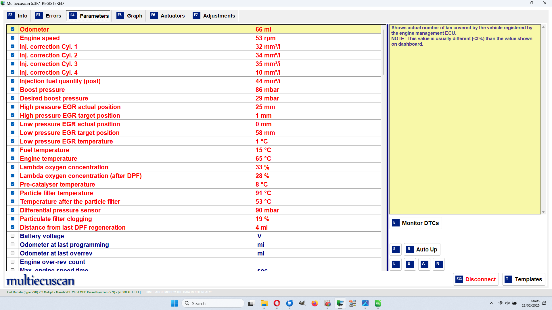

OK LPEGR cooler has been replaced.....
Attached is a graph (Excel spread sheet) of the results and it looks like a success and a correct diagnosis. I have been on a 100 mile trip since and all seems well. No errors, no lights and the van is running better, Also the exhaust is cleaning up, the tail pipe has some soot in it but nothing compared to before I shall see in time if it goes completely or not.
