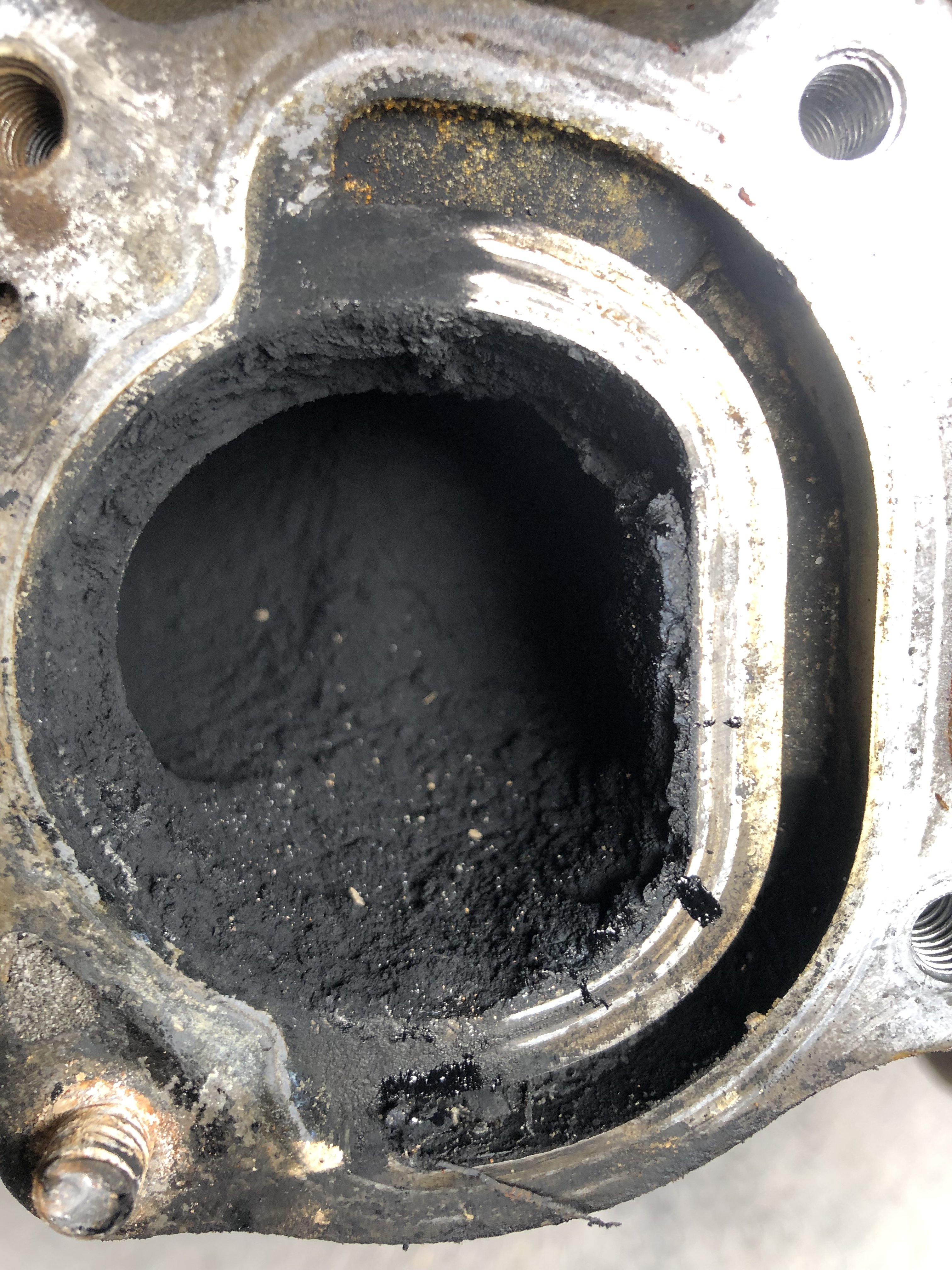

my inlet and all the crap from an egr.
@LandyAndy is that Ducato in the photo? On the basis of yes, what year/model?
It is a 2009 Ducato with 32thou miles / 51thou km. It has never had any warning lights, shows now codes on a basic reader, and just showed “MAF compensate at idle”
A bit sluggish on high speed hills, black smoke on acceleration with high temperatures, some white / grey smoke occasionally after start up. Ran and ticked over ok and I would never have thought it to run so well with EGR stuck open. It killed my turbo, but caught it in time or could have been much worse.
My EGR is now fully blanked off with metal plate, and am getting it blanked in the MAP on ecu. Have spoken to tuner who will do EGR remove plus a mild MAP for £250.
Interesting now playing with the engine now with EGR blanked, or seeing what the van drives/runs like if it was a stuck shut EGR scenario. Very different symptoms
