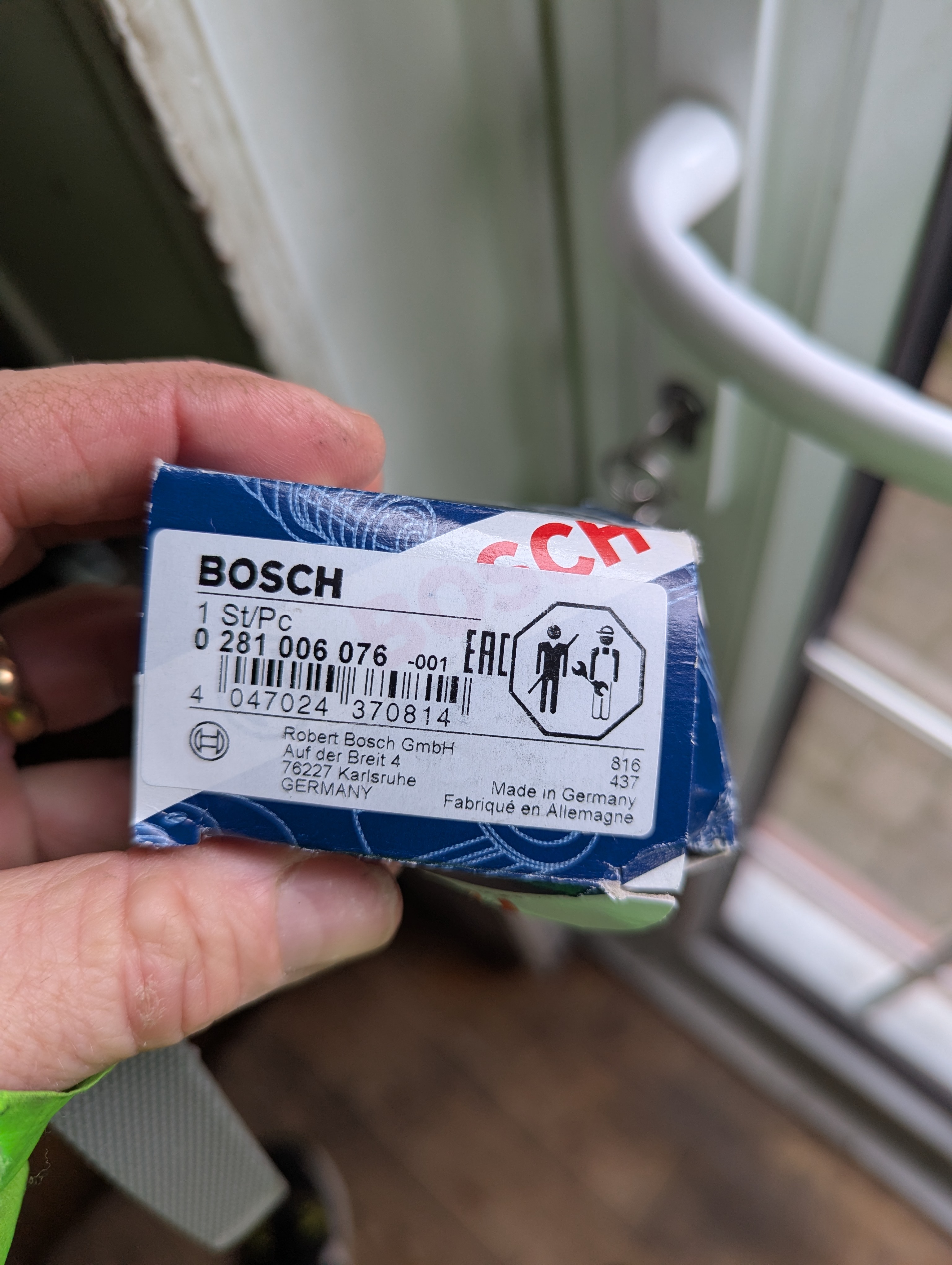

Found a bit of paper work on van shipment from garage to swift to convert to motorhome.
At fiat 31/07/17.... At swift 10/09/17 .
Reg DVLA march 2018 . Incorrect MAP fitted but I'll have to try and find it to check part number , fiat never recommend MAP change, was done as advised by forum by myself.
Original MAP sensor as fitted by fiat
And replaced with 0281006076 . Bosch

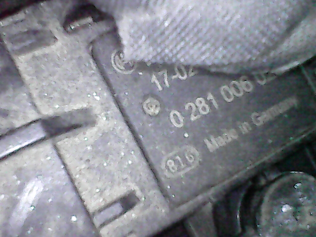

I don't know if it's significant but what I take to be the manufacture date, 17-05-04, is, on mine, 17-02-....
And on this one, Thomas Lypold's, 16-12-07.

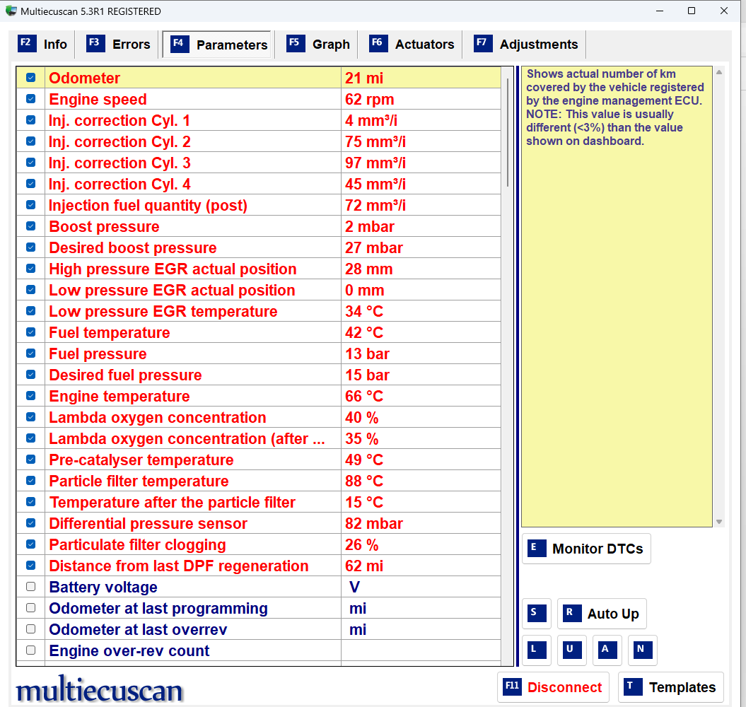

The implication is there. I need more regen data for v32 and earlier. I have v28 and have a couple of events so know how difficult it is to capture. The required pids are in new template4

Summary that I quickly found.
@Fredastaire #9
Old sensor no. Bosch 0281006028
New sensor Bosch 0 281 002 845 (OE 050424527)
@Thomas Lypold #56
Old sensor Bosch 0281006028
@theoneandonly #70
The supplier of the new sensor informs about the change of number to 0281006076
@Jiwawa #1445
The offer from Fiat there is a sensor number OE 504369148
I also wrote to Fiat asking for my MAP sensor number and received a reply that the correct number is 504369148. After entering it in Autodoc I got these results
Which one is right?
