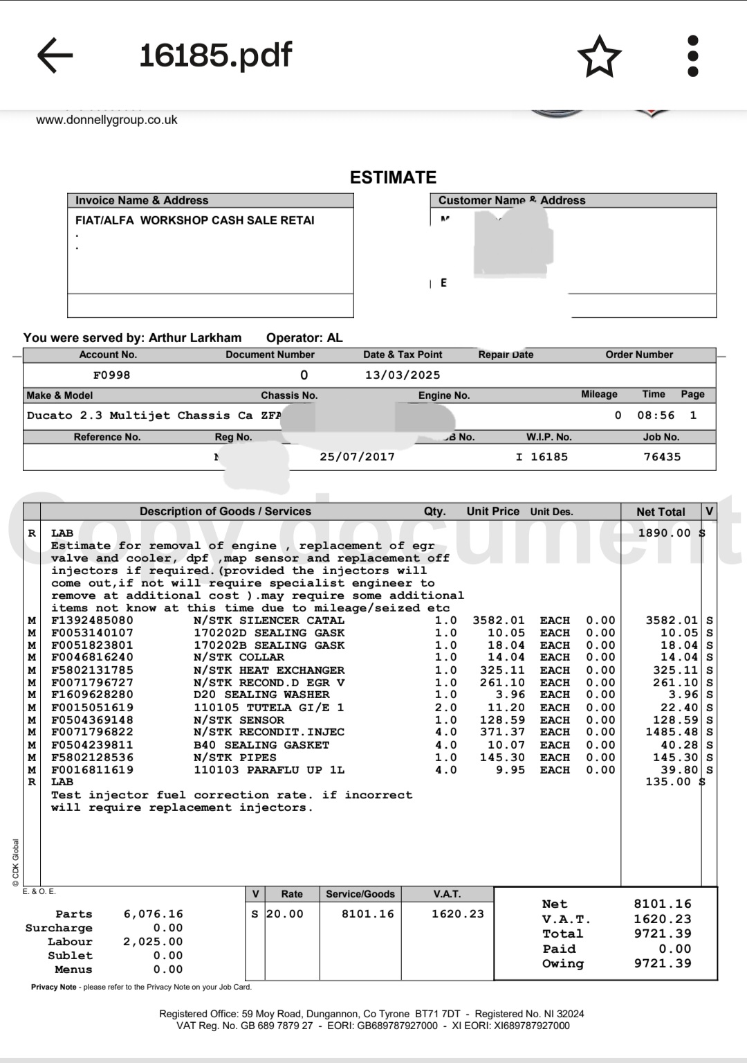

So I've got quote to get van back to correct set up for anyone who wants to get a idea of how much it is at fiat professional garage.
Or if you need part numbers for reference.

My quote has few more parts on it. It includes the MAP as I have the 'wrong' one fitted (from new). I'm not panicking just yet as I'm talking to Fiat Customer Care (onto whom I was fobbed having contacted the CEO).
I see they also a " if injectors need changing" that will go over a £10k bill . Hope you get something towards it from fiat!
