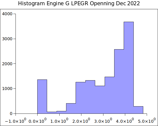

@theoneandonly I am quite fond of using time-series graphs to show how parameter values varies and have probably done thousands in my work (in entirely different contexts from what we are dealing with here). But they can sometimes be cumbersome to evaluate when there are several interrelations between the parameters. So I was wondering if one could supplement the time-series with some statistical analysis in e.g. Excel, and made a mock-up as a food for thoughts. It might make the data evaluation easier and would perhaps even add some value. I'm not at all sure, maybe I'm just "chasing ghosts", but anyway:
Step 1 was to group the EGR position values from my test drive as frequency distributions, using pivot table. This shows the percentage of time (above 79 Deg C engine temp) that the valves "spent" at different positions. (Removing the filter, it also showed me that the HPEGR valve reported values higher than 2,75 only when the engine temp was below 79). A similar grouping can of course be made for the LPEGR temp also.
Step 2 involved playing with the idea of showing how EGR positions, and later LPEGR temp, vary with two other supposedly influencing parameters. I assume engine load should be the first parameter. This could be represented by total fuel quantity, that was not logged in my data so I used randomly generated values instead. For the time being engine rpm was selected as the other parameter. So a grouped pivot table with (FAKE) engine load as rows and engine rpm as columns looks like this (cropped width):
I would appreciate any comments or ideas on whether something like this could be of value in evaluating this data. Once configured, the evaluation of new data files would be very fast. What parameters would be the most relevant to use in the step 2 example?
