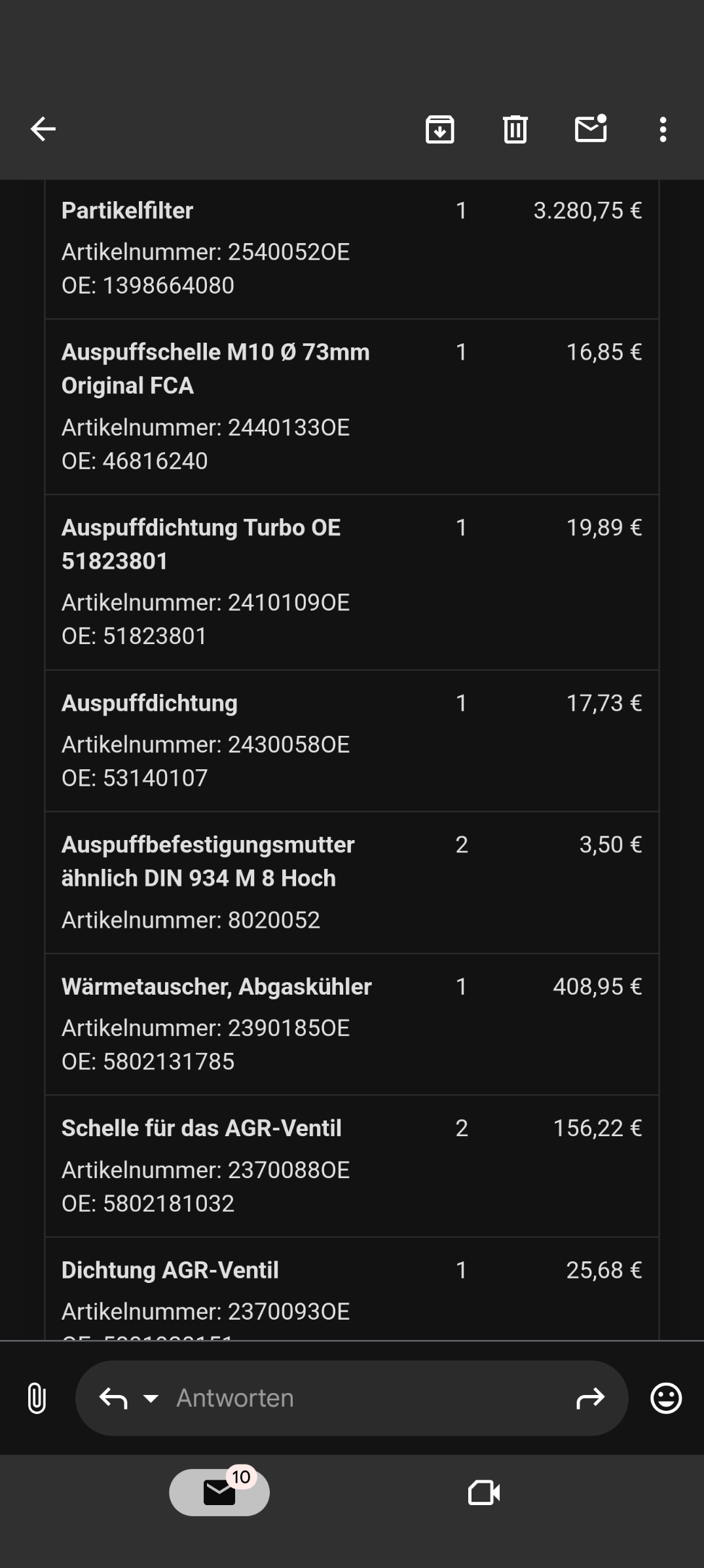

These are the Partnumbers for DPF, LPEGR Cooler and additional stuff...130 HP Ducato , Manual Transmission,Twin EGR as told by Augustin Group in Germany...prices in Euro, all Original Fiat Parts...told them my VIN Number,so that they can send the matching parts

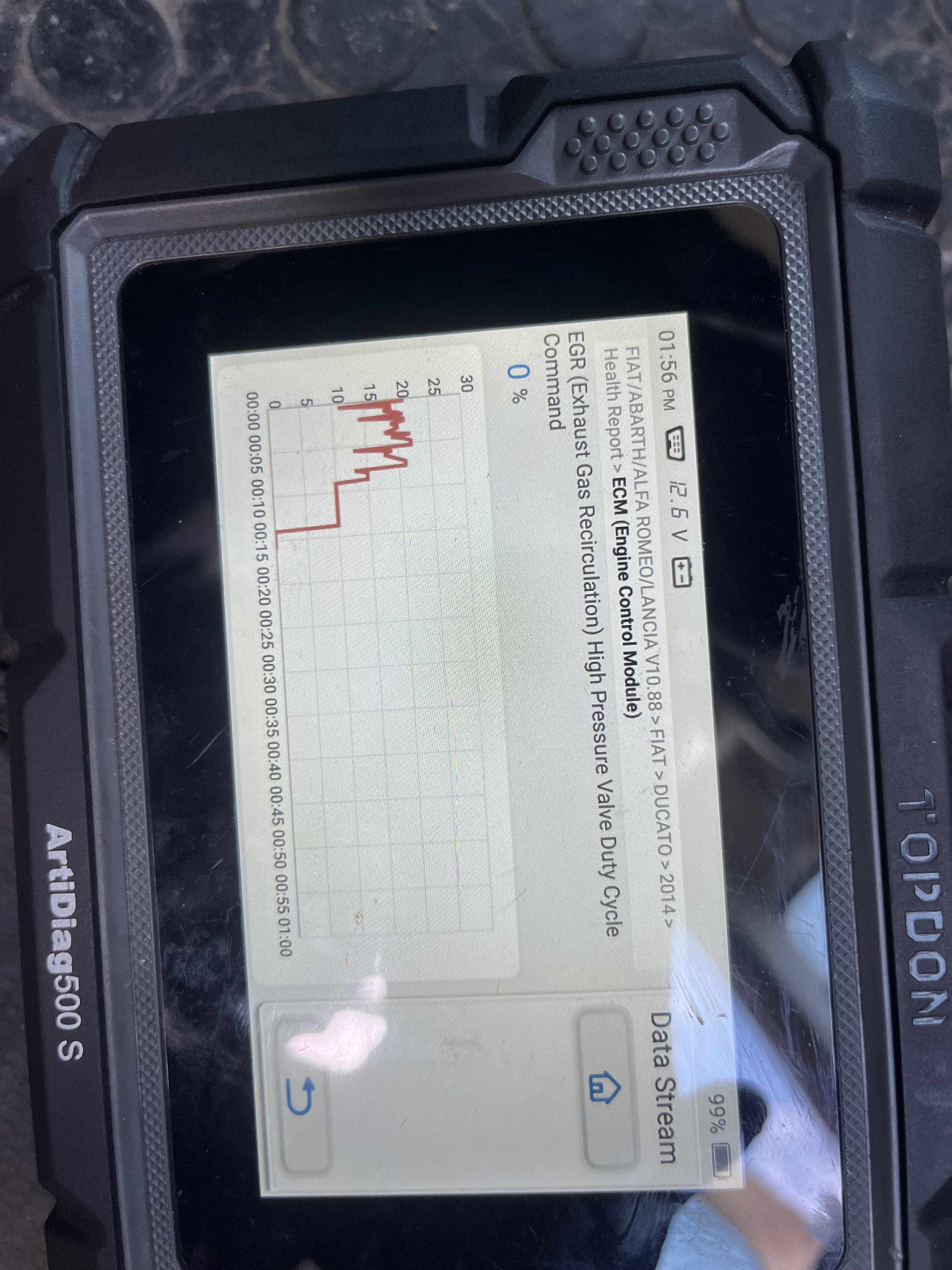

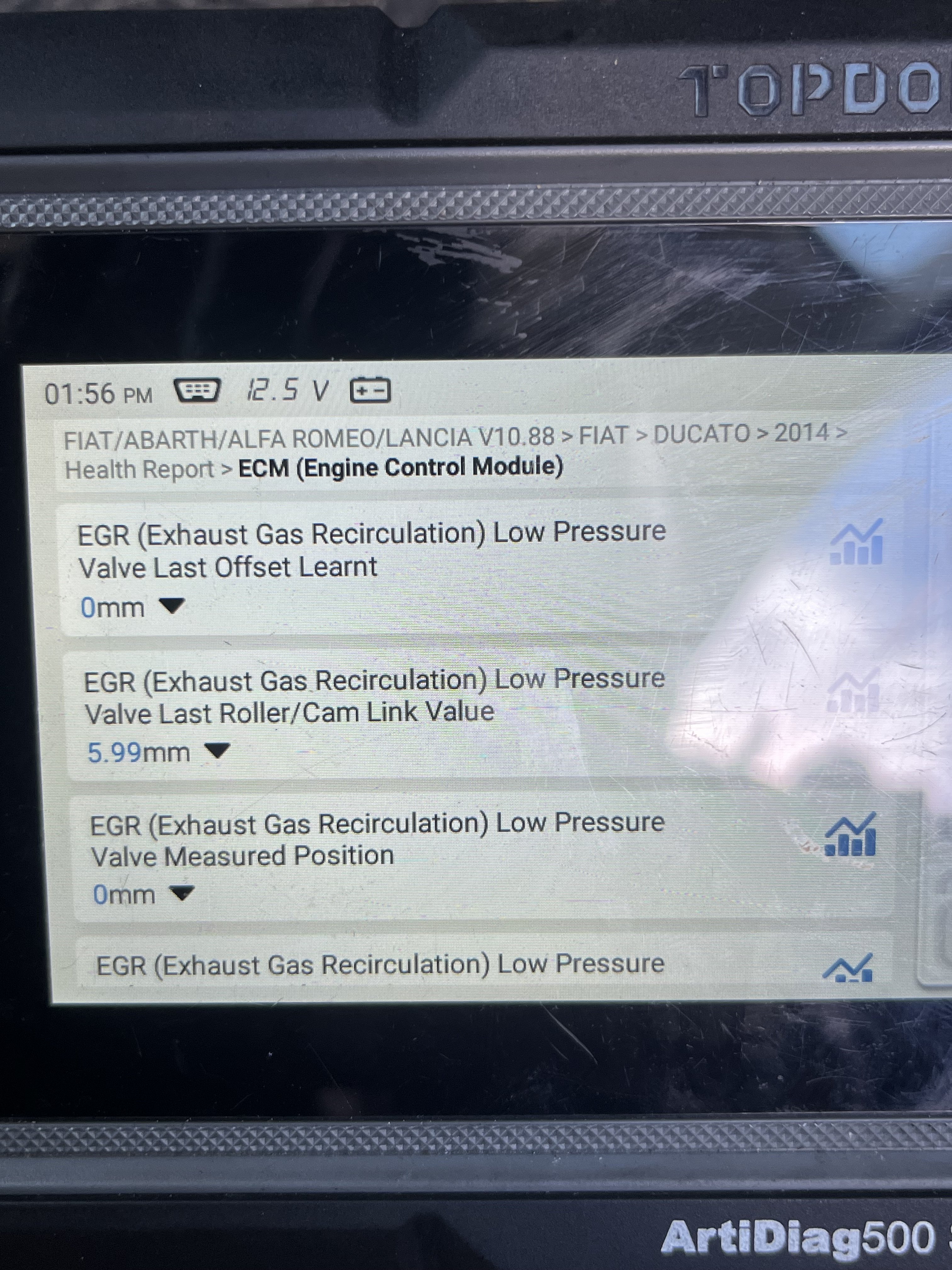

Hi guys I’m back again as some of you may know me and the work carried out in this truck because of the p0401 code, new had new turbo, dpf, lp egr and hp egr,, then two weeks later head gasket went so done that and truck has been fine since that is until today I noticed higher revs on tick over scan slapped scanner on and guest what code is showing again yes that awful p0401 code 😡.
The only thing we didn’t change was the cooler we cleaned it instead but I think it might be blocked again,,, so my question is had anyone removed that stupid metal net that blocks ? I’m thinking of removing it what do u think ?
Also ill attach some pic of live data

Have you looked with Multiecuscan? You can view the LP EGR opening and the temperature probe reading. If the LP is regulating only from fully closed to fully open, the probe temperature keeping low, say 30- 70 degrees then you will know the cooler is blocked. I suspect you would also get P0401 if the air filter was blocked/ MAP defective. If you run MES with the standard template from @theoneandonly he will readily confirm if it's the cooler at fault.
The only thing i can see is that the HPegr valve works as expected. The two important pids for live data is the LPEGR actual position and LPEGR cooler temperature a csv file of 10 mins data with a warm engine will confirm problem. If it is a blocked cooler.
