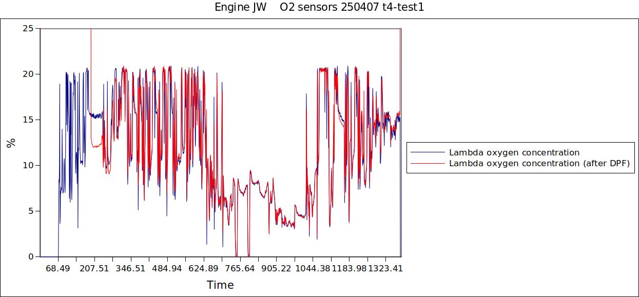

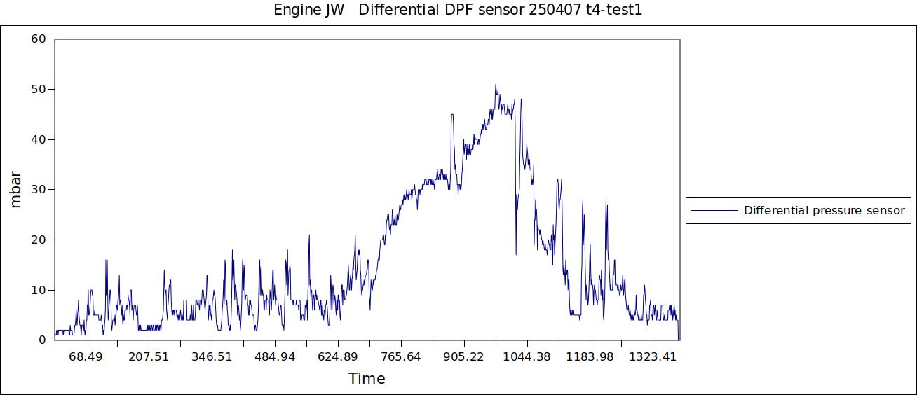

I ran Template 4 on the way up - only 7-8 miles but hopefully long enough to collect some info. I wiped out the exhaust before travelling, then again on arrival and showed that bit of paper towel to FP. They seemed surprised tho I have been telling them about this, and my fear of soot in the engine oil, for months.
T4 attached.
Engine JW   Fuel Sensors250407 t4-test1.jpgEngine JW   CAT DPF temps 250407 t4-test1.jpgEngine JW    O2 sensors 250407 t4-test1.jpgEngine JW   Differential DPF sensor 250407 t4-test1.jpgEngine JW   Turbo pressure 250407 t4-test1.jpgEngine JW   HPEGR 250407 t4-test1.jpgEngine JW   Regeneration  250407 t4-test1.jpg
Most as expected indicating LPEGR cooler issue. The HPEGR is fine working as expected.

Thanks @theoneandonly, is there anything in that (apart from blocked cooler indications) that would point to a cracked DPF?
The sooty exhaust

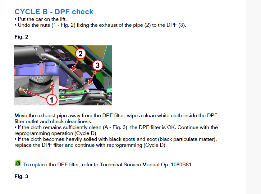

Have you still got the service news? its also in the downloads section
maybe this is the first thing they need to do they have already replaced the HPEGR
Yes thanks, I do have the service news. They replaced the HPEGR on the last repair (Feb 24) not, so far, this time. They were about to check the injectors I believe. But in the service News that comes AFTER the DPF check.... I'm pretty sure they haven't done that.
I dont think so either , because of the surprise to see a sooty exhaust
They have now (checked the DPF per the service news) and surprise, surprise, there's lots of soot 🤷🏼‍♀️ so they're on the hunt for a new DPF (not easily found).

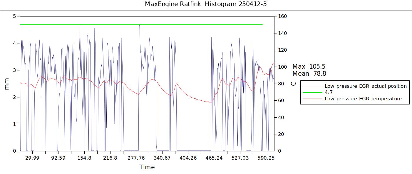

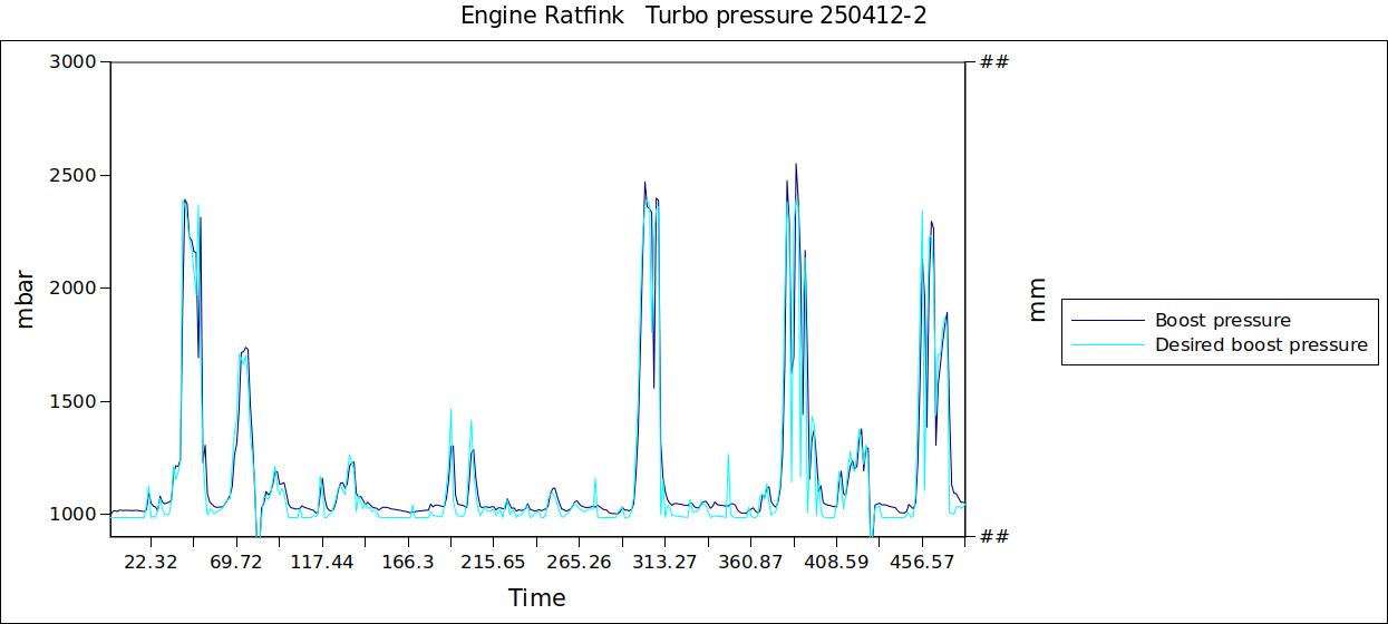

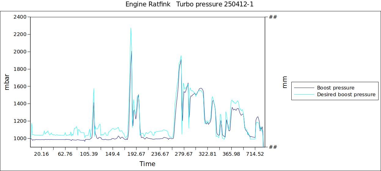

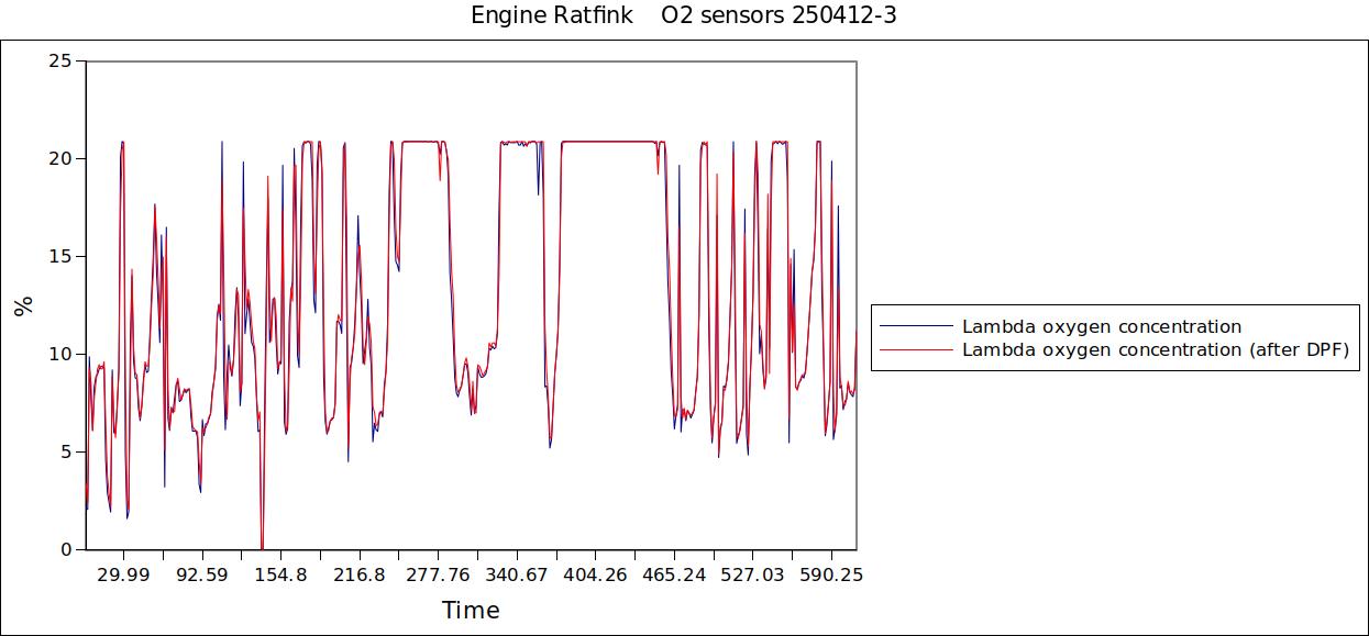

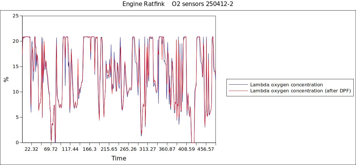

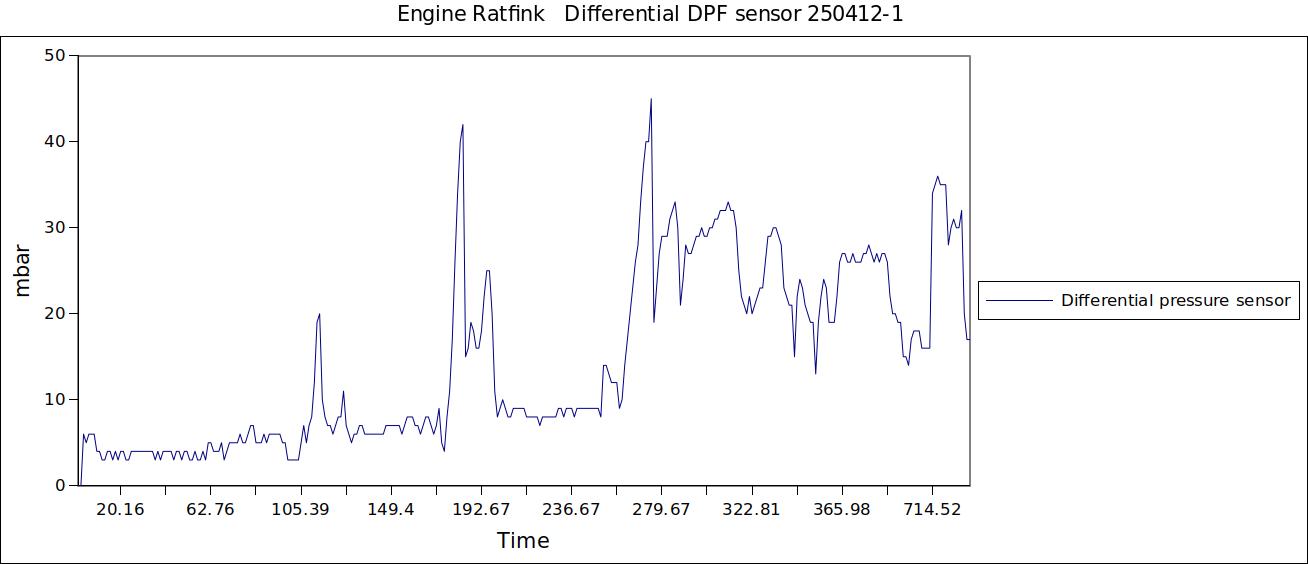

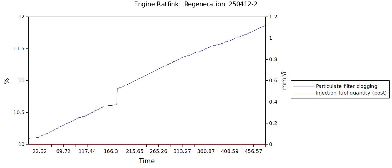

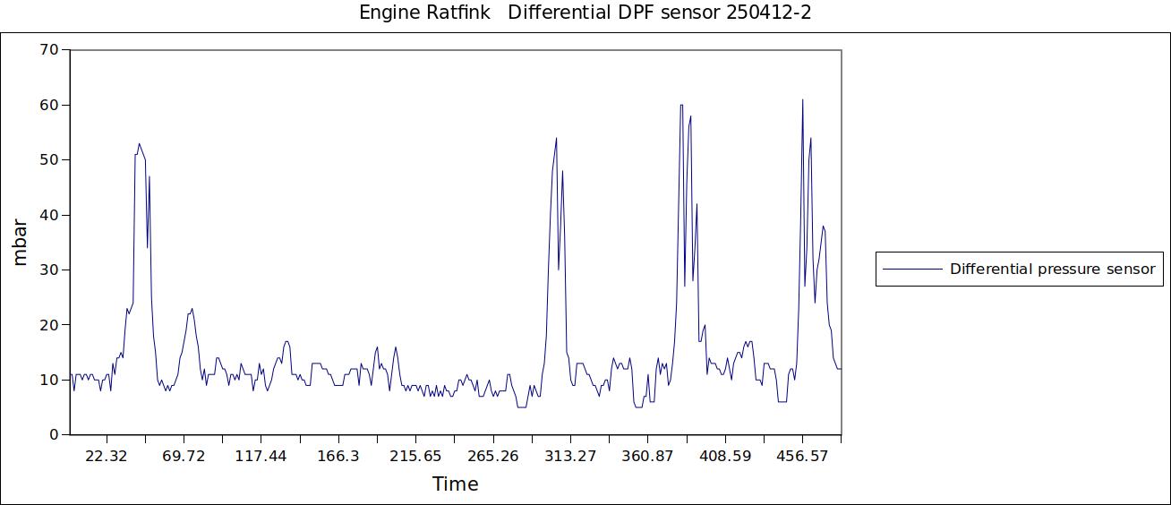

Here is my data from today, cold start, hot run 1 & hot run 2. Can't believe it I just missed a regen as well! This is my 2018 build date 130 Ducato on V24 software.

I found this on YouTube,I found it interesting to understand what the egr is achieving, and the LP circuit reducing 02 and increased temperature in cylinder to reduce nox .. and how when its not working correctly it's going to cause issues which for some of us we have !.
@Ratfink you just about caught the regen but not fully, such is.
Have you any symtoms?
Is exhaust pipe clean or sooty?
At least we know regen gets to at least 635C with version 24
The LPegr valve is working as expected but temperatures are low until we get to set 3.
The turbo boost jumps about being lower or higher than desired. pherhaps a MAP that needs cleaning maybe not a problem at all.
The alternative is a Turbo solenoid that is slightly tired but not obviously dead.
Could all be acceptable if no obvious problems in use.
The injectors, HPEGR and O2 graphs OK

A big thank you to @theoneandonly for this analysis, I do not have any symptoms and the exhaust is very clean. Once I have done the cam belt I am getting a service and hopefully V32 software to keep it that way. When I check my mates van I think it will be a very different story.
