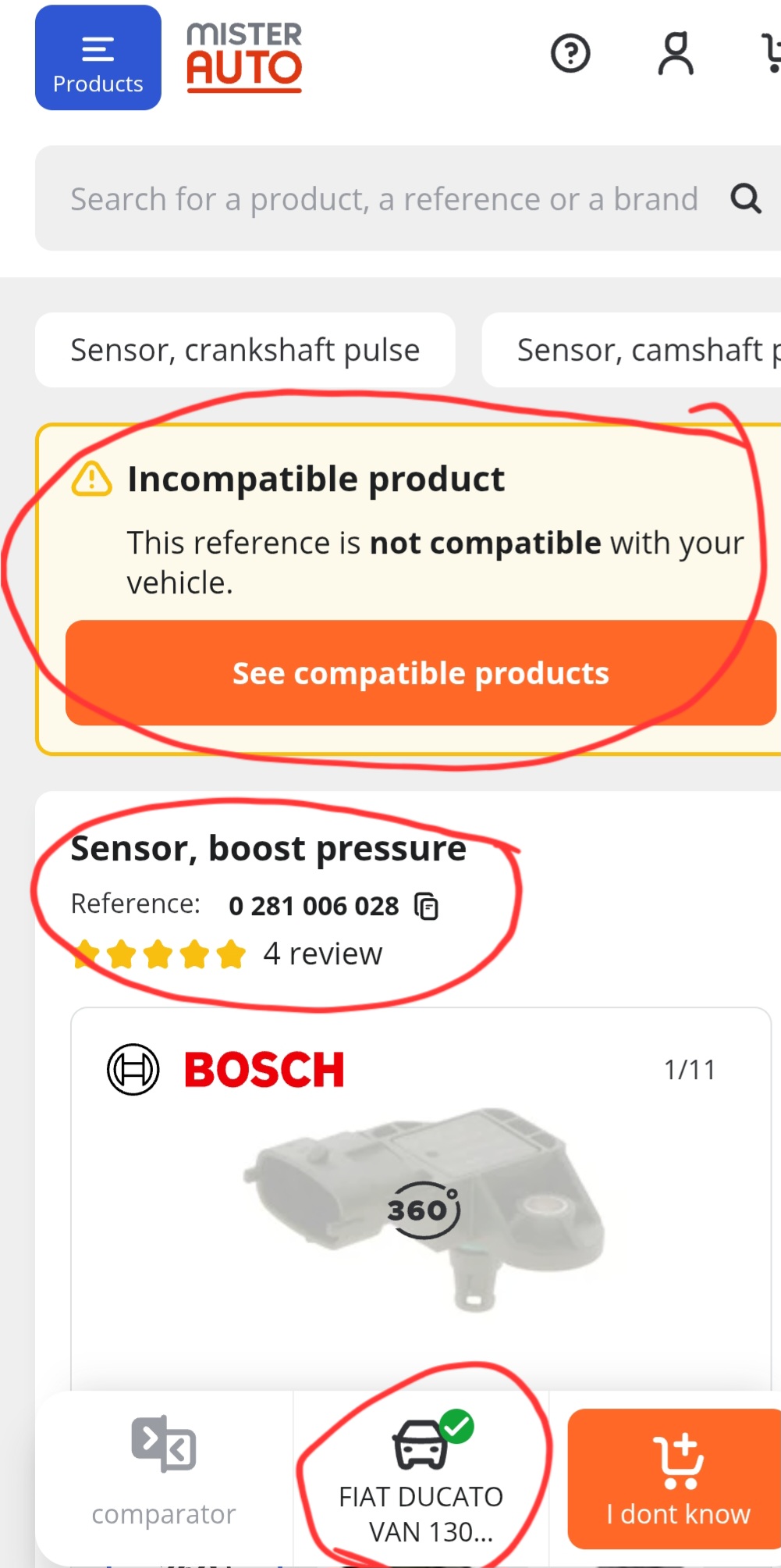

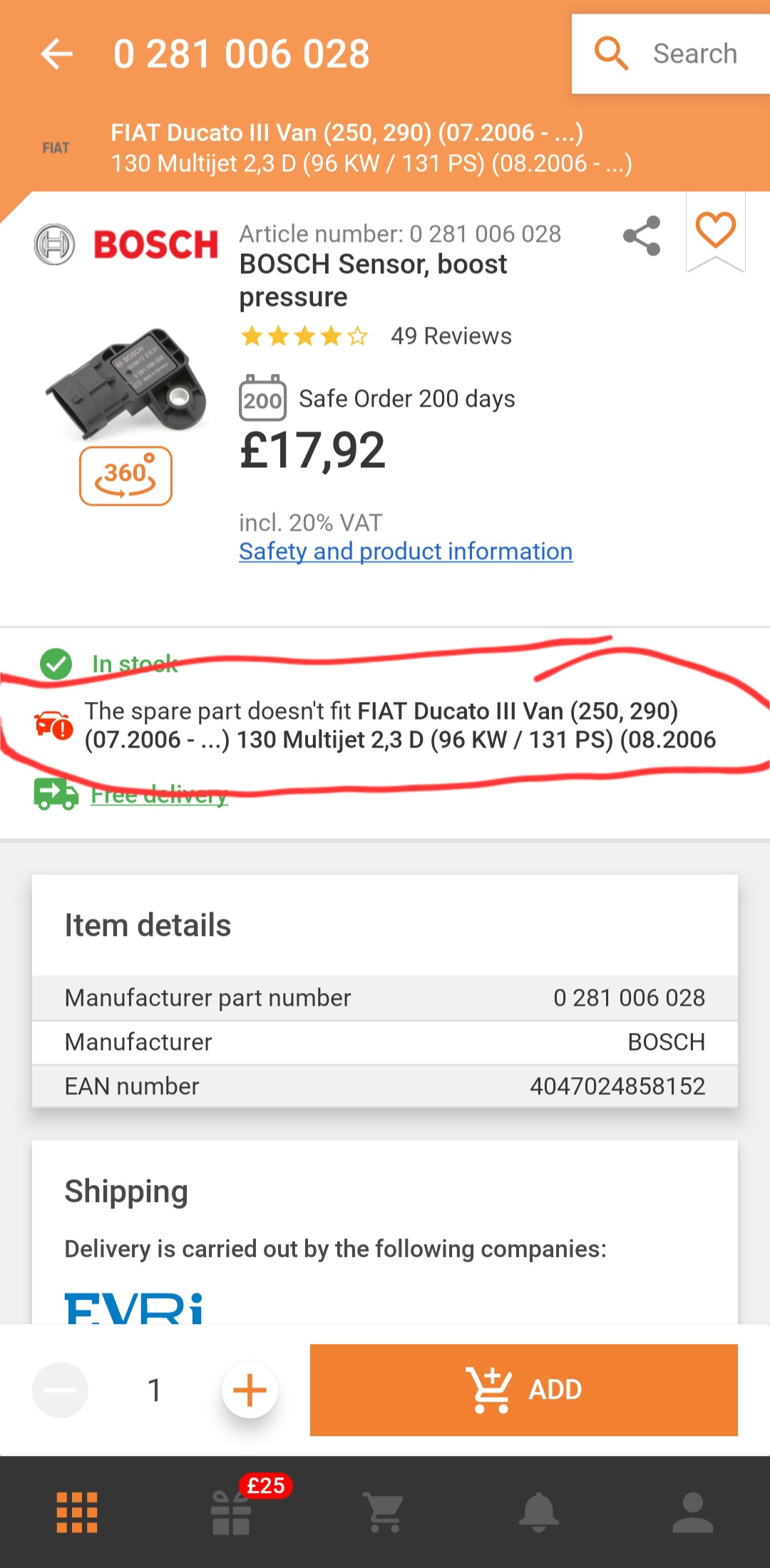

Can you tell me, which numbers are definitely wrong and which are correct?
0281006028 is the wrong, factory-fitted one. I think the proper one has been superceded.

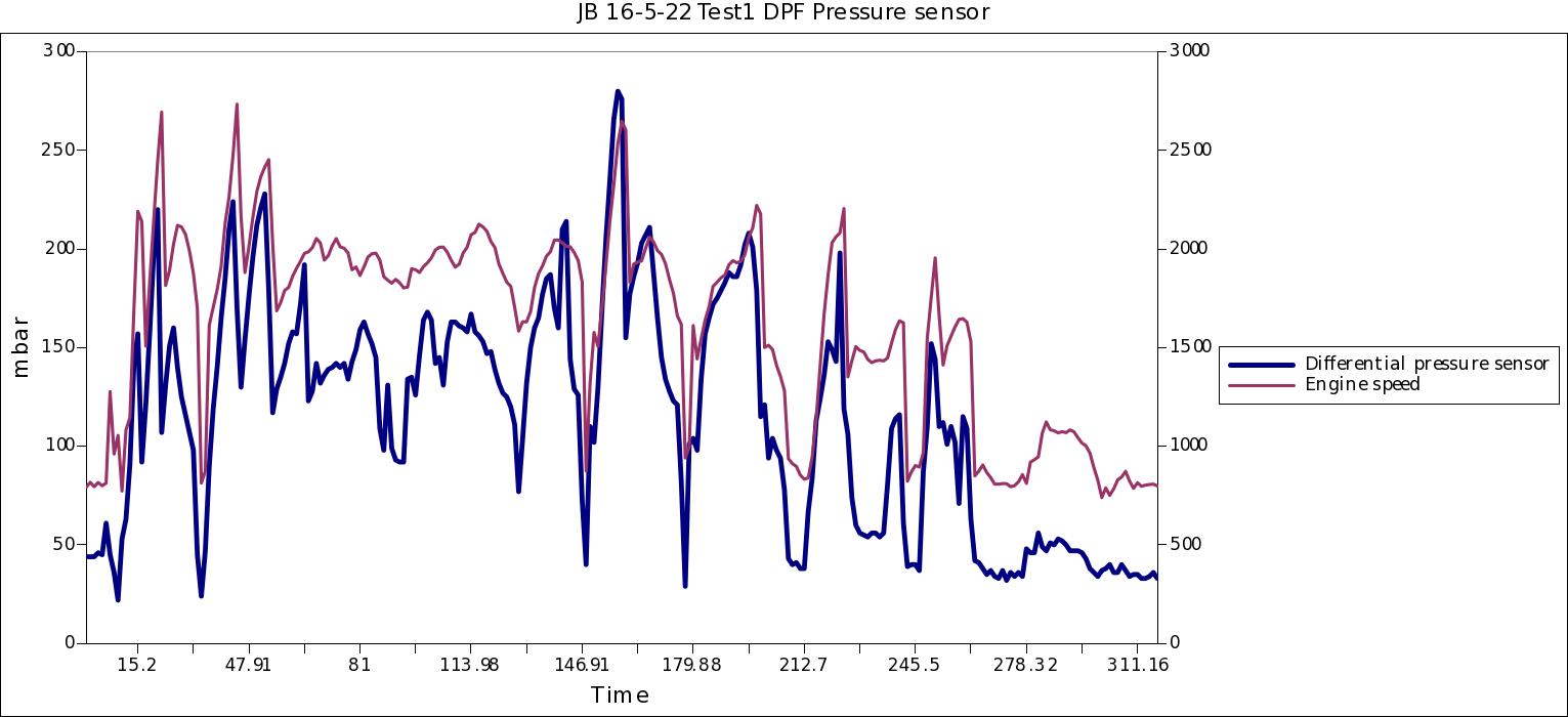

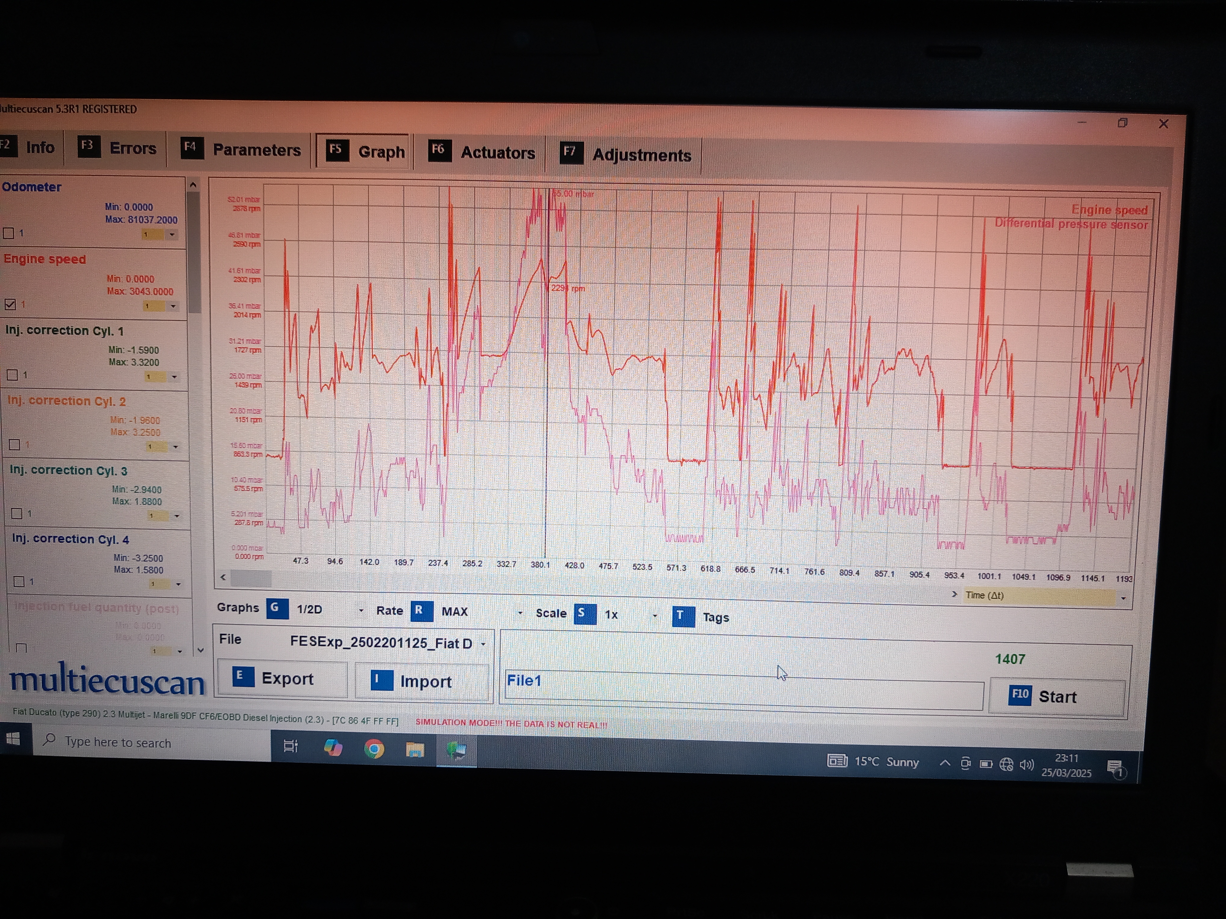

Here's a photo of my differential pressure v engine speed. What, if anything, does it tell me? The particulate filter clogging runs from 90% at the beginning of the run to 96% at the end.

@Jiwawa Can you please confirm what is the basis of you stating that "0281006028 is the wrong, factory-fitted one"?
From information I've gleaned on this thread (that this Bosch part was not released for our engines) and also my own investigation.

The lefthand side column shows injector correction values and the injector value durring regen. I cant see reference to the differential pressure.
I will order a new sensor in the Fiat. Cost 100 euro. I don't see any other way to check it.
@theoneandonly the injector correction values were deselected. The pink line on the graph shows differential pressure sensor, the red line the rpm.

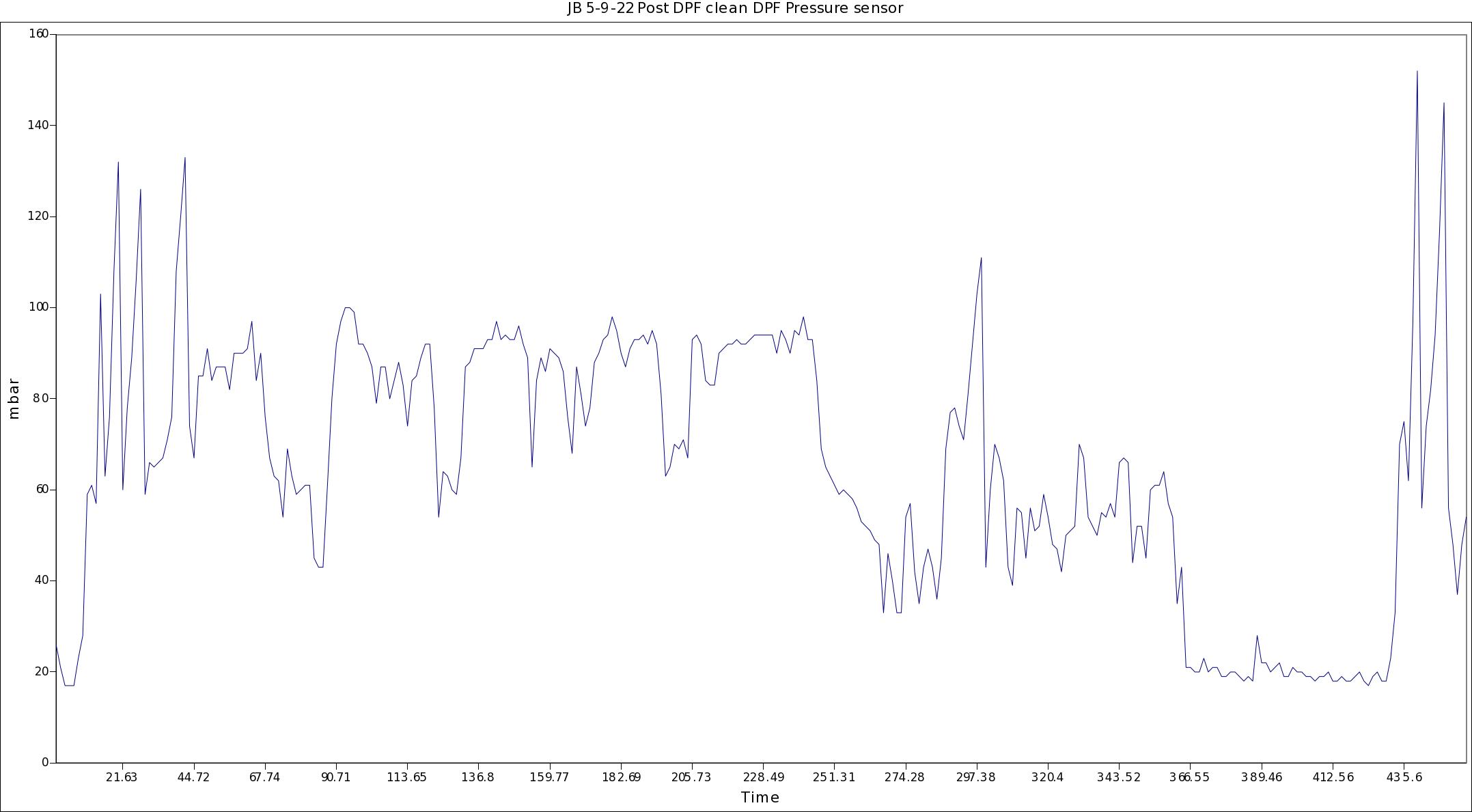

The pressure varies between 4 and 50 mbar which is typical for these Ducatos. Only if it goes above 100 do i get concerned about dpf clogging/ regen. There is thread about an Irish guy JB with dpf blocking issues due to injector problems (incorrectly named)
Unfortunately cant remember username
