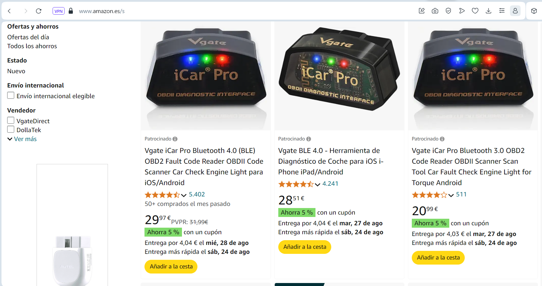

aT least exhaust is clean as yet no P0401 so not all doom and gloom. If you have an android phone or tablet the simplest thing would be to buy a Vgate ICAR PRO bT4 OBD DONGLE AND DOWNLOAD Alfaobd the demo version free. you should then be able to check your software version and read any codes. the full version price is currently $50. Buy dongle from Amazon.es and deliver to one of their postboxes (easy im told but never done it. IF YOU GET SORTED bloody capitals with alfao obd in spain let me know and i will advise how to get some live data. I find Multiecuscan easier to use but have alfaobd capability in van at all times. If you happen to have a windows laptop to hand we can sort that as well.

Thanks , had not thought of the Amazon route and pickup points spent ~30 ao minutes checking it out but all have longer delivery times (will be home by then hopefully) does anyone know what type of physical shops that possibly stock these in either France or Spain? I have Torq Pro on my Android guess that's ok to read codes and reset maybe not get software versions , I'll go the multiecuscan route once home . Had hoped to not go down the route of having to diagnose the camper but it was not to be.

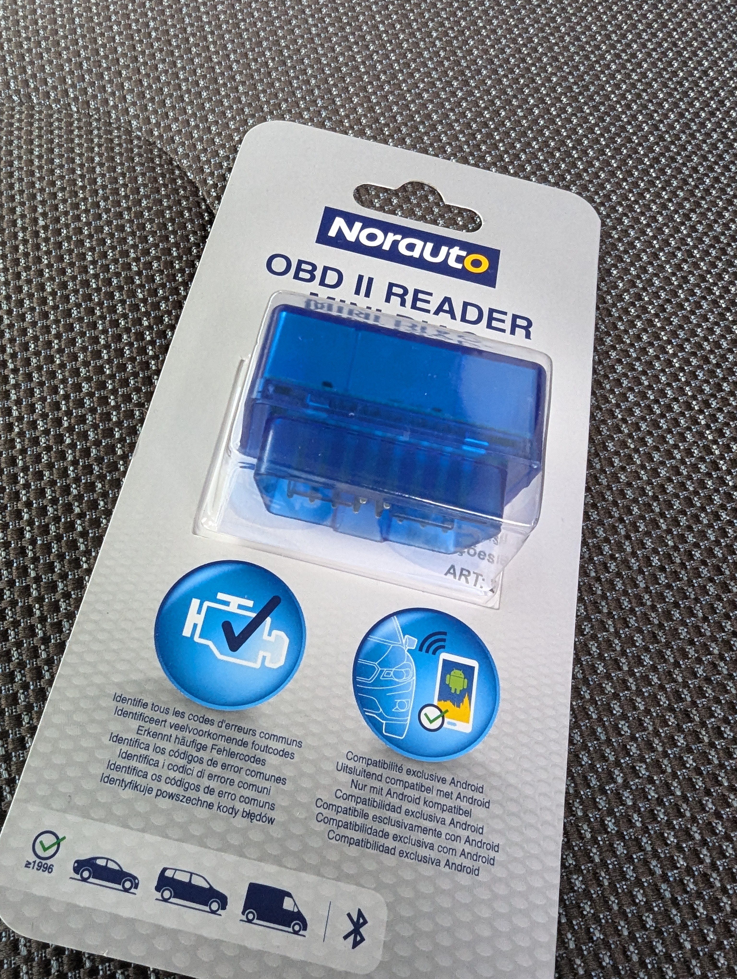

Found what I was looking for yesterday! Funny thing is that I was in that shop Franchise first time I got it reset and they didn't know what I was talking about! Have reset code and pelted on the motorway and no new code gone are the ups and down windy roads and mostly motorway from here. Is Torq app for Android any good to collect data to see what might be up? Seem to have access to all the sensors and can log with it.

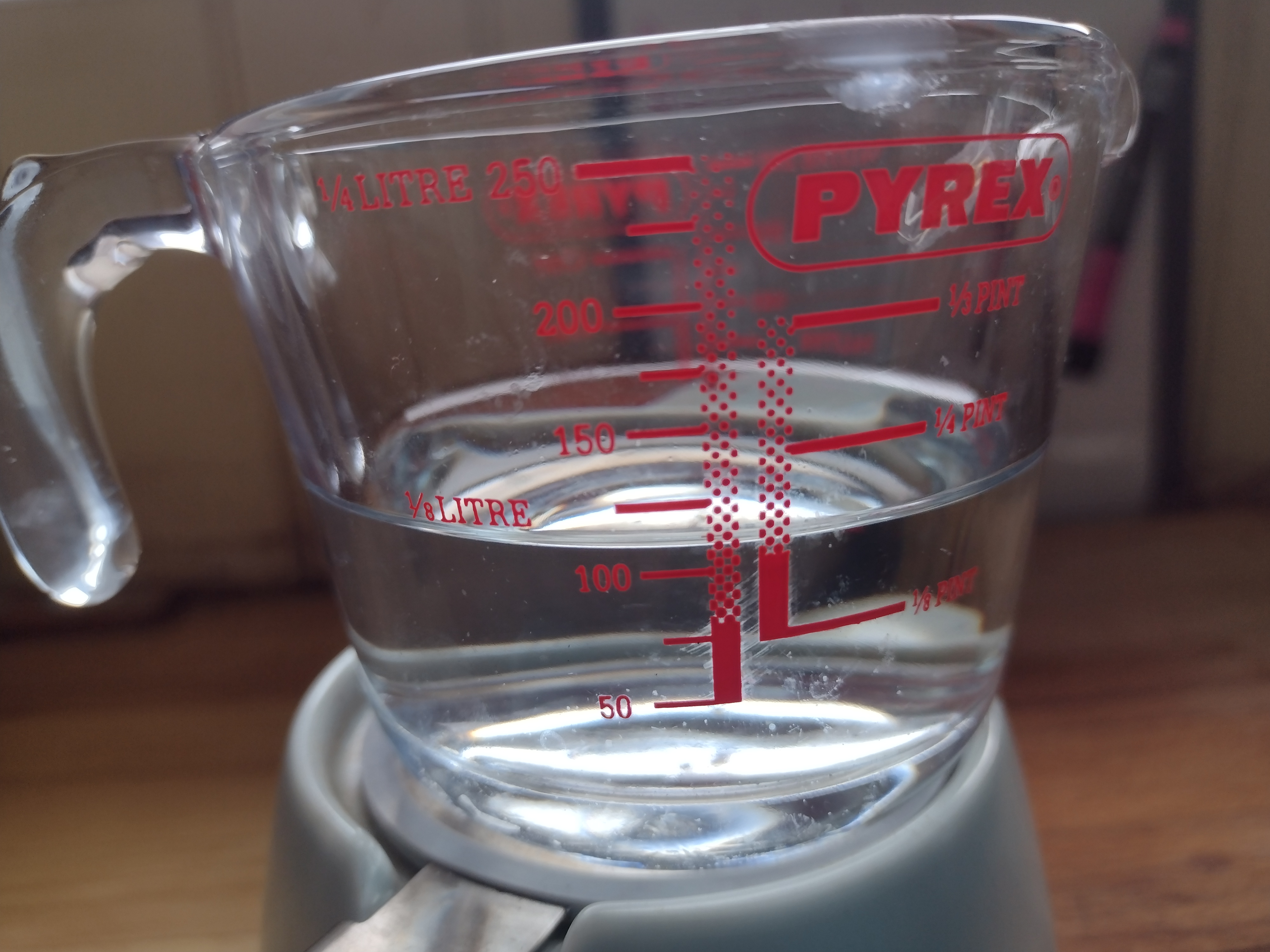

Just to get one of you thinking.
I've filled up my spare LP cooler with water. I used a rubber glove secured with rubber band to stopper the bottom end. Then holding horizontal as it would be installed, the Wife removed the glove and the excess water drained away thus leaving the pool of water in the lower zone of the tank.
Then drained out this 'pool of water' being circa 110 ml.
So if insitu cleaning were possible this is what would remain in the tank - to need removal - but how?
Evapouration!
With mean cooler temp even above 80C it would all evapourate in time.
