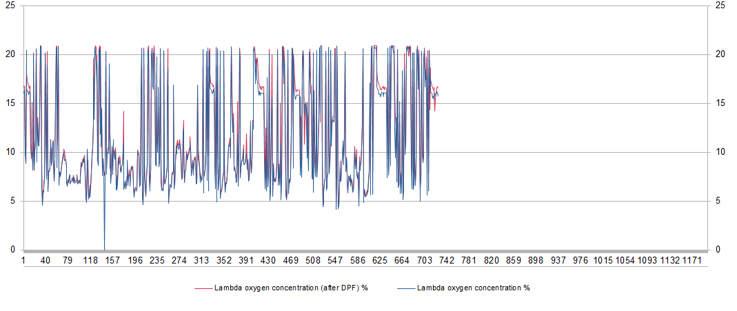

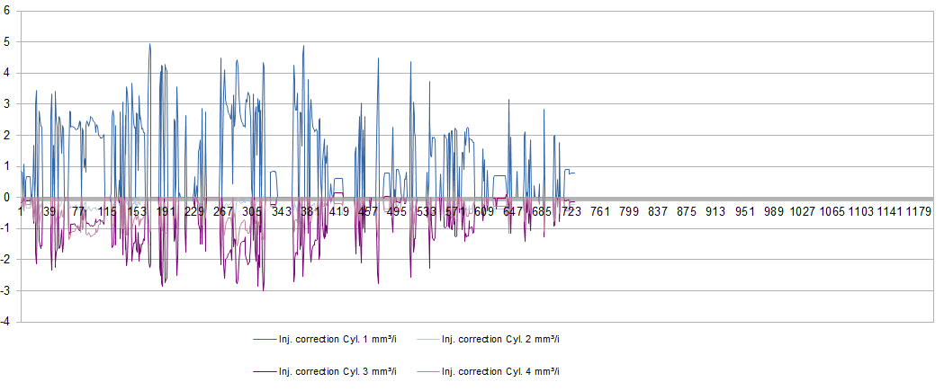

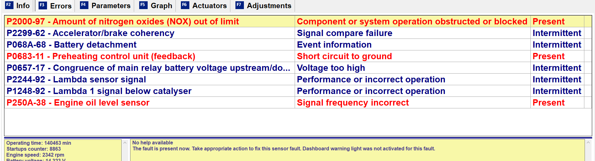

Hi All Finally bought a van to convert, its a 2018 manual, we took a chance on buying one from the auctions on the results of a exhaust pipe wipe, our reasoning was the wipe looked OK and if the worst came to the worst we could sell it on.
Below is the picture that we used to determine weather to buy or not. We picked the van up filled up with 40litres of fuel and a double dose of Archoil fuel treatment and did a 3/1/2 hour run from South Wales to Manchester and the exhaust pipe is now completely clean.
We have done a run with multiecuscan this morning and I will ask @theoneandonly if he has time to have a look at them, they seem OK from my limited understanding

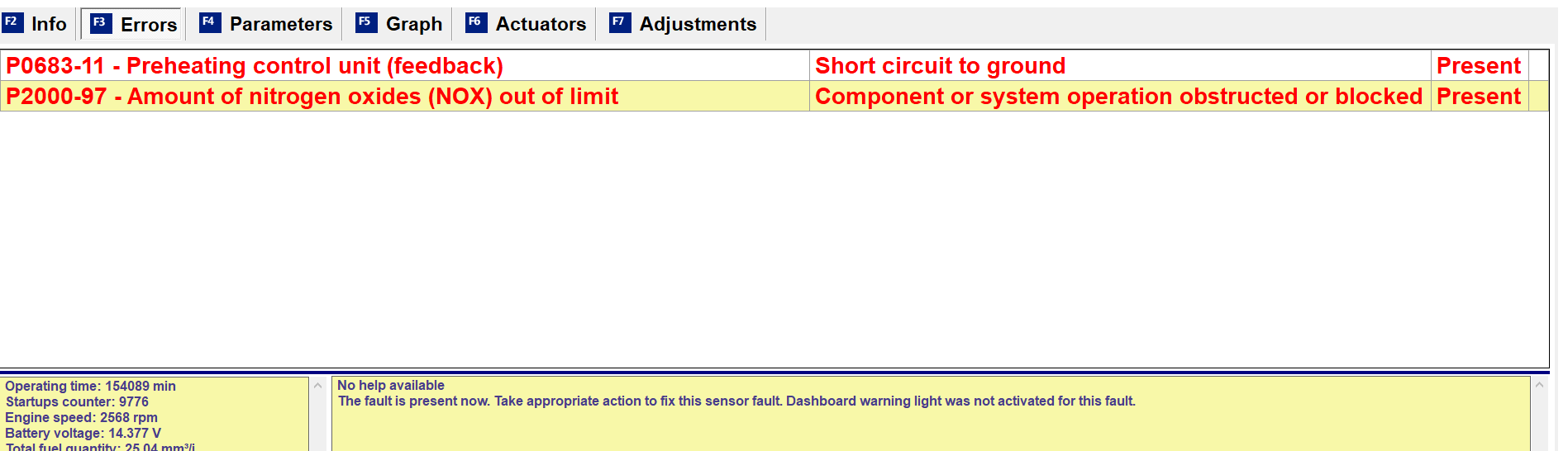

The Version is 28, even though the graphs look OK to me there are errors and I would appreciate any help in determining what the codes mean and what to do to eradicate them?
Thanks one an all for the valuable info on the forum and stand by for further requests for help.
Paul

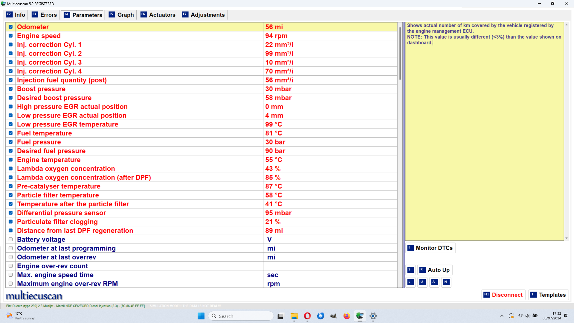

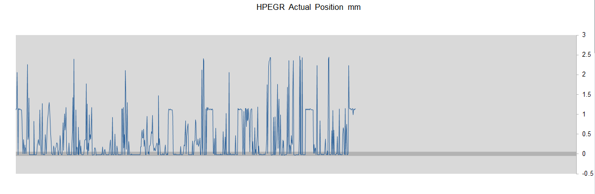

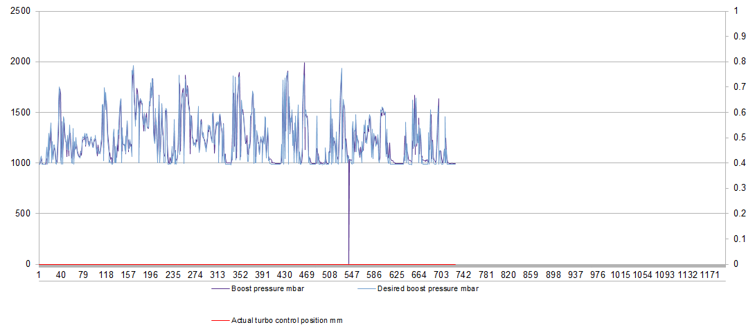

Please do a freeze frame of each error (click on each error in turn )then do a screen shot. Once you have those safely stored then clear the errors. Then do a run using these parameters (template 4 (save as template 4 so it can easily be repeated. All info on how is in various guides. then post the csv file. Note run engine for at least 10 mins to get engine warm then 20 min blast. record all data. check the oil level with the dipstick, halfway is prefferable.
Please do a freeze frame of each error (click on each error in turn )then do a screen shot. Once you have those safely stored then clear the errors. Then do a run using these parameters (template 4 (save as template 4 so it can easily be repeated. All info on how is in various guides. then post the csv file. Note run engine for at least 10 mins to get engine warm then 20 min blast. record all data. check the oil level with the dipstick, halfway is prefferable.View attachment 447739
Hi thanks for that I have already sent a csv file to your home email address earlier today, I will screenshot and clear the errors, do the run again and resend the csv file to your home email or would you prefer I post on here?
Post here and others have the oppourtunity to analise themselves or direct to me and i post results here or you are daft enough to limmit yourself to my advice alone.
I cleared error codes and did a 20 min test drive with template 4 checked oil dipstick after 10 mins.
Attached is the csv file, the new error codes and the graphs that I created using LibreOffice as I could not get @theoneandonly graphs to run on excel on my PC's
Any help and insights gratefully received.
Paul
Oil level check was it about 10mm above the shaped area on the dipstick which is roughly the level before I set off
First of all new errors codes
Graphs
