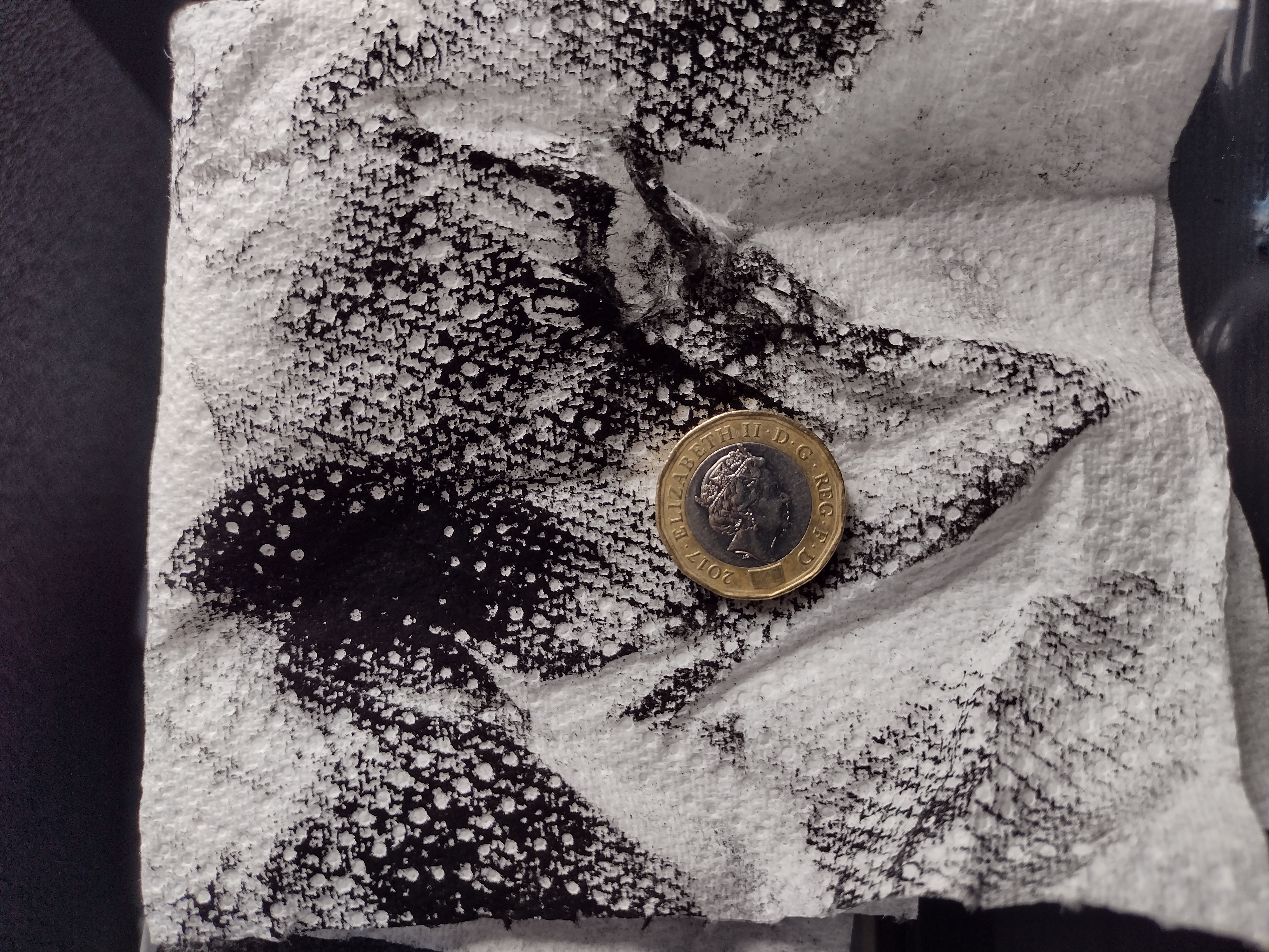

I've been asked for a photo of an exhaust wipe, I've taken this today, it's been months ago that I wiped it last time so I'll do another when we get home.
The £1 coin is for scale.
For any newbie; I started this entire 50 page thread, I had my cooler changed circa 2 years back. The soot indicates a cracked DPF as in reality it should be spotless clean.
Thanks for photo , interesting as I'm wiping exhaust pipe each time so I'm not getting a long term build up , but as you are still surviving with no issues, I'm more confident that I'm not going to have any more immediate problems either. I did notice that as the premium diesel with a treatment additive worked through combustion cycle my soot level has reduced slightly.
