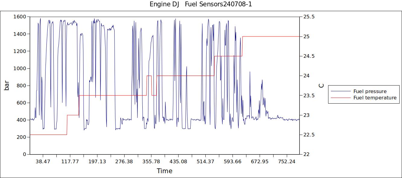

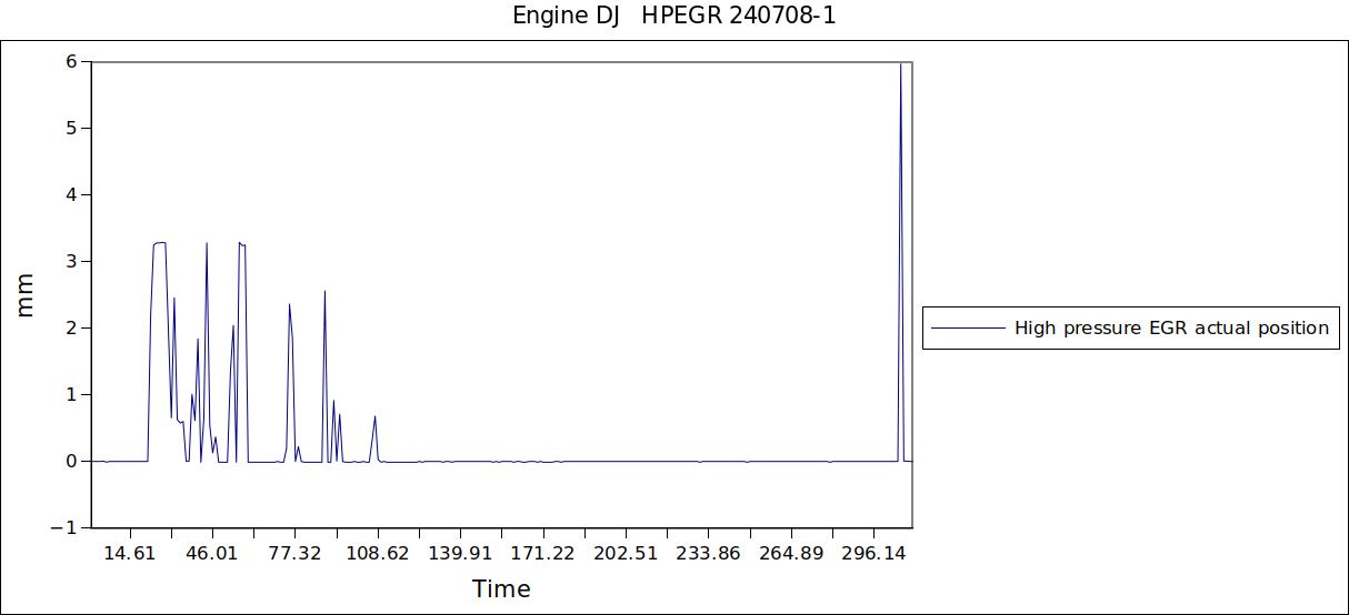

Attached two files - 2407081424 is a 20 minute run, beginning from cold start up, warming up and a 100kph section. 2407081440 is a 9 minute run, fully warmed up, with a run at 100kph to a roundabout with a return run of 100kph. Both begin and end with vehicle at a standstill. Template 4. The vehicle is a 2018 Adria 600SP that I have owned since new. Well maintained (by me) and running early SW on both ECM and TCM. (ECM SW Version 24). Comfortmatic Transmission. 150HP engine. Av distance between last regen: 675km. Distance from last regen: 187 km. Total regens: 51. Oil degradation: 90.1%. Nil overrev or missed or dubious regens - all regens normal. Wipe of exhaust after completion of test run included.

Thanks, and yes it does look like the engine is performing well. Which leaves me in a quandary. Do I just continue on and stick with the existing SW under the banner of "if it isn't broken, don't try and fix it", or do I look upon it as: so far I have dodged a bullet that some time soon may be coming my way, and rush to the nearest FIAT PRO workshop and get the SW of both engine and comfortmatic updated to the current software? The point that really concerns me is the wording in the SW V32 Bulletin (FCA Service News10 023.10) under the heading of Technical Cause: Software calibration. This does very strongly suggest the faults addressed in that bulletin were all caused by the then current installed SW. I have had no joy from any FIAT PRO Service desk, nor local FIAT Head Office as to what this SW V32 does. Does anyone have any idea I wonder? In all the Template 4 scans you have observed have you been able to see if there is any marked differences in scan results between the various SW versions? From the two files I supplied I noticed that there may be some sort of correlation between the timing of the Injector correction bursts and HP EGR Valve opening - but that is just from a two file sample.
