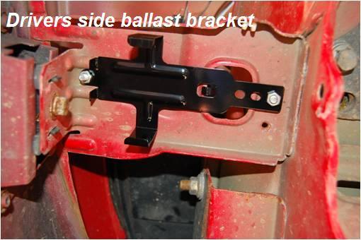

Step 3
Step 3 – Mount the ballast bracket (Passenger side)
Fit the Ballast mounting bracket underneath the bracket between the inner and outer wings. Offer up the bracket and mark the holes, drill 2 holes to accept the bolts but remember to paint the holes to prevent rusting! Use the nut’s/bolts provided in the kit to secure the bracket and make sure you fit spring washers to stop the nuts vibrating loose in the future.
