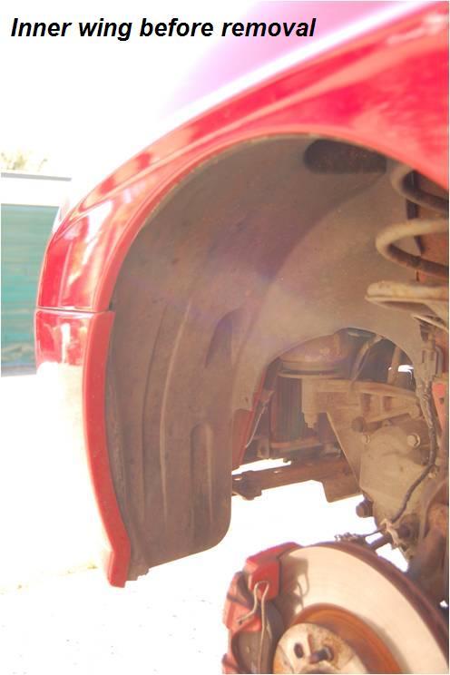

Before removal;

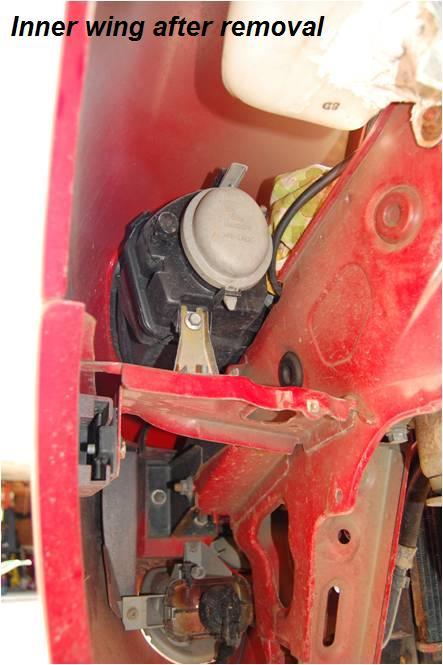

After removal;
Removing the inner wing trim can be a bit ‘fiddly’, you will need to use a bit of force to remove it, be careful not to scratch the wheel arch!
