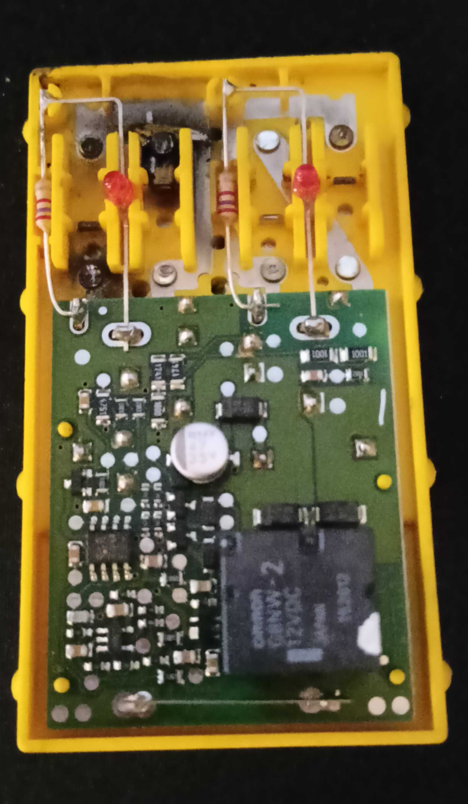

It decided to just go down and stay down. Hmmm. After some digging around I found a post from Varescrazy mentioning the earth cables on the drivers side door hinge, so that's first port of call. The motor is still working and it won't go up from either passenger or driver side so it seems to be lacking an earth. I also found the circuit board posted by Bernievarian, the worst case scenario is to put 12V through the pins with a spare battery, get the window back up and then disconnect it. Will see how it goes tomorrow, thankfully its not raining here tonight...
I had a feeling this was going to be a major problem. I got the door hinge connector off the drivers side and checked the wires, there's nothing out of place that I could see. I did the same on the passenger side and same there, nothing out of place. The switch and pins looks ok from the outside. There's no charring or bent wires, nothing at all...
So I connected pins 2 and 5 on the window switch to a spare battery and got the window up.

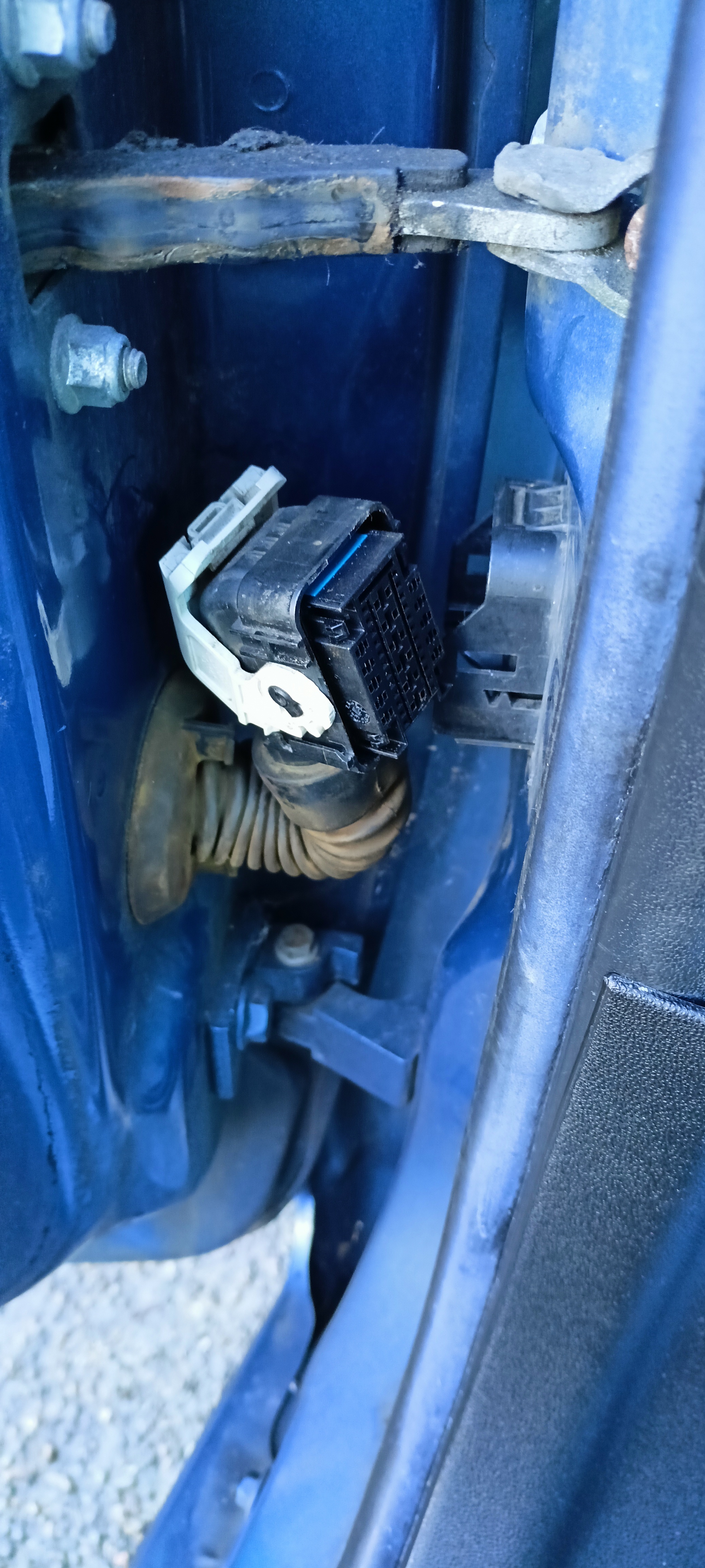

The problem I have now is that I can't get the passenger side wire connector back in, I really don't want to force it, but I've pressed hard over and over and it isn't interested in going back in. Does anyone have a trick?
Pic of problem.
I had a similar problem on my bravo (uses the same door connectors) one of the female pins wasn't seated correctly. I had to pull the rubber boot down, cut the cable tie holding all the wiring into the connector and there's a release clip up inside the connector. It all pops forward out of the housing after that and you can inspect the cable and connections from the rear. Reseat if necessary. As a side note my live feed to the window was corroded at the back so my window didn't work at all. It wasn't obvious from the front as the female side is below the surface of the connector. It blew the control unit in the regulator so had to replace that as well.
Pic of problem.
you shouldn't have to force it. you get it all lined up, the white part of the connector needs pulling back a little further to my eyes. Then you use the white clip as a lever which pulls the plug in as you close it up.
I've just had a go at levering it using the white clip, but its still resistant, i'll give that another go later and if its still not working take the cable tie off and have a look there.

You were right about the white clip! I had it back 80 degrees not realising it wanted exactly 90. So the central locking and speakers are working all normally again.
