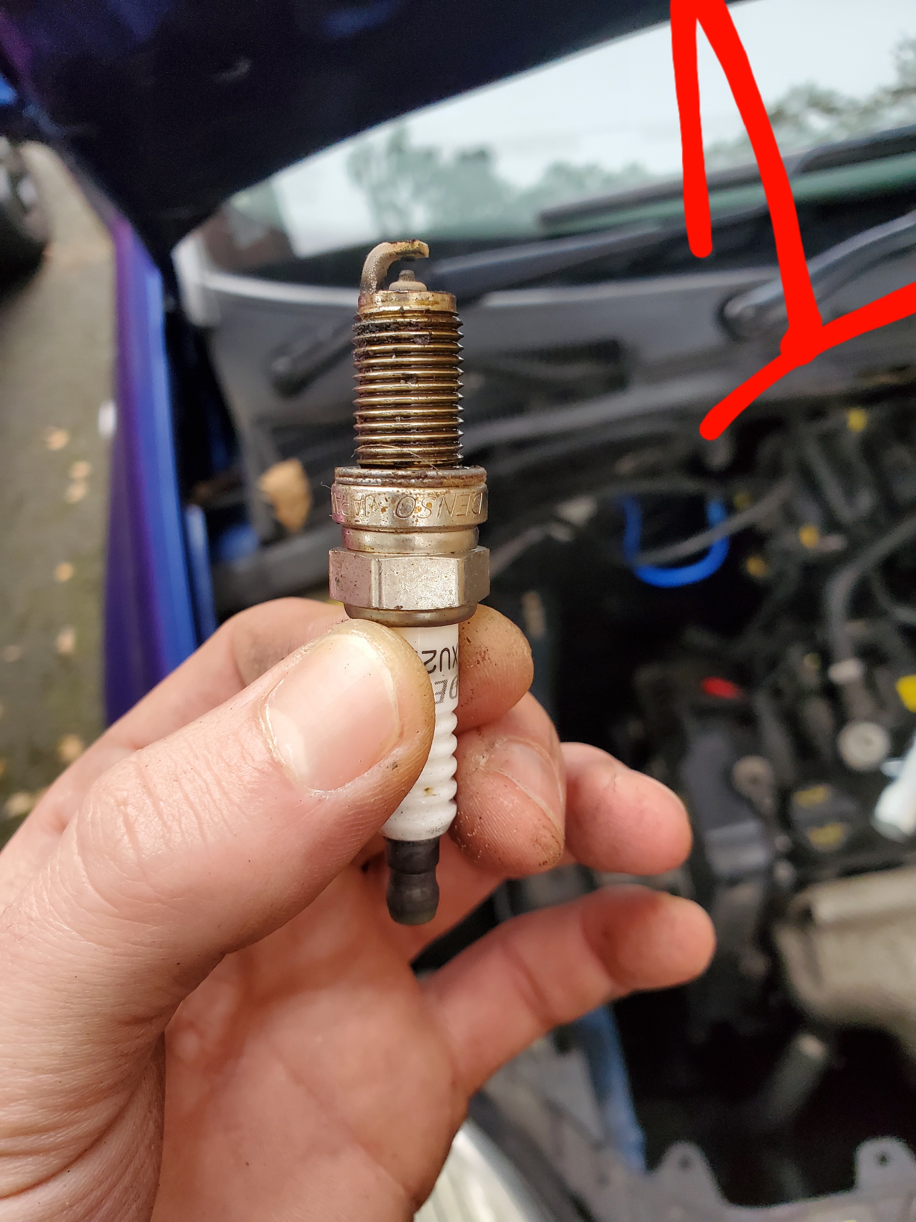

They start at 0.8 or 1 mm depending on brand and start to fail at around 1.7mm on the 1.2 engine, I guessing yours will be similar
Also a picture of the plugs in the order they come out of the cylinders sometimes is useful

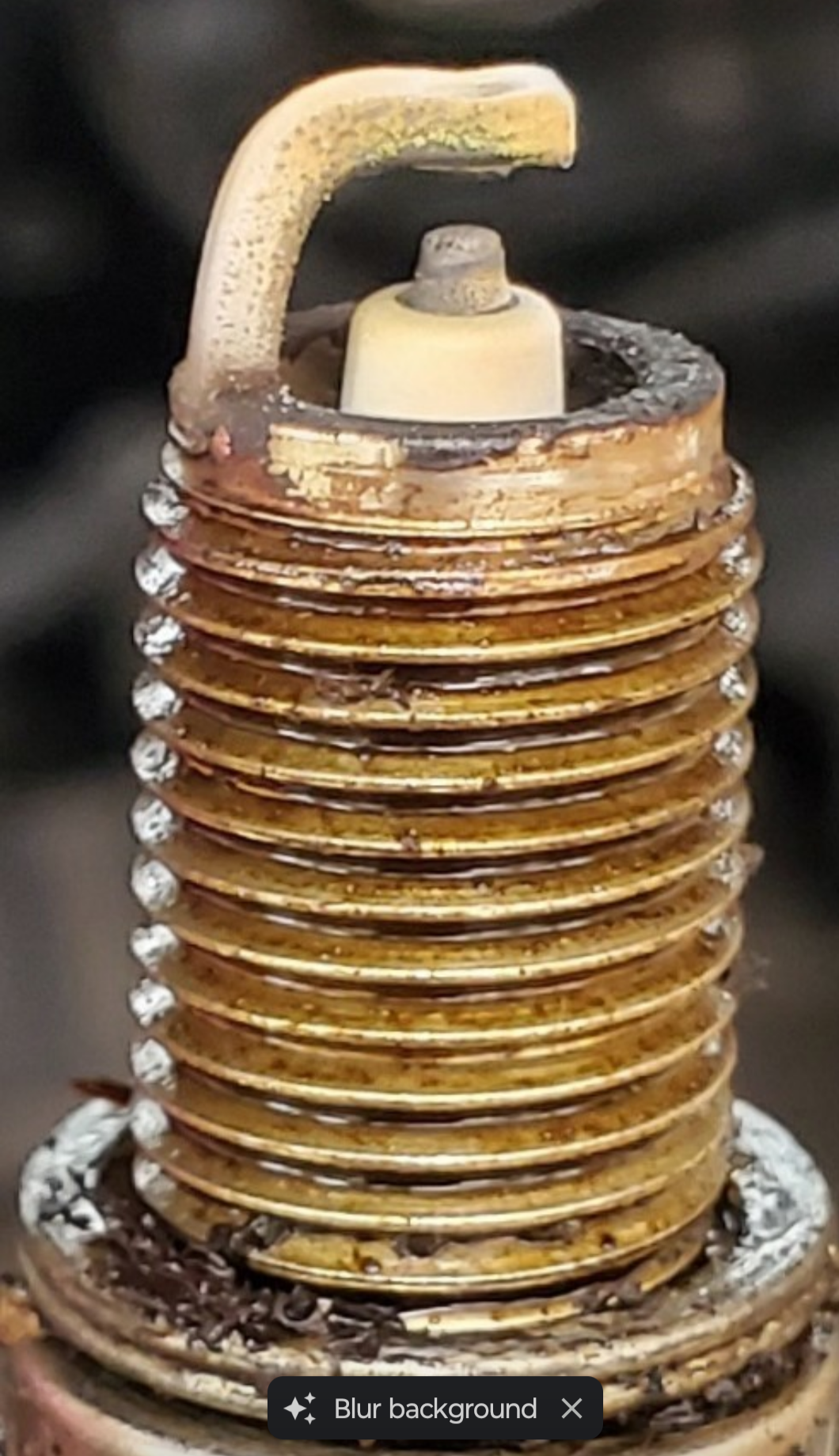

Good evening,today I have completed the works changed oil and filter,spark plugs and a cleaning to the throttle body. I have done some photos to spark plugs in order from number 1 to 4 (number 4 is the last near the throttle body).. from the photos on the 4 injector I see some dirt I'm not sure if it's oil coming from the airbox into the injector or is the injector leaking because the other 3 are very clean.

As @koalar says re the old spark plug gaps, we had a saying "looks like you could drive a bus through that gap";)
New plugs correctly gapped will definitely reduce misfire under load.
Also with gaps that wide, under damp conditions it can encourage shorting from ignition coils and leads causing other failures. The wider the gap , the higher the voltage that the coil has to provide to jump the gap.
We used to prove that using a Crypton Diagnostic Oscilloscope in the old days measuring kilovolts in the four lines of the individual cylinders, simply fitting a new set would drop the voltage required reading on scope, also resister type plugs require higher voltages , so when we raced karts we opted for non resister type spark plugs.:)
Although not a direct effect on oil consumption, I would expect car to run better with the new plugs.
Another thought or two, there is a deposit on the old plugs, which we used to link to early head gasket issues, but as we saw it more often it maybe due to modern fuels. A sort of greenish tinge.
Secondly the originally plugs appear to be showing signs of overheating/melting of the centre electrode, are they the correct heat grade/specification for your driving conditions?

I don't know if the spark plugs were the correct one for the car it's first time I'm changing them since I bought the car..I have put the NKG one they are indicated a fit for the car

I am a fan of NGK spark plugs since working for a Mazda Dealership in the 1970s and found them 100% reliable.

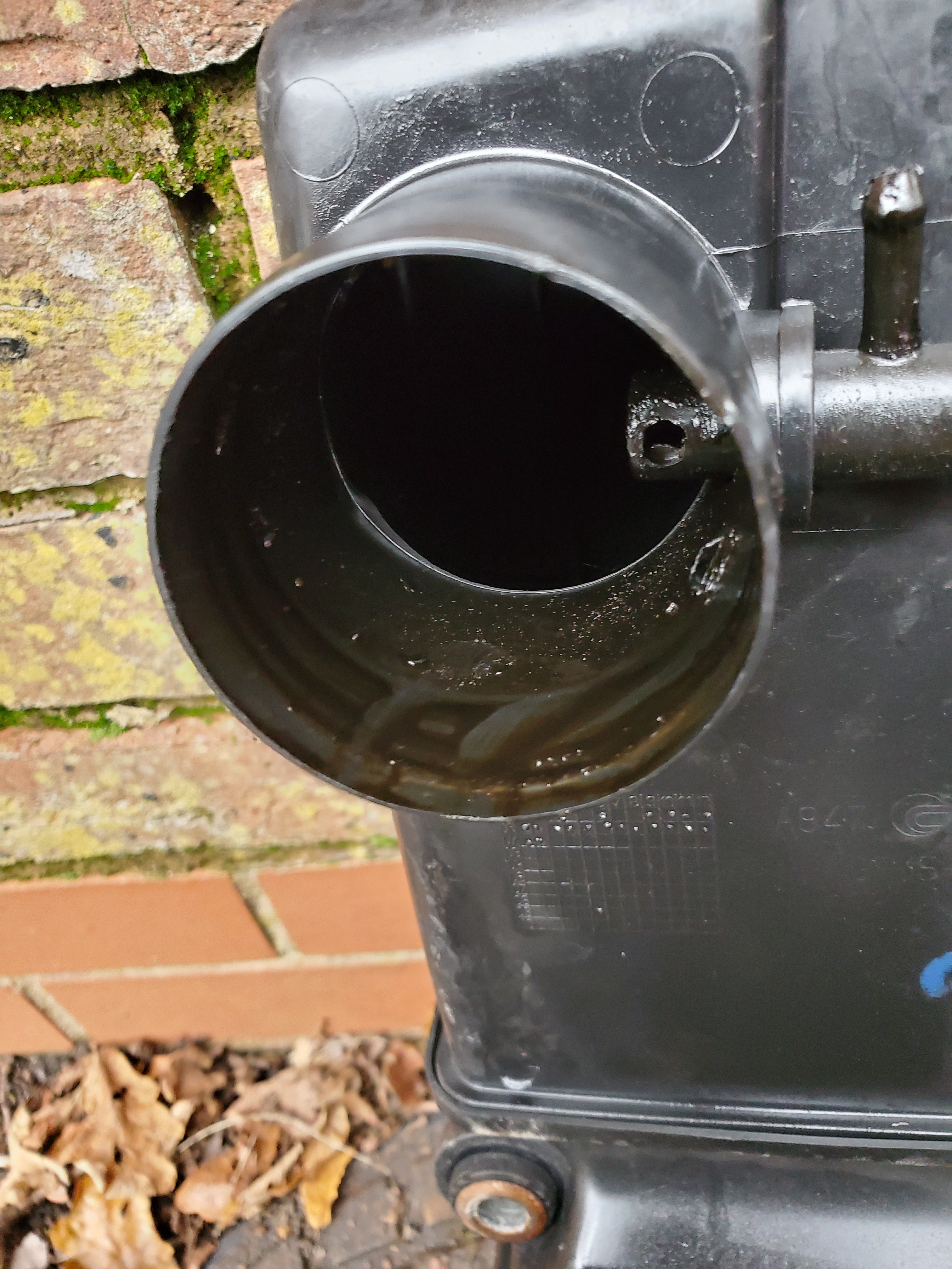

They seem ok..since a changed the oil and spark plugs the engine seems to run more smoothly..the only thing that I'm concerned is the oil in the air box on the photo attached 🤔

Oil consumption (blow-by) a bit too much. Do the pistons freeing procedure (pouring some engine flush into cylinders, then suck back - to avoid "poisoning" of the exhaust system). Stuck piston rings is a trademark of the FIRE family engines.
As for old sparkplugs condition: classic example of neglected/abused car! No preventive maintenance whatsoever.

Thank you for your advice 😀..I will keep an eye on the air box/throttle body for oil and if I see that after some time it will get dirty I will do this procedure 👍

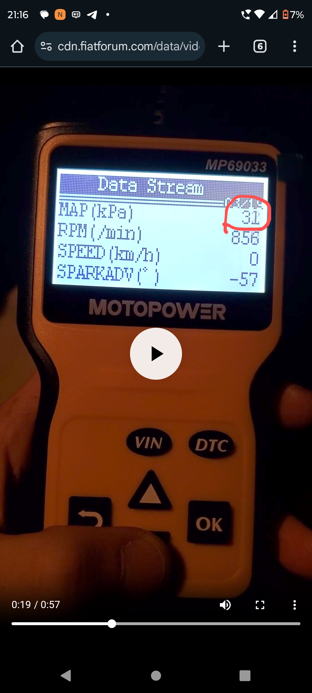

With the engine warm what are the long term fuel trims saying

Hello Everyone,I have just made some video of the data showing now that I have changed the spark plugs and cleaned the throttle body..I have made another video when from what I see I think its leaking small amounts of oil

That's great
There's an improvement in the idle, it was fluctuating much more
The post cat O2 is now giving a sensible reading if a little high but not enough to worry about
The LTFT is no longer pegged high
Thank you for your support 😀 can you please have a look on the last video I think its leaking small amounts of oil..its normal?
