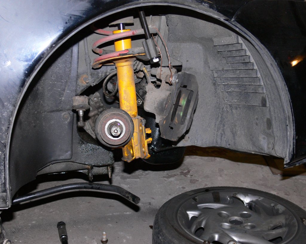

This week I've been on my push bike all week as I took the car off the road to do a wheel bearing. That went pear shaped and cost me a lower arm, but now the bearing is back in (£10 replaced at local garage, I already bought the bearing).
Here's the current status of that job :p Check out all my oil spray keeping things from rusting ;)

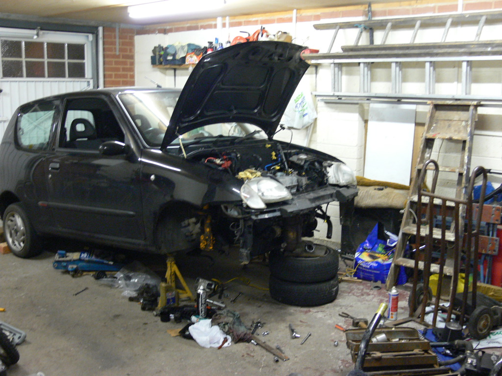

Here's the car at the moment.
Rear arms, driveshafts, hubs, bumper, rad, piping etc removed:
Heres the head gasket leak that occured twice after having the gasket go and head skimmed:

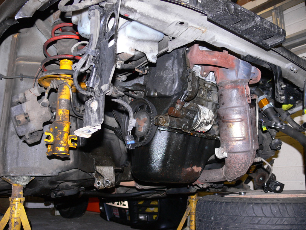

Staring to disconnect everything!:

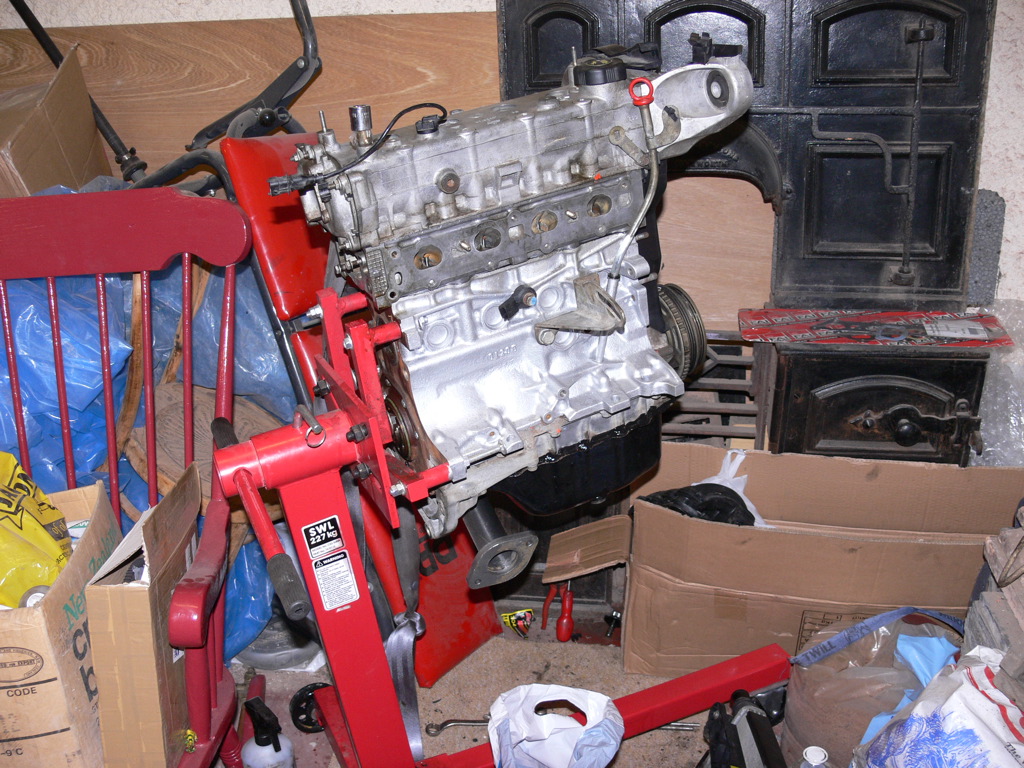

The enigne rebuilt, with the manifold attached, you can see where it comes out under the sump (y)
Took the sump out and resealed it the other day, all looked fine. Could still do with a bit of cleaning, but thats all cosmetic really!
On a dificulty scale compared to the 8v, I'd say at least double! Makes sense though really, theres pretty much two of everything lol
I think by tomorrow, I can drop it all down and out without the hoist, and hire one for the weekend to try and put the new one in.
I'm having a bas**d of a job getting the manifold of the flex section though, been whacking and hammering for an hour or so tonight, and still can't seperate it!!! Thinking about taking the whole exhaust and manifold down in one section :eek:
Coming along though!
Any questions or comments, just shout :)

It's had a good soak of penetrating oil, but didn't think about twisting with clamps.
Don't know what a water pump pliers are, but I guess two large mole grips may do the trick, although I'm still doubtfull as it did take a massive beating :) I think the flex may have flexed too much anyway, in which case i may end up cutting it off :eek:
Kristian
Yeah, I comes off the studs.... I should know, it fell on my chest as i was playing under it with no nuts attached and it slipped off the studs :eek: If it was anything heavier I wouldn't have risked it.
It can drop about 6 inch thanks to the flex. From there I tried twisting, and getting a long bar and mini sledge and trying to force it off.
I'll try grips and twisting but i guess its one of those c**p jobs that take loads of effort and time for very little reward :D

I think the best bet would be to drop the whole exhaust, Then you can work on it easier.
That's what i did. You can then use an old screwdriver to splay the joint open and reduce the surface tension. The problem might be that the clamp has put a groove in both parts of the exhaust and rust is a good bonding agent.
