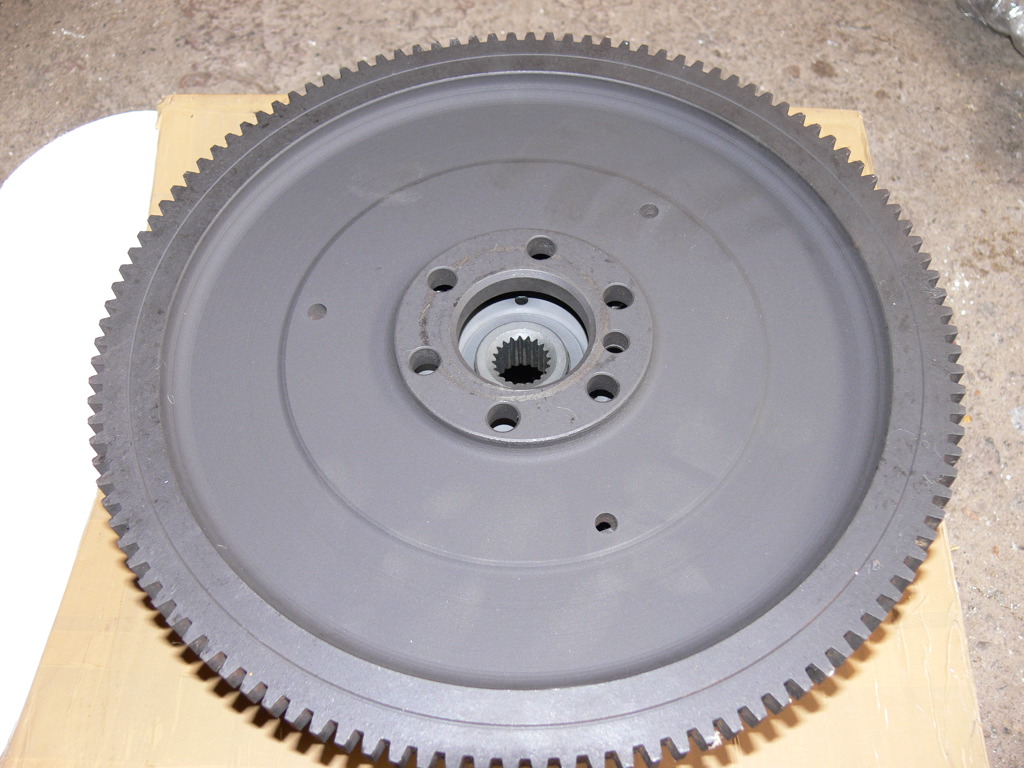

I had the fw back, lightened and balanced, he said a face regrind was pointless and just to clean the old crap of with wet and dry. I have sprayed it since I got it to prevent corrosion and make it look nice while its out of the engine.
Like a fool I forgot a before and after shot, and never weighed it either! doh!
Here it is anyway :)

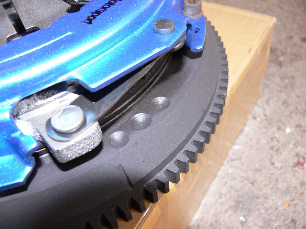

Not show in this shot but 5 springs vs 3 on OEM clutch:
A fair bit taken from the edge and the balancing marks:
Went a fair bit out the back as well:
Overall he said he took as much as he felt was safe to do so, so thats fine with me :)

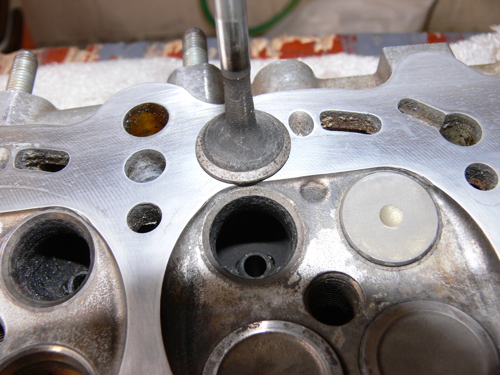

Slightly ground valve and seat, just to clean it up a bit, pleanty more still to do ;):

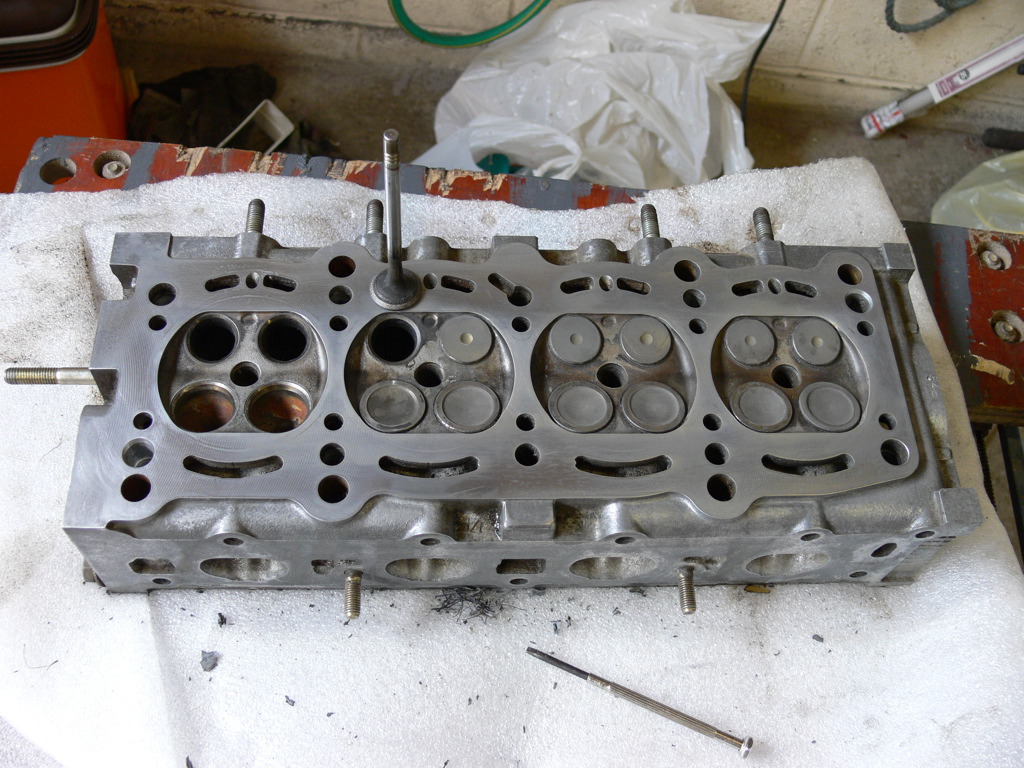

The underside of the head cleaned up a bit:

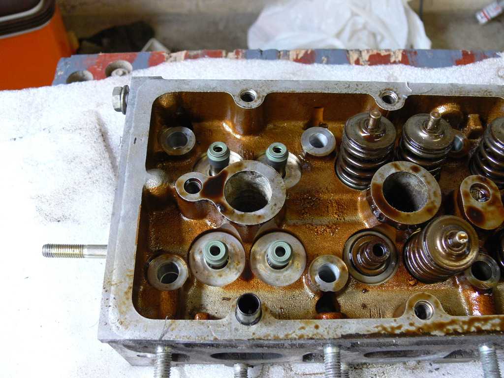

New seals going on:

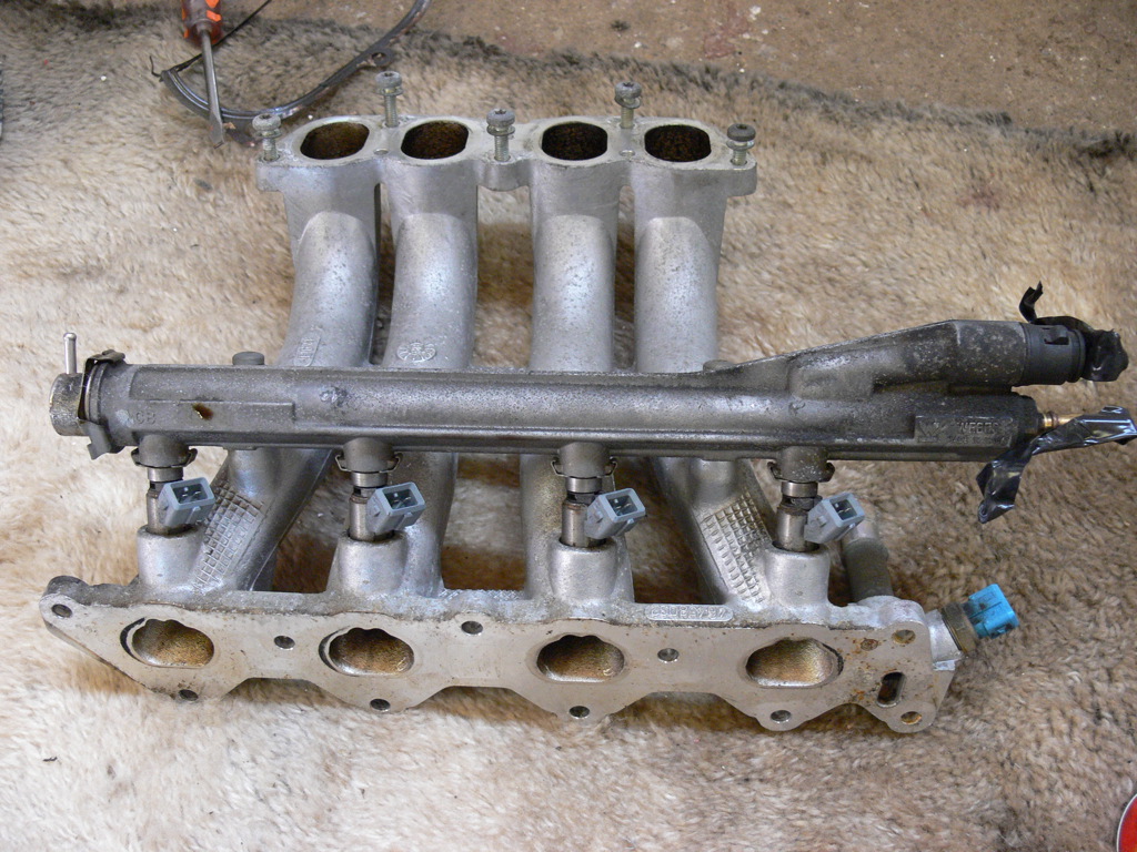

The mk1 fuel rail:
Apparently this is returnable, but I'm unsure which is the return at the moment, will have to compare it to the Sei one, and just blank of whichever is the return line. (y)

BTW good job on the flywheel, I can never remember what the original weight of the flywheel is! i think its roughly 7kg,that should be below 6 possibly.
When I weighed my flywheel it was 6.81 Kg and after lightening it weighed about 4.90 Kg. Looks like I may have had a bit more off than that but not much. Its not how much but from where you take the wieght off. The more you take from the outside the greater the effect becuase the more the turning moment is reduced. Although i remember another member weighing a flywheel and they said there one weighed 6.5 Kg so maybe theres some difference or just in-accurate scales.
6 valves reground/smoothed, only 10 to go :bang: not the most interesting thing in the world.....plus I made a mistake.....
The picture of the new seals above, are on fine, but I forgot to fit the spring seats, the seals are trashed when removed, so i have to go find/buy 4 more from somewhere (posted in classified (y))
I plan to have the other 10 done by tomorrow night, ready for the head going back on, this weekend :) as long as seals are done.
One thing I'm a little worried about is, my gf's father tried to help cleaning the head a bit, and wet+dry'd the gasket off, on the alloy head. I'm worried that the finish may be too smooth!? Anyone know if it will be to smooth, and other than skimming, how to achieve a good surface?
