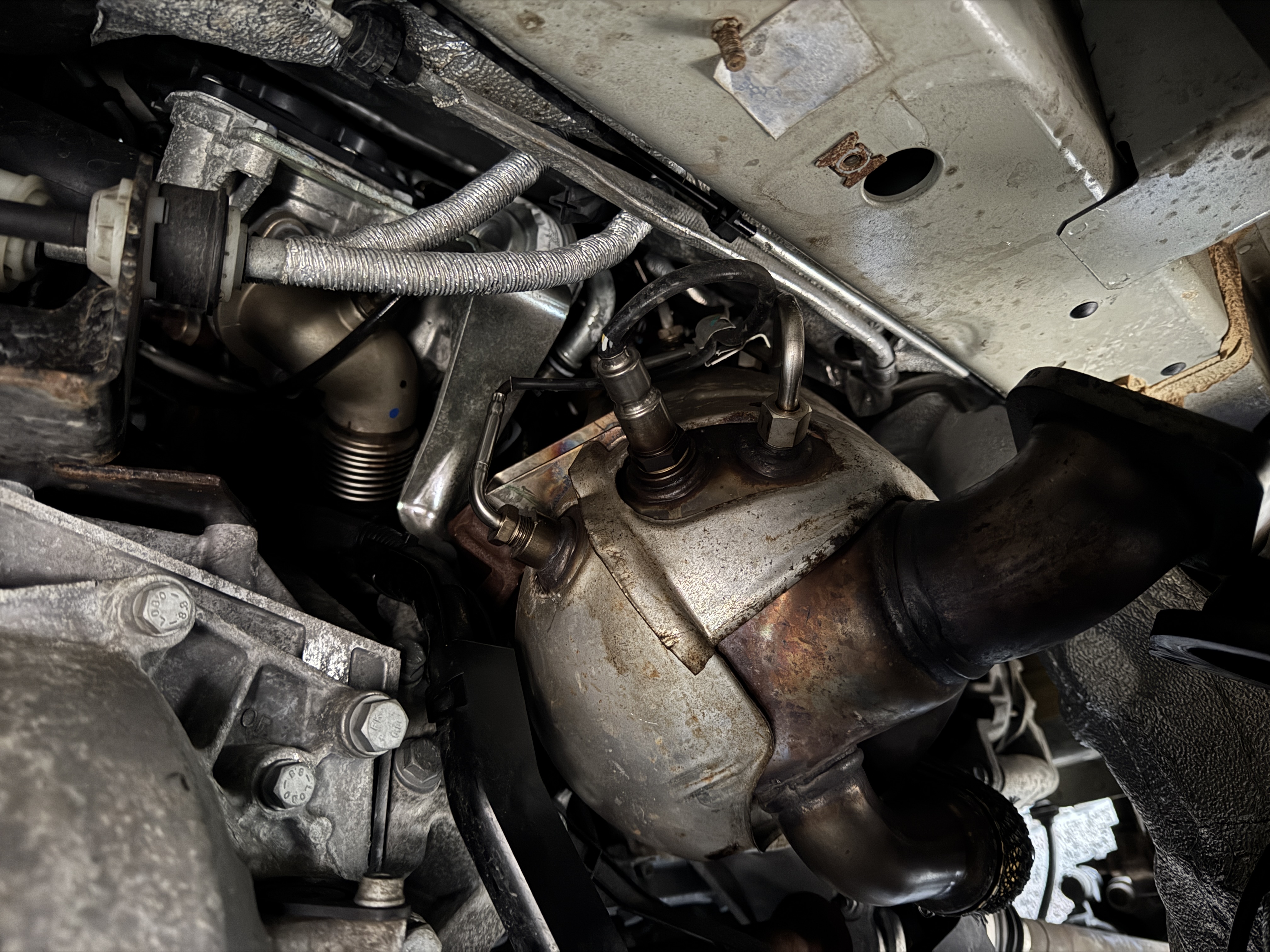

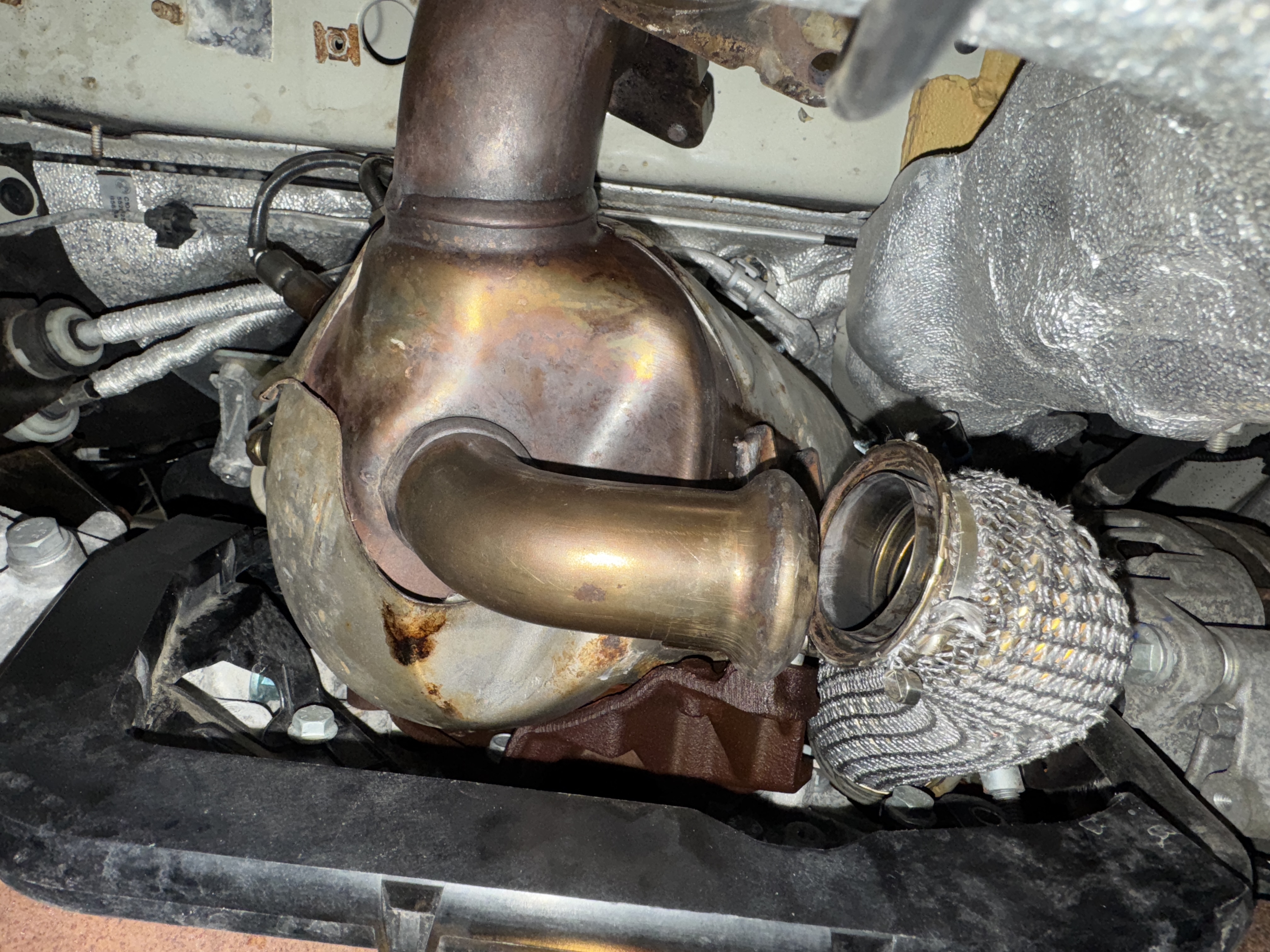

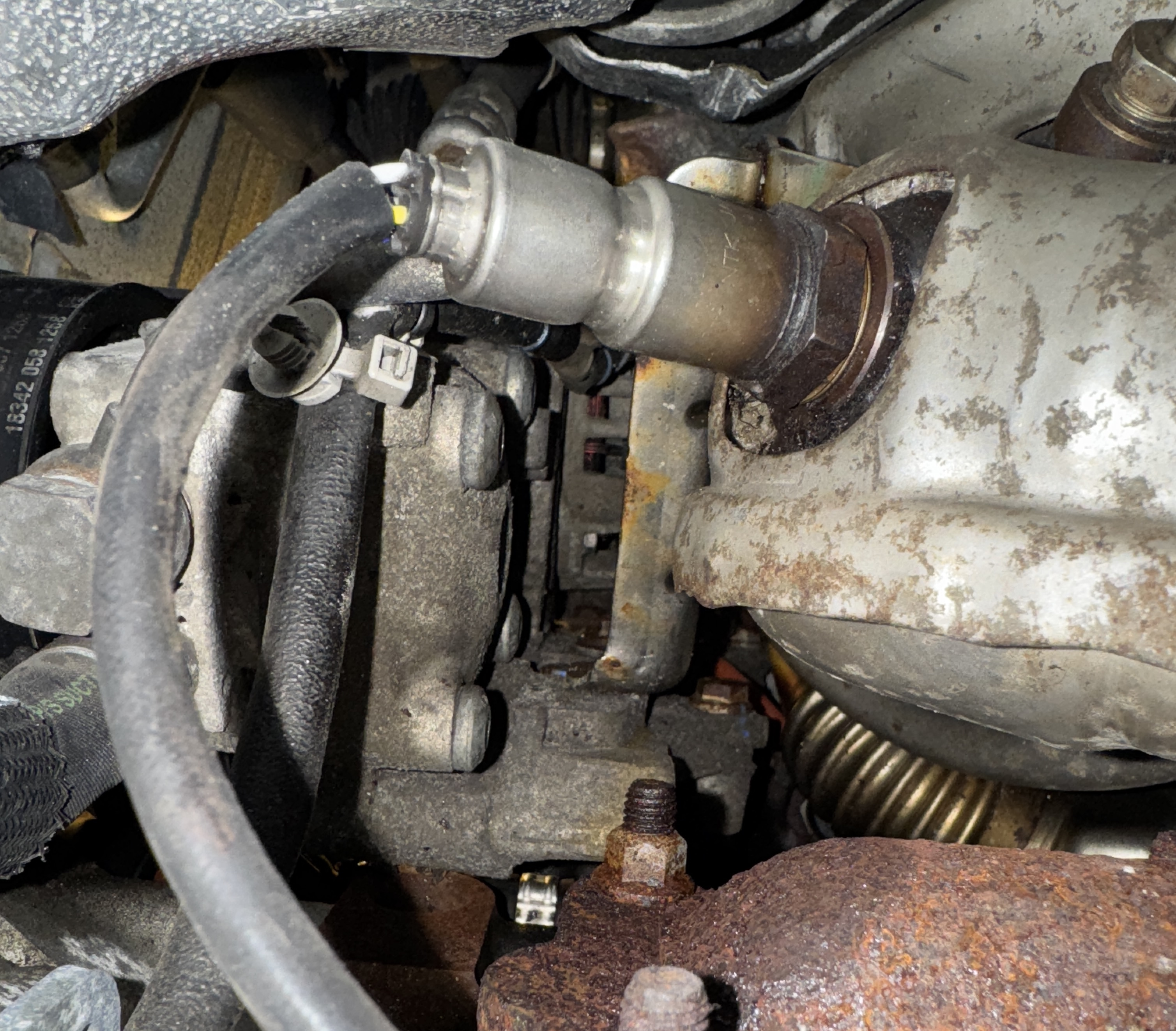

I'm still if the opinion to clean the cooler Insitu. We've had the recent photo of the top elbow of the cooler exposed with removal of the LP EGR.
We have to find away to remove the LP EGR from the top and leave the DPF/ suspension untouched.
With the LP EGR removed, we undo the bottom flexi ribbed pipe, fit a lead(?) disc to blank off and re tighten. This would allow filling the entire cooler with caustic, allow to soak before flushing with clean water.
So gentlemen will somebody work out 'the how's
I'm wondering if it's possible to undo the gearbox mount and with all drive shafts etc still connected have enough room to reach down and disconnect.
Ideas and comments welcome.

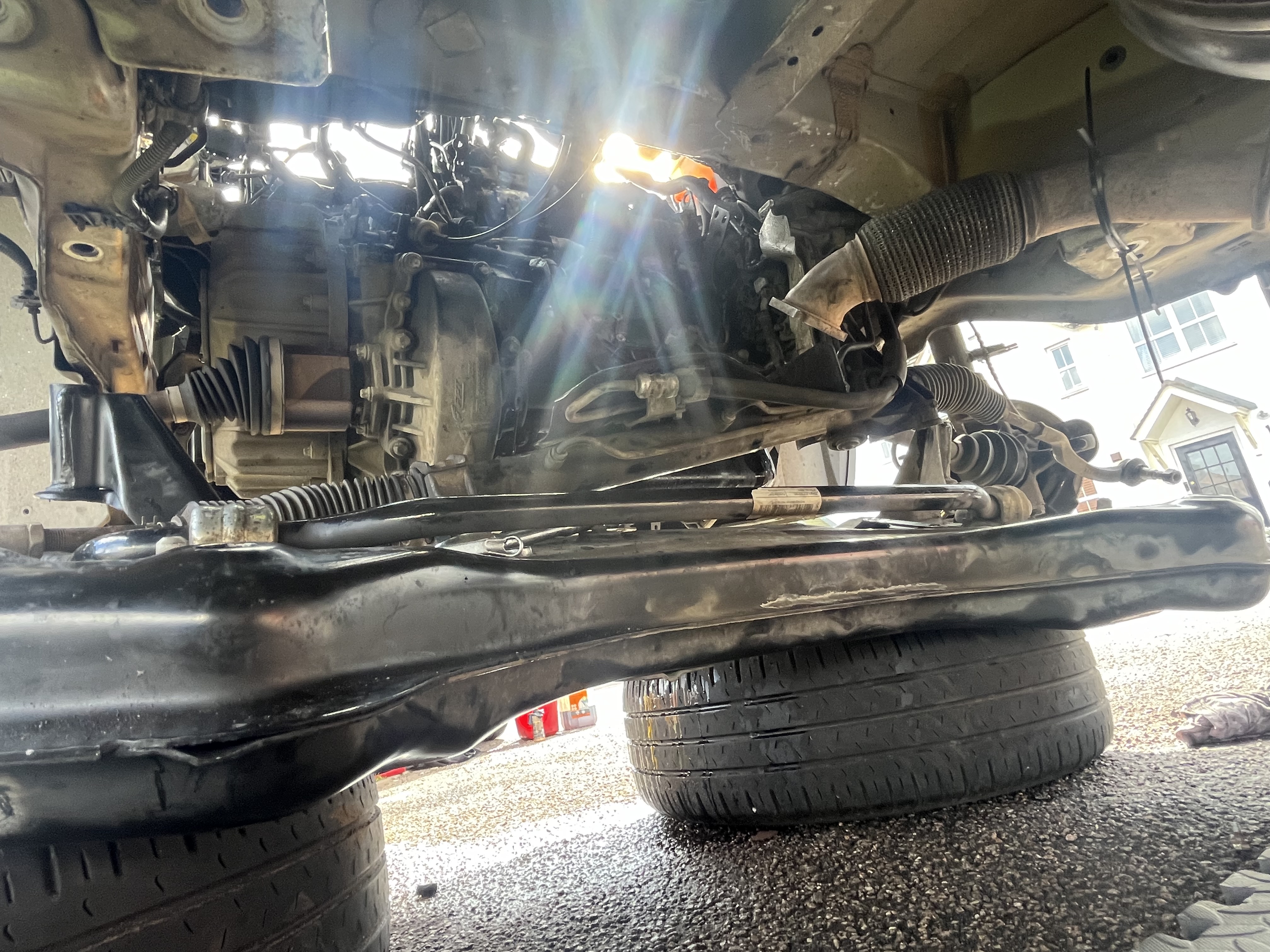

Unfortunately there’s no way to get to it unless you drop sub frame as it’s well tucked out the way, but if I’m honest dropping the sub frame was easy, undo the 4 bolts holding steering rack, take track end rods off and undo 4 bolts at back for frame and 2under wheel arch I left everything else attached and swung it forward with a strap holding subframe out the way,, remove battery and battery box and now you have plenty of room,, get the van as high as you can tho ill fire some pictures over

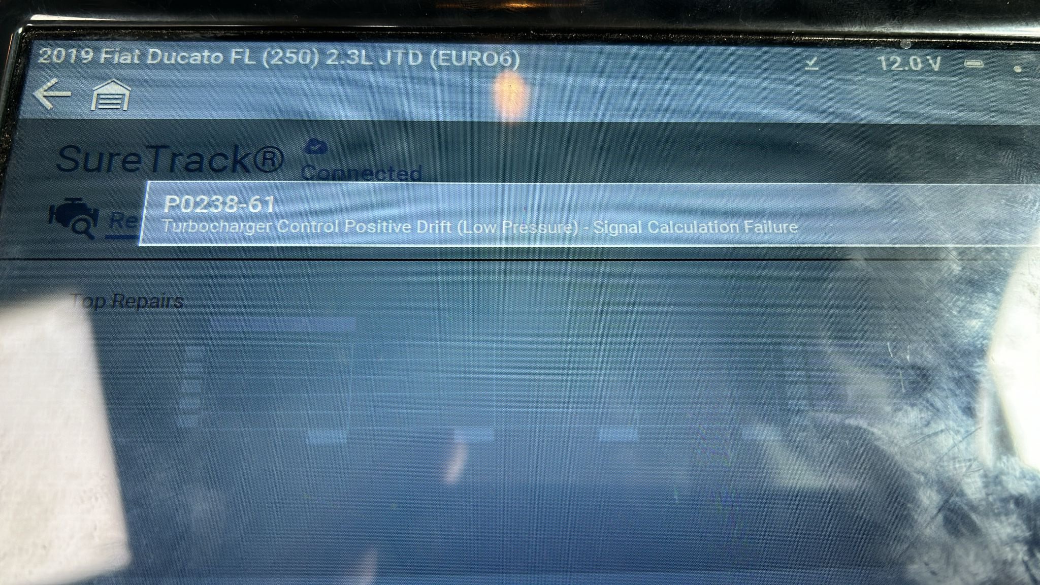

The van is running better but I still have a P0238-61 Turbocharger Control Positive Drift (Signal Calculation Failure) error from a cold start (The other errors have now gone). Once the P0238 error is shown I can run the van for many, many miles after a code clear. The exhaust is less sooty now too. I have taken her on a 100 mile journey from cheshire to cumbria and we are on another 66 or so miles up to Scotland on Thursday this week and she ran well, not lumpy and MPG was way better. On Sunday I will be coming back down to cheshire on the M6 (about 170 miles) so will see how she behaves (I will have to do a code clear after each cold start)
The garage could not get rid of this initial EML and its the first issue of this type they have seen (They deal with a lot of motorhomes for a local dealer).

@Mike D Halliday , it's unlikely to be the LP EGR itself, it will be the cooler that feeds the LP EGR. That will be blocked because of soot from a cracked DPF.

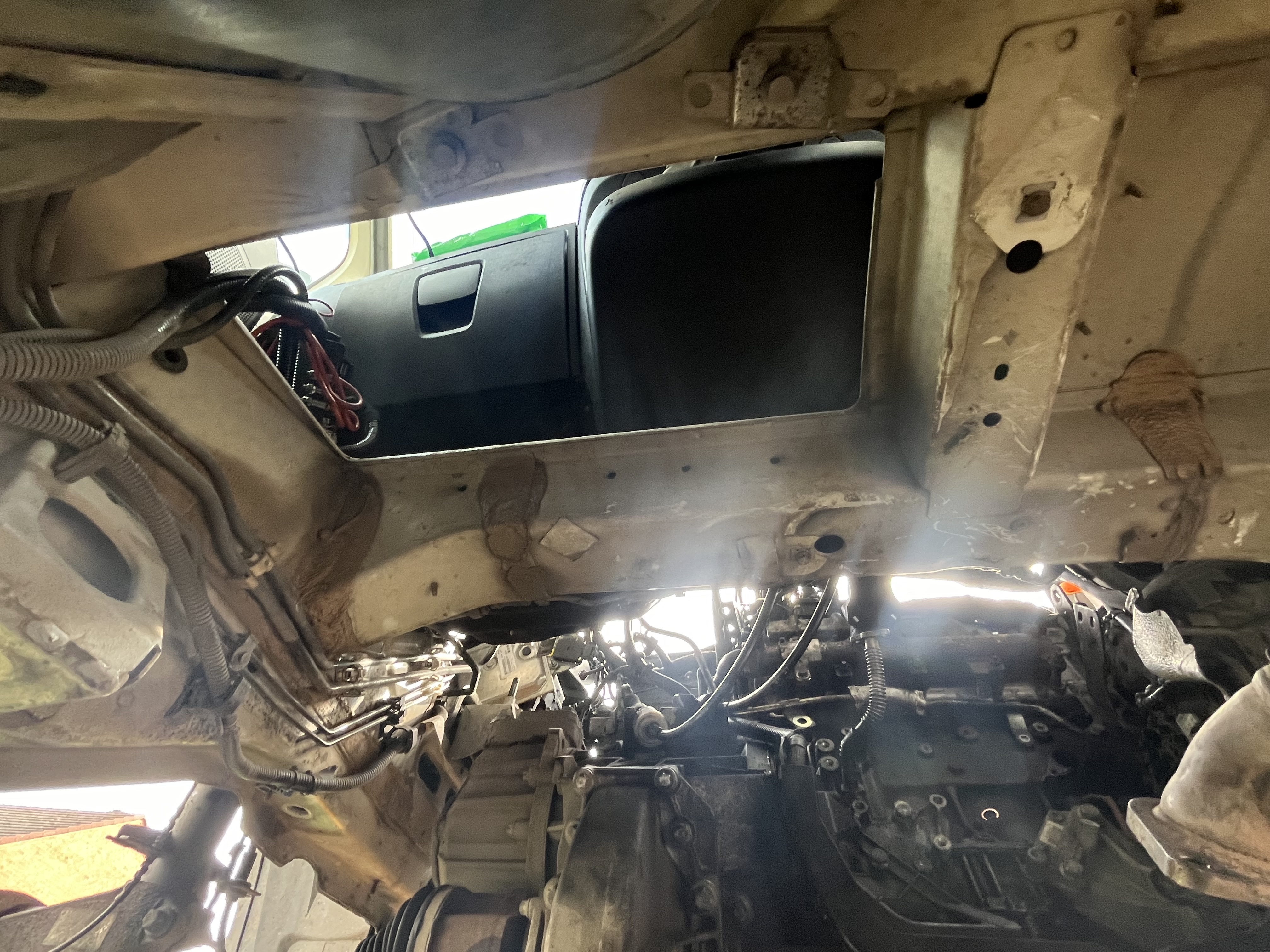

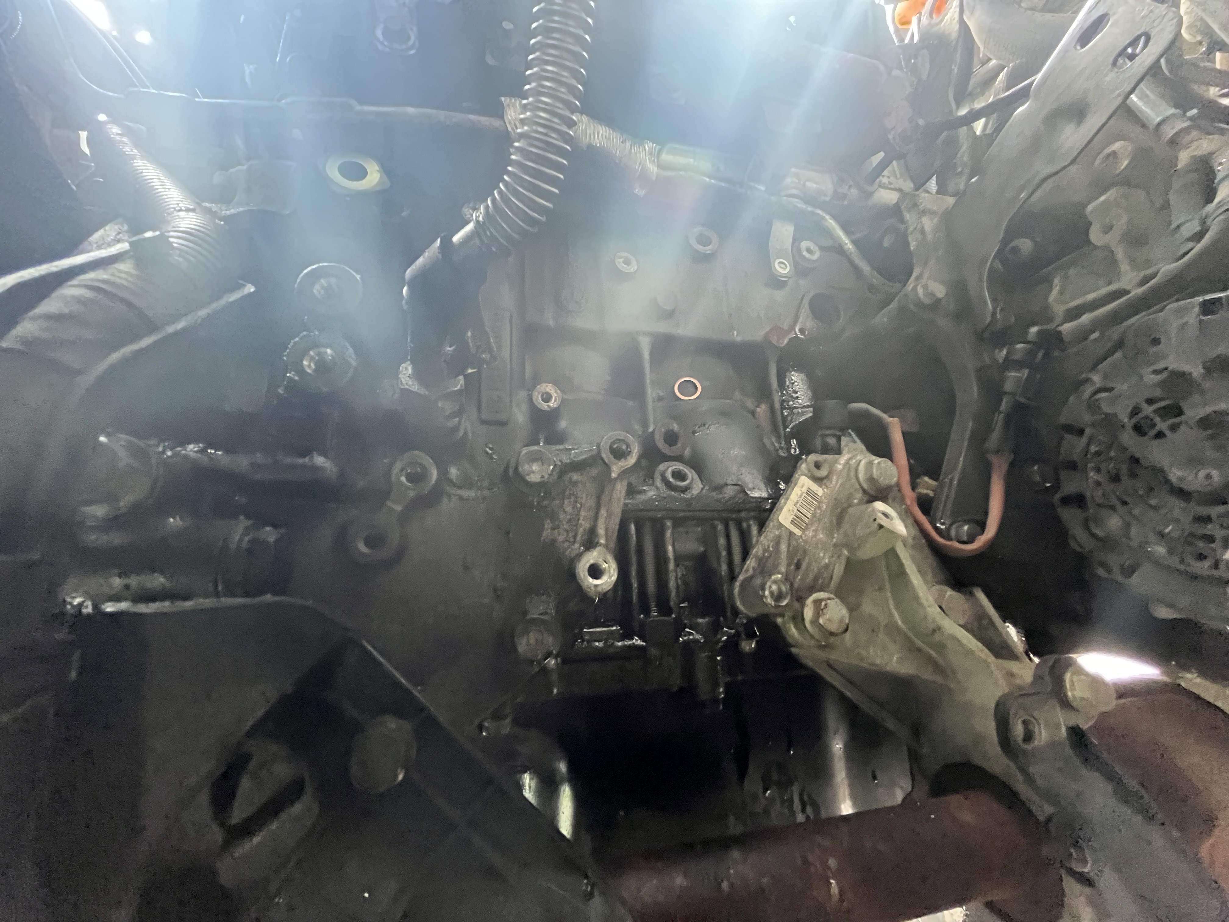

Well I managed to get 3500 miles round Spain with only two engine warnings ( no limp) with a P0401 but on return decided to have a go at replacing the LP EGR Cooler myself. Well after two days work I have to say that the removal of the DPF

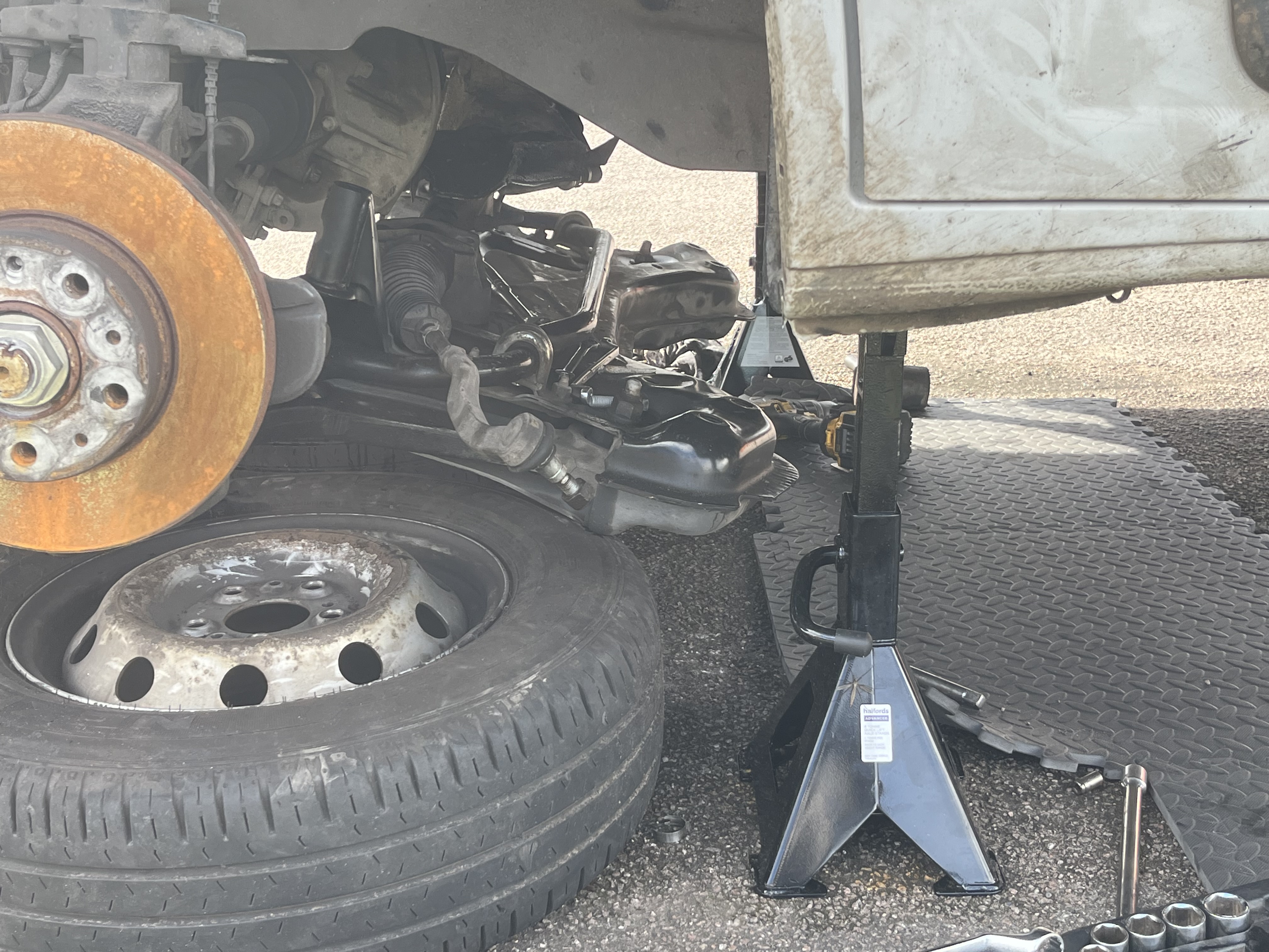

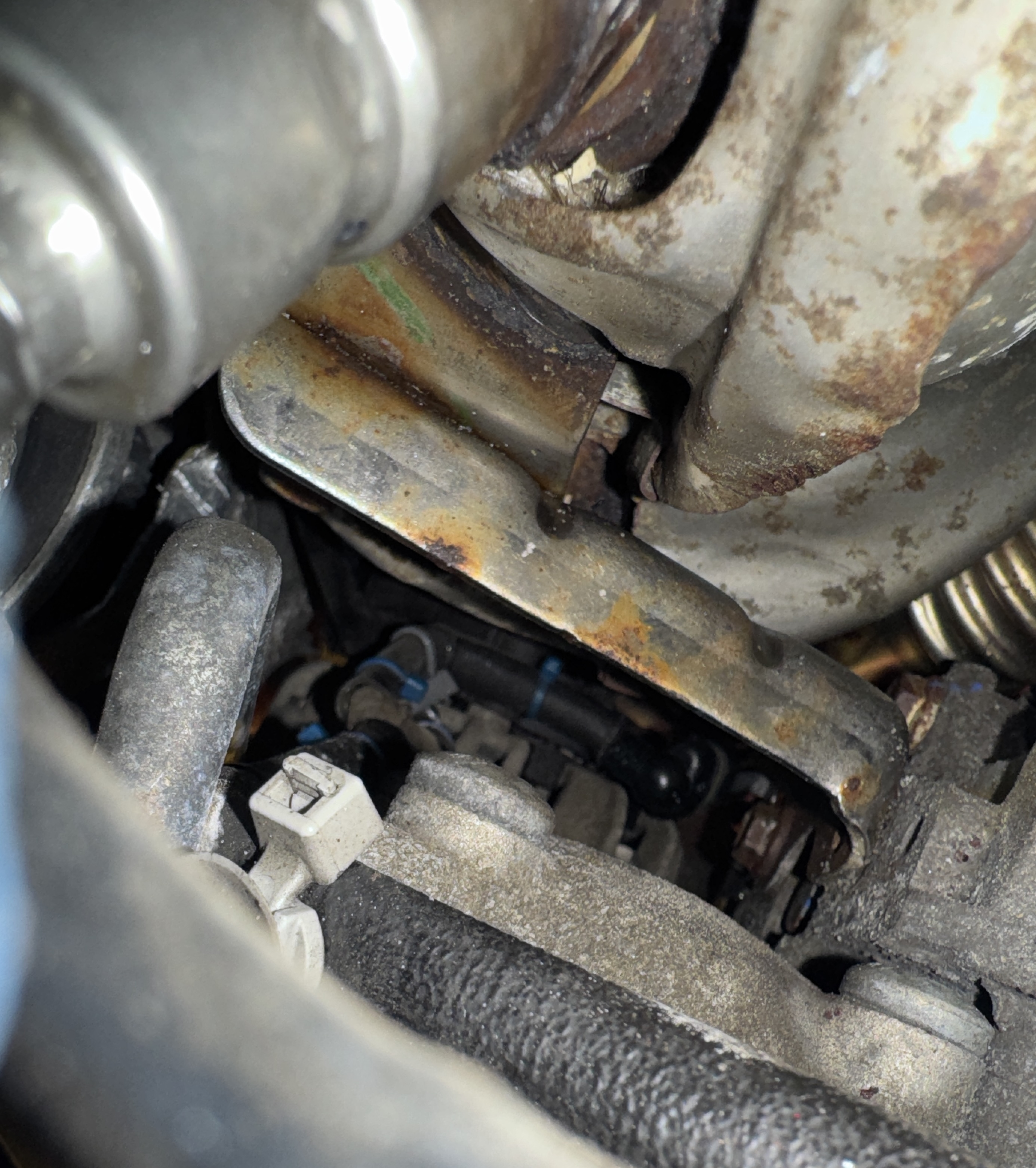

defeated me. It was only two bolts on the bracket attached to the side of the DPF to chassis - but they are so inaccessible that I just can't get to them. Every thing else was fine, but without removing engine mounts and dropping the engine, I can't see how I can get to them and get them off.
Have you removed the subframe and detached the steering rack fixings (leaving it still hydraulic connected). My garage has just done mine for a second time. Much swearing and cursing.
Yip- all done - only just dropped the subframe as Sillystu84 did. Bottom access is fine it’s getting to the top dpf bracket that’s the problem. I seem to have a different bracket and possibly a different DPF that’s shown on the photo further up this page. The bracket on that is black with two bolts while mine is plated with one bolt.

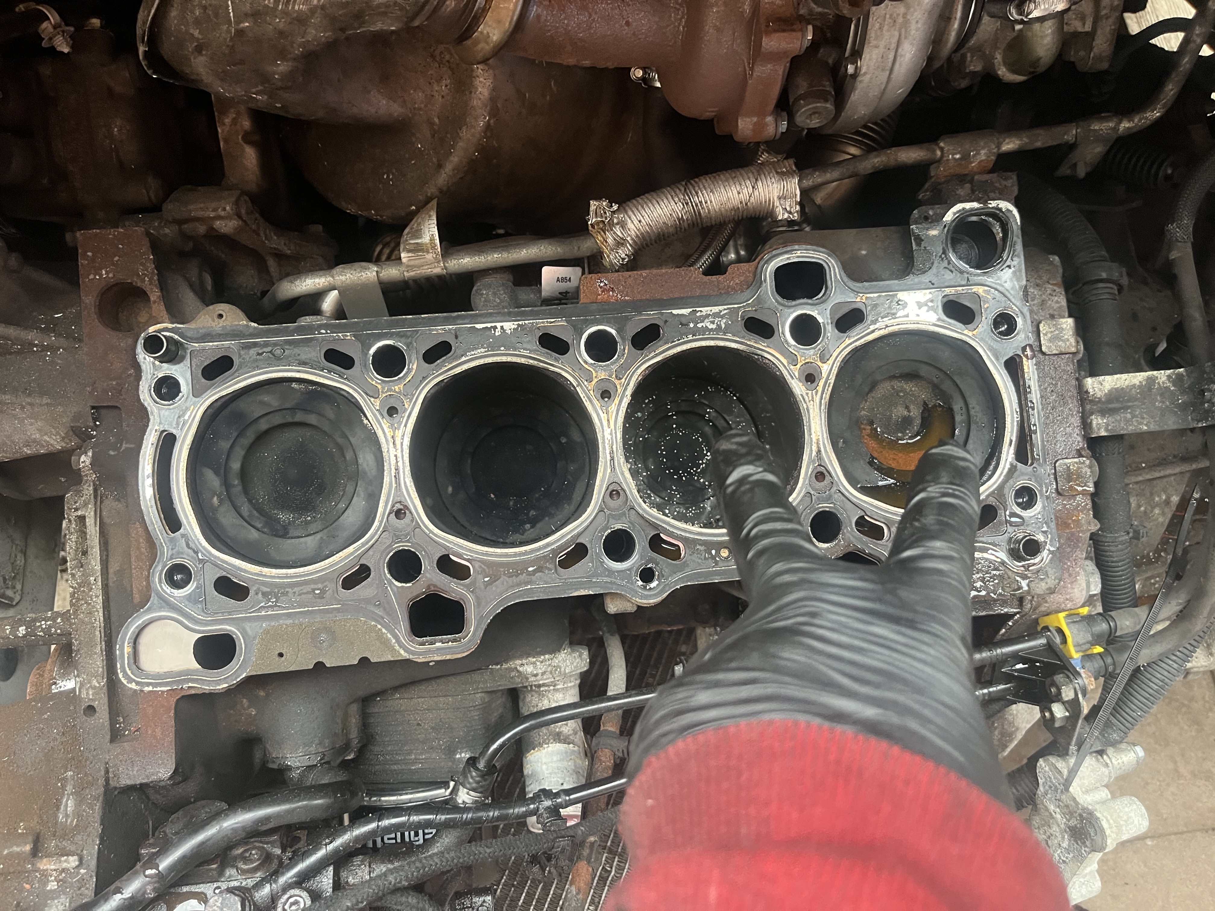

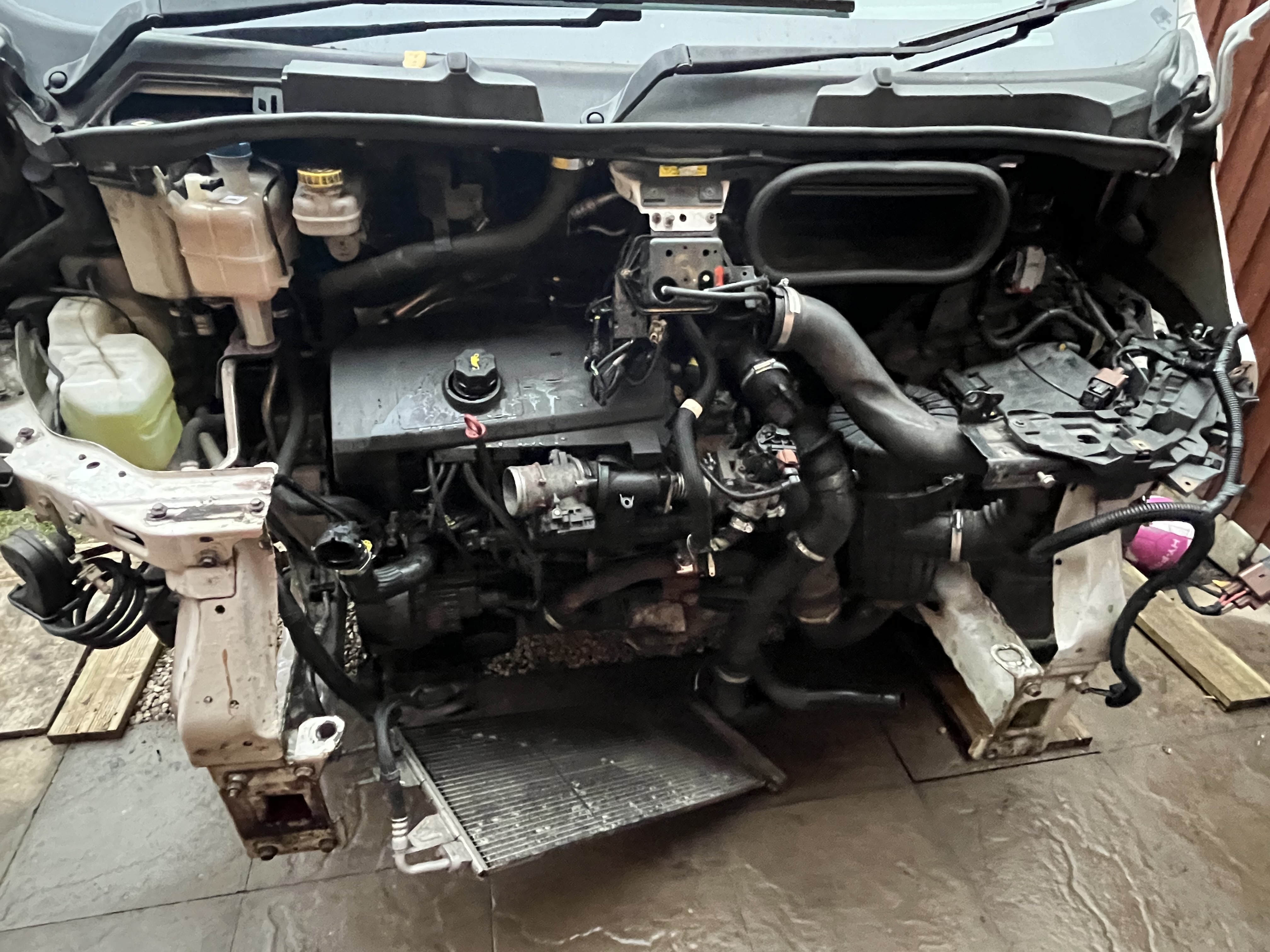

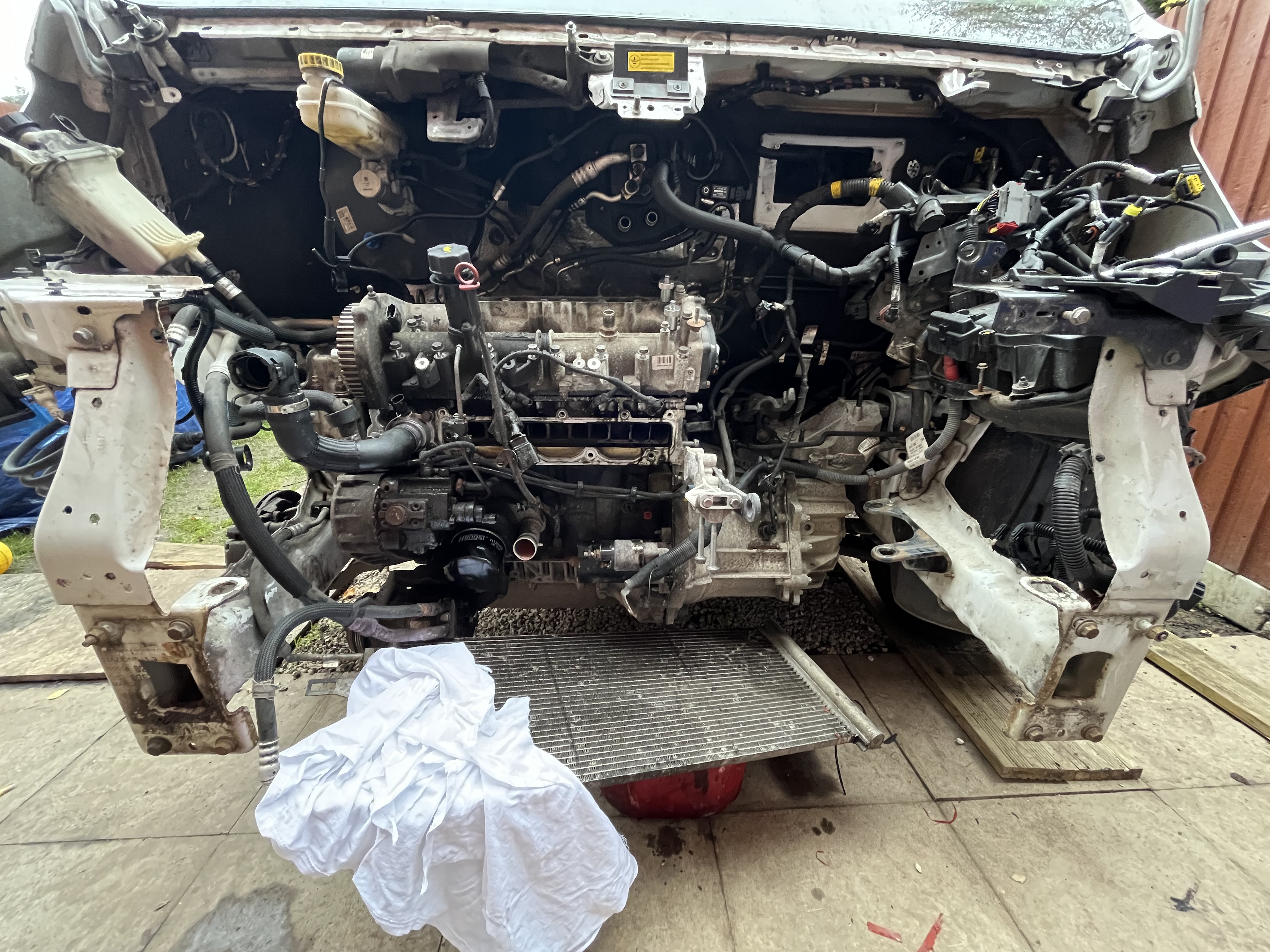

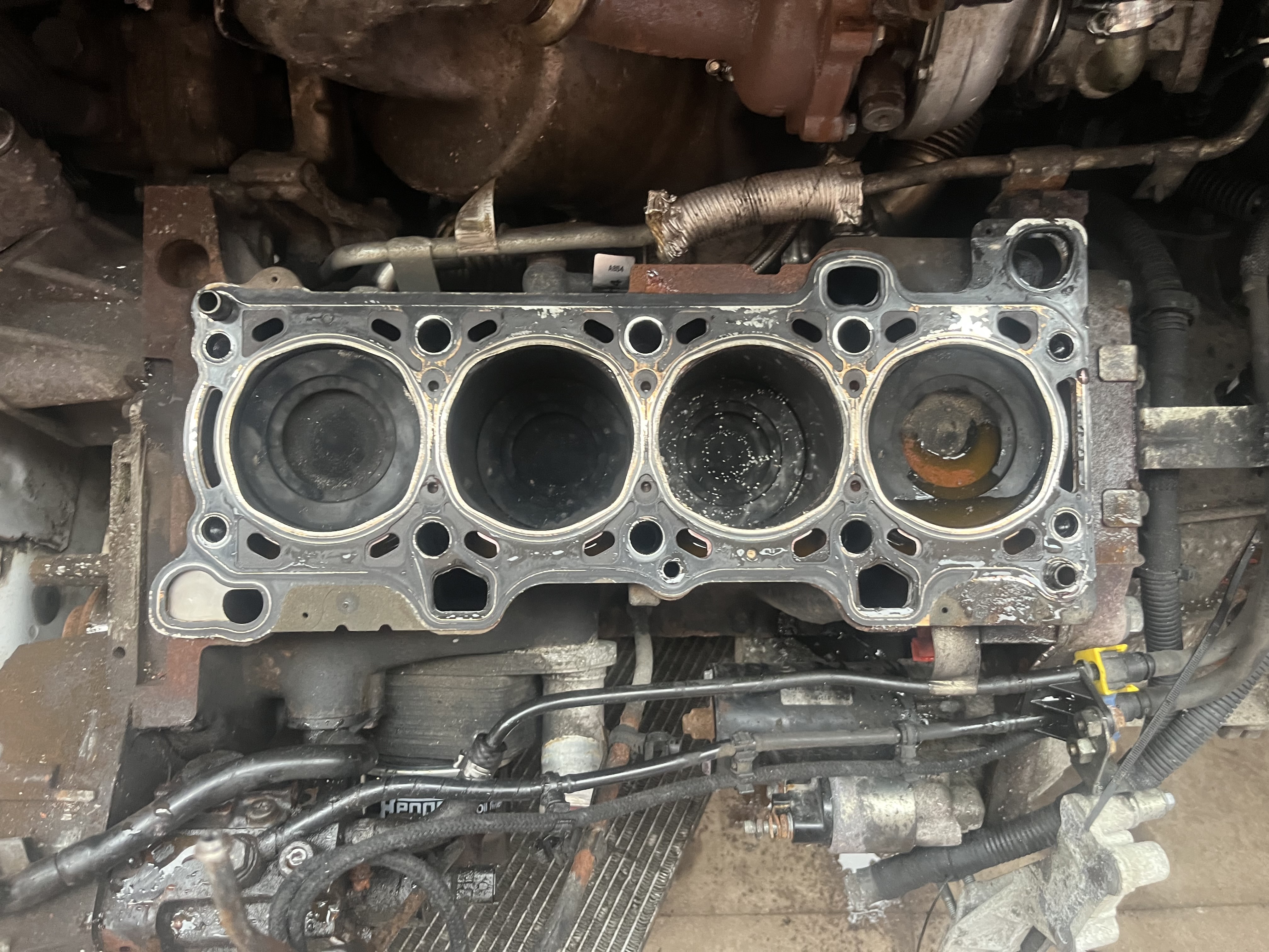

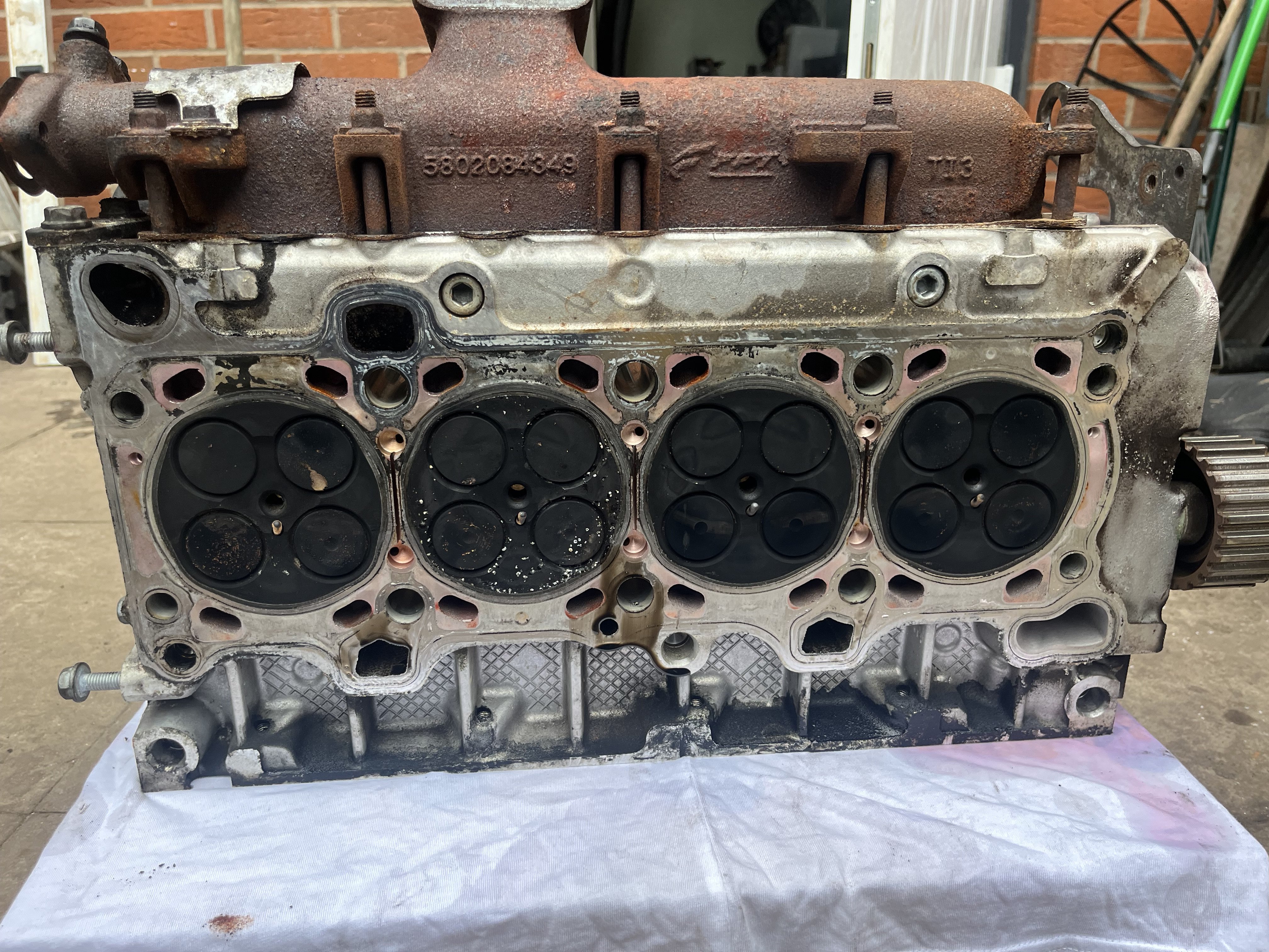

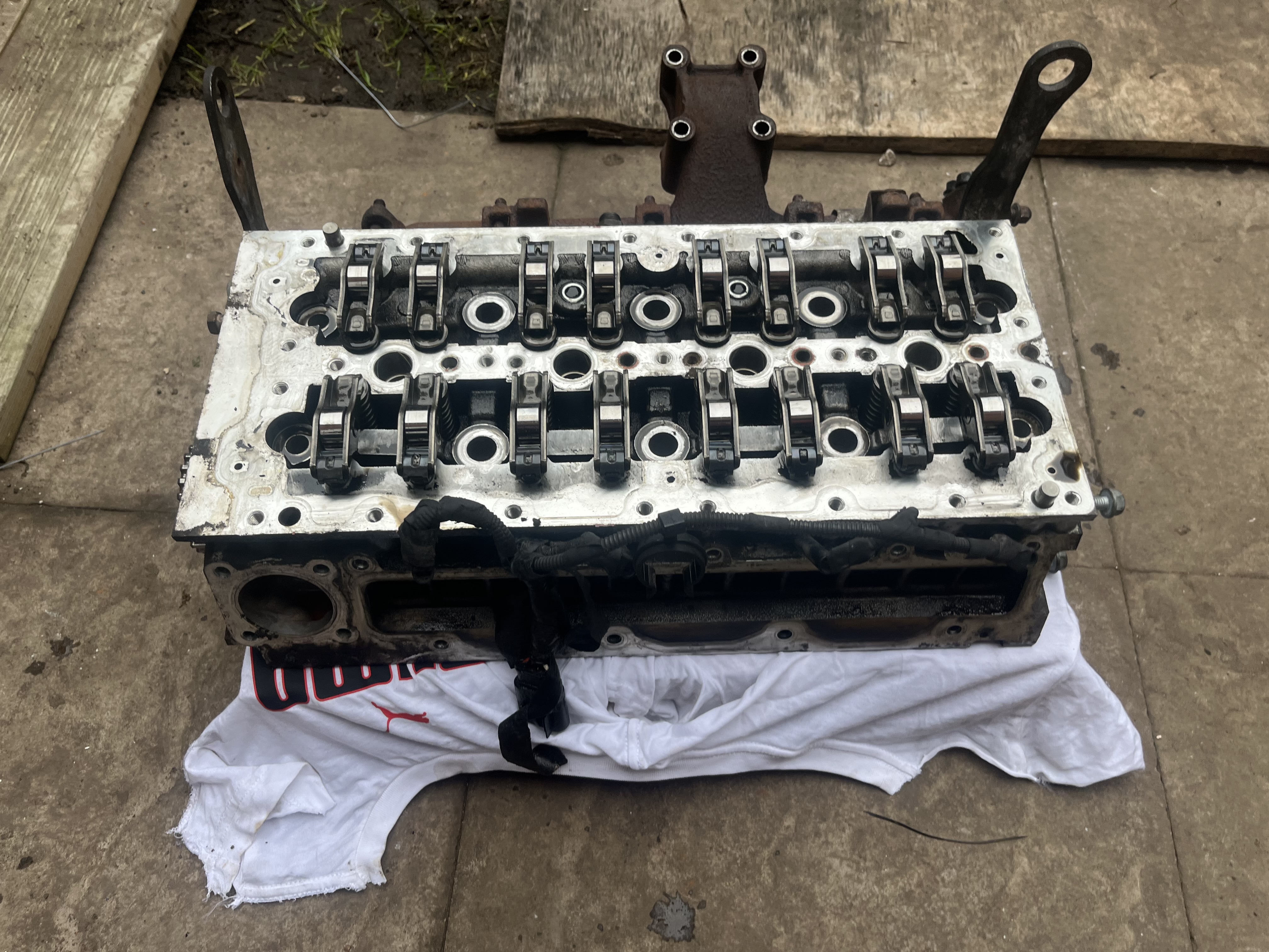

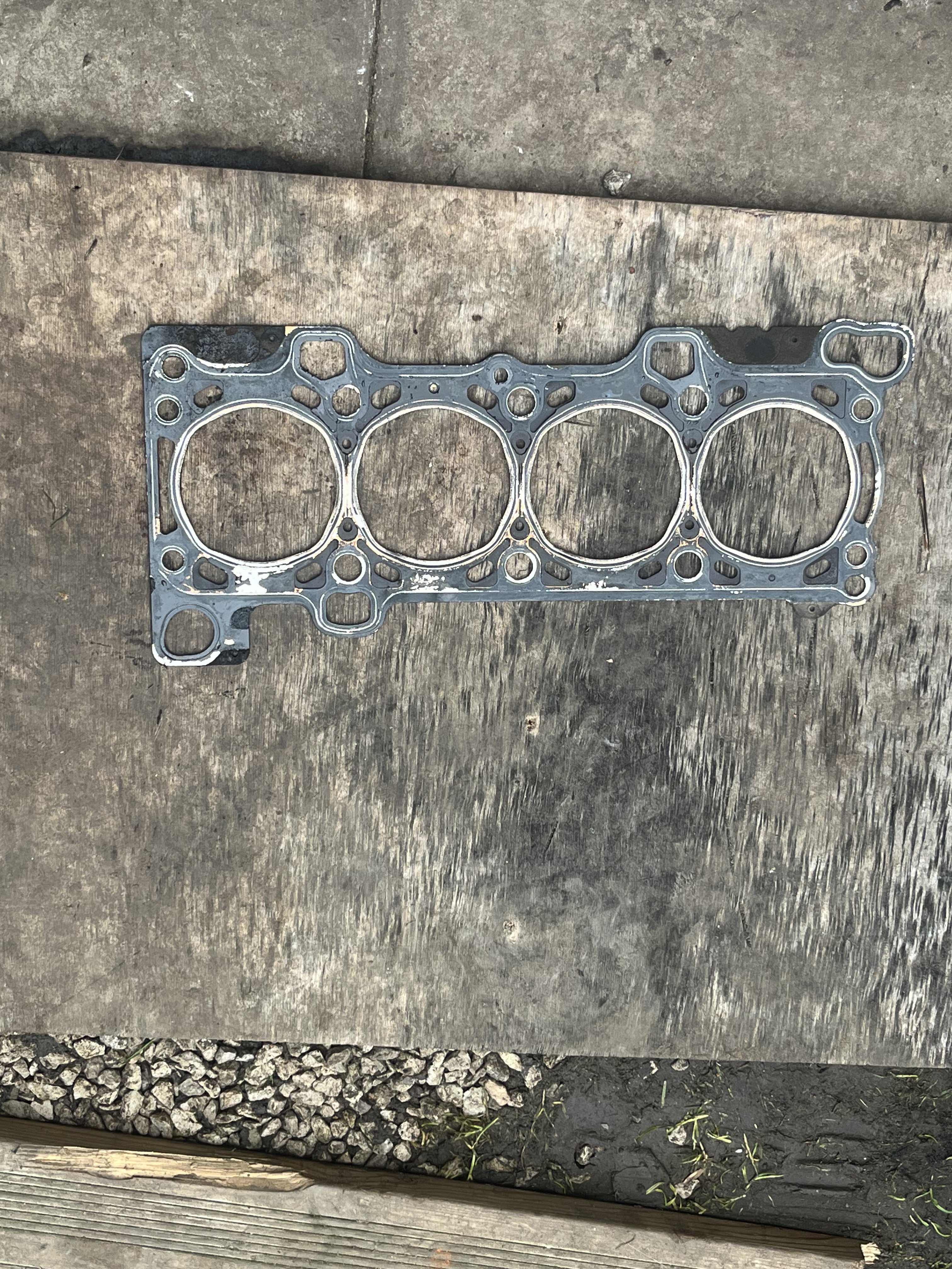

Well as said before I did all that work for the head gasket to go two weeks later,,, so guess what I’m going this weekend ?
Yep the head and if I knew this was going to fail I would of done same time as turbo,egr, dpf replacement because is so much easier taking the head off and then access to all the other parts are easy

@Sillystu84 what's the engine conditions like inside. Pistons, valves, inlet manifold etc? What the van mileage?
I rather think we take our hats off to you.
Hi m8 top of pistons just a little dirty but nothing major, I’ll have a look at cylinder wall on the two that are down tomorrow to determine if walls are ok. The valves and inlet side are pretty clean to be honest the van has done 170,000 and has had a hard life as a recovery truck, I’ll get some more pics
