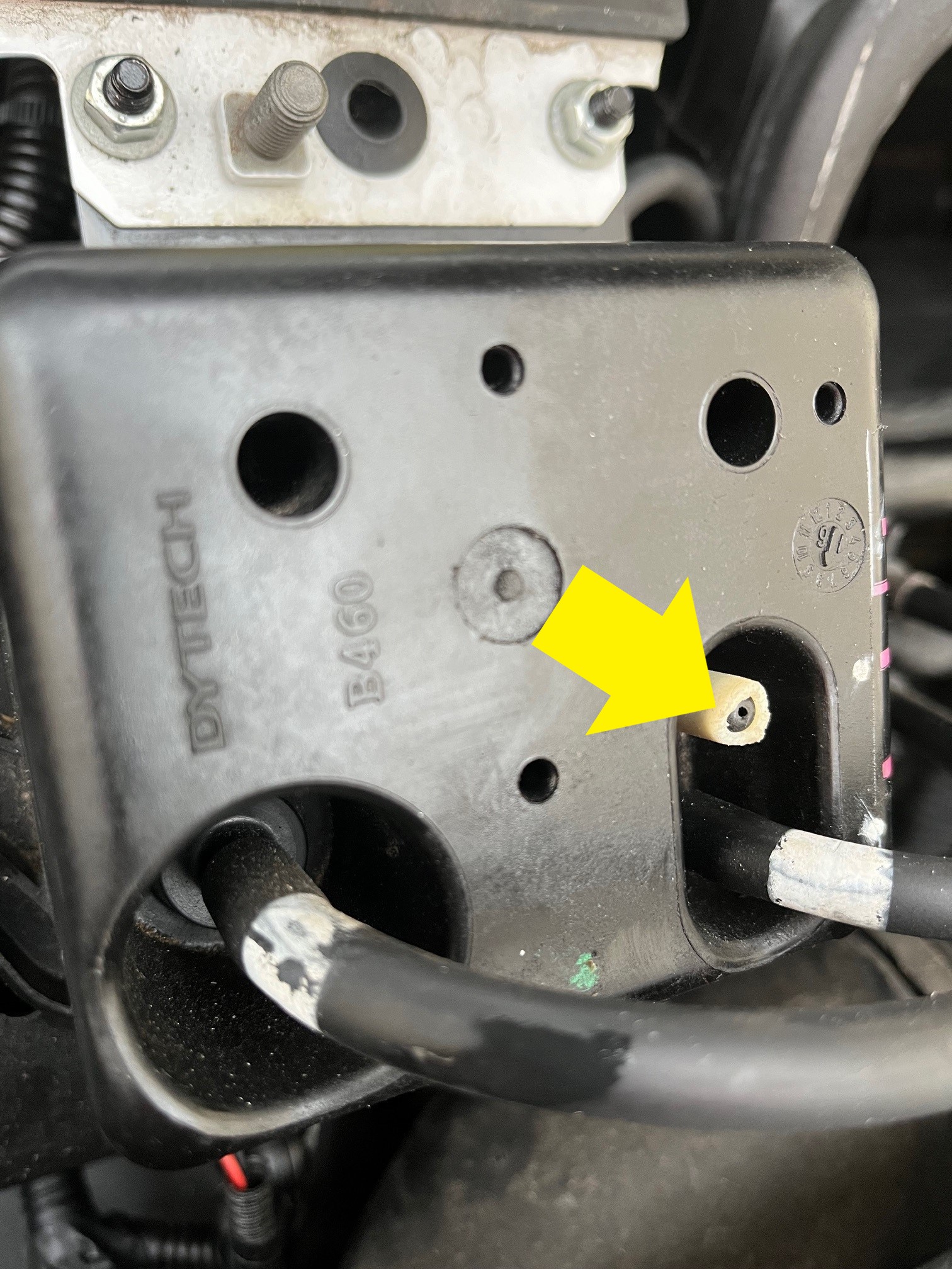

Can I just check one other thing please, going back to my theory about a mouse getting into the engine compartment, does this look normal on the attached pic?? Should it be covered? Looks like it's been nibbled?
yep thats been nibbled should be closed/covered. have a search they may be symtoms and a thread covering it right now i suffering black death and cant think

Thought so, bloody critters!! I've sealed it now, could be an easy fix?? Have found another thread where a chap had the same issue and it threw up a P0238. I'll clear the codes once the dongle arrives and do the test run to get the data. Hope you feel better soon @Oneandonly.
@ben360 if pipes are nibbled and/ or cracked you will have lost the vacuum. No vacuum = no turbo actuator operation.
Thanks Fred, the pipes are fine, it's this that probably caused the issue:
Have sealed it now and looking forward to being able to clear the codes so I can see if it's back to normal now. 🤞
