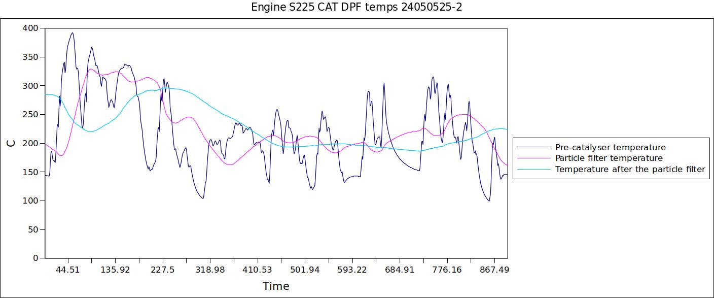

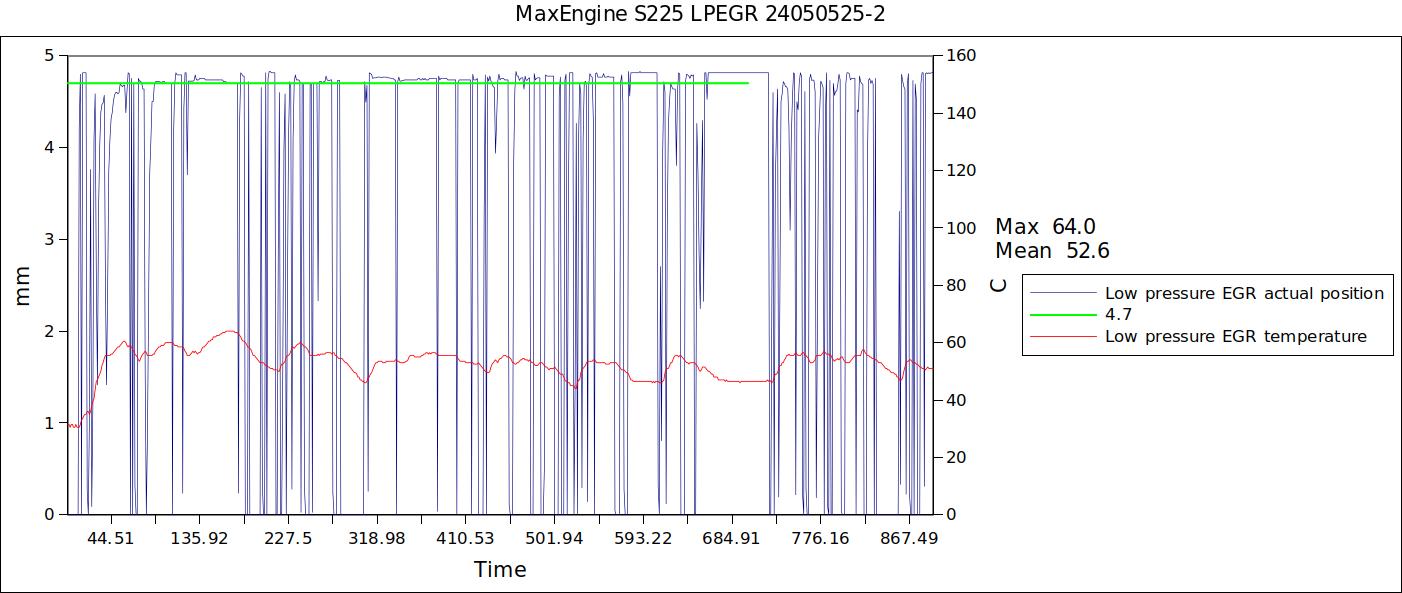

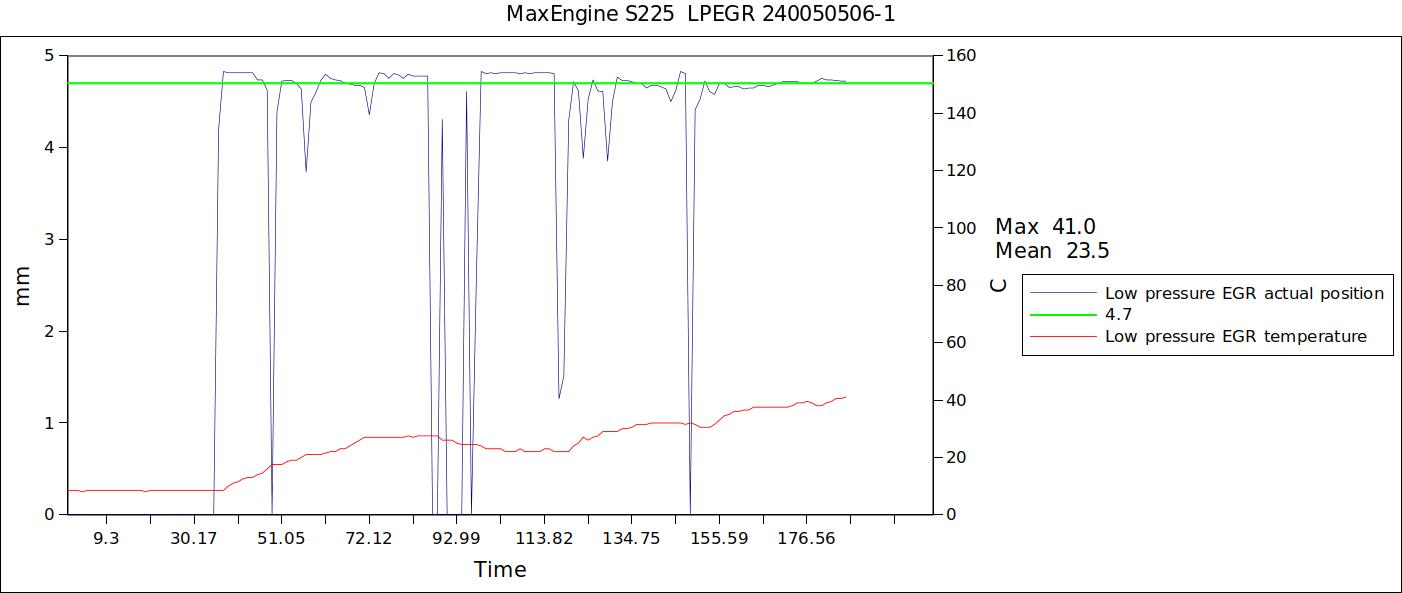

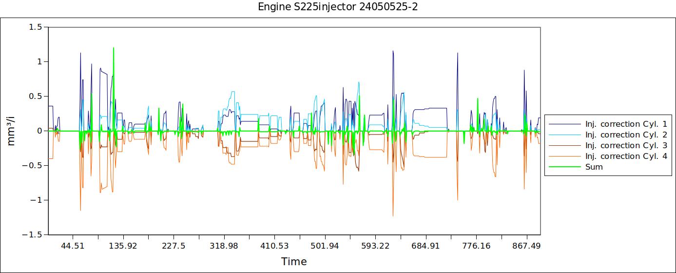

managed to do a run out this morning , living in south London not many fast roads , so cant do a motorway blast . but if I've got this correct the LPEGR valve is not mixing air /gas , its on or off and the temp LP side is to low ...... blocked cooler ? and it picked up a pending P402 on scan after drive .
  • FESExp_2405050625_Fiat Ducato (type 290) 2_3 Multijet_File1.csv
  • FESExp_2405050642_Fiat Ducato (type 290) 2_3 Multijet_File2.csv

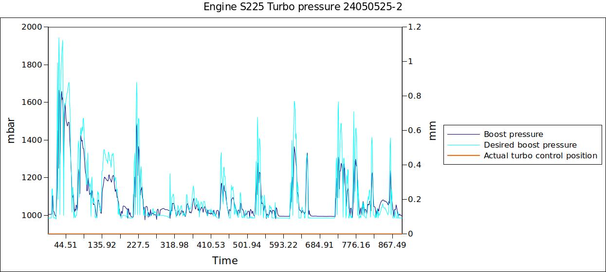

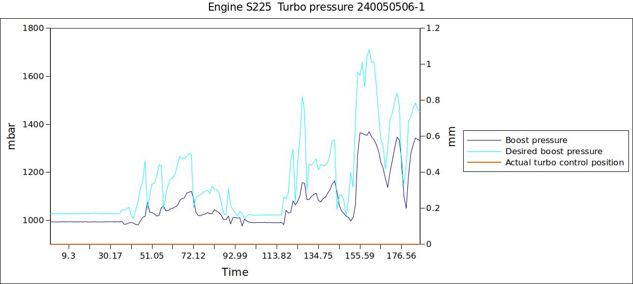

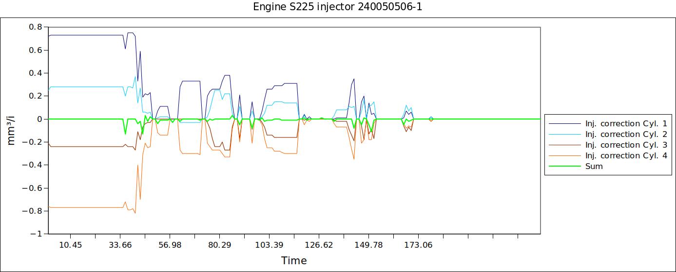

Here are results from the 2 runs

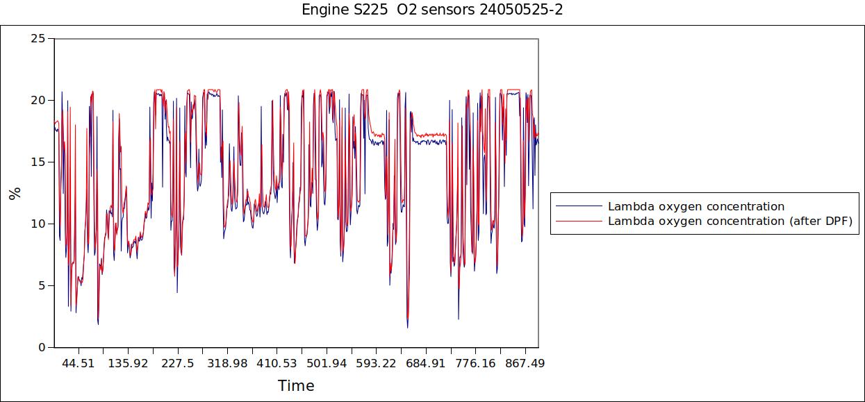

injectors and O2 sensors look fine the turbo lag between desired and actual presure indicate a turbo issue, probably a sticking actuator or turbo solenoid valve (test methods are in the guides area.)
The LPEGR valve generally operates min to max the max cooler temperature of 64C is very low.
Both indicate a blocked lpegr cooler.

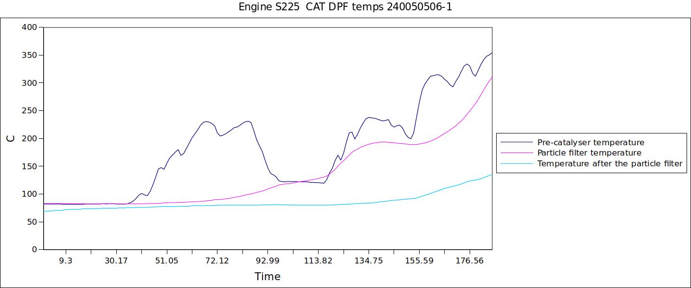

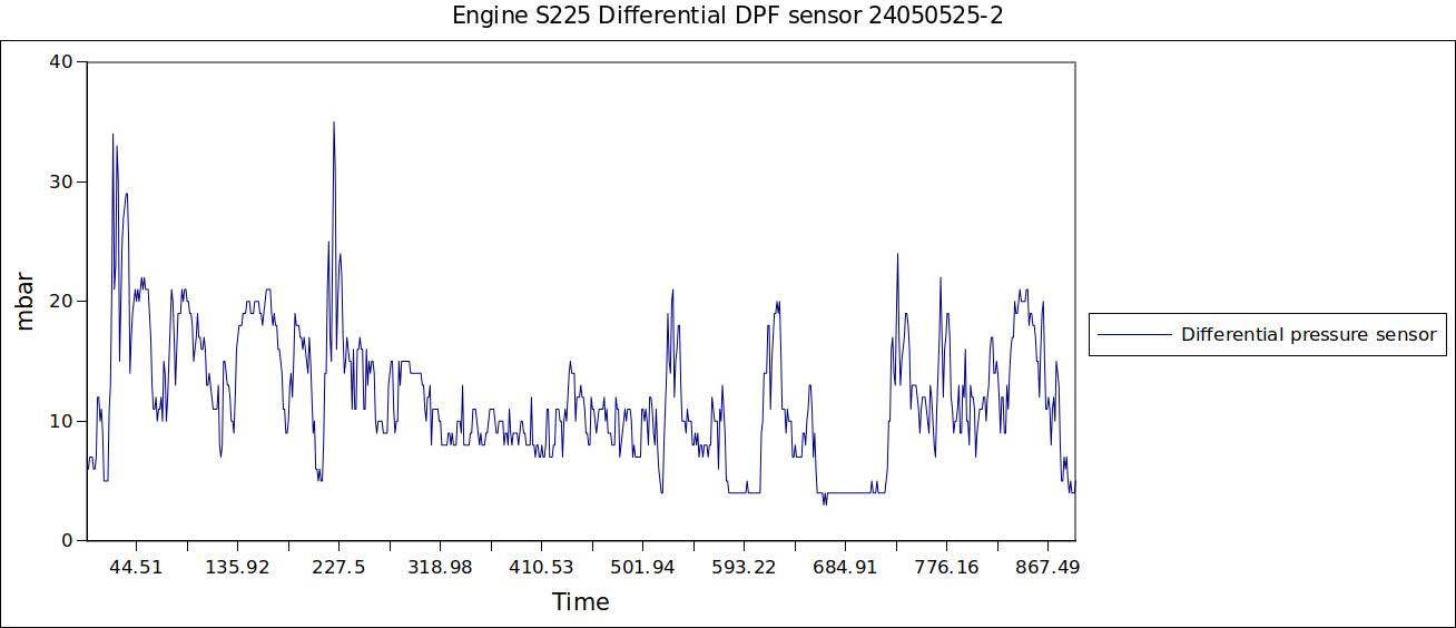

I done the exhaust wipe and it's slightly sooty,but garage has told me DPF is fine?
The differential DPF is quite low is it good or is it low because the dpf is cracked. Did they split the dpf from the exhaust in order to examine as per service notes. Time to wipe the exhaust pipe with kitchen roll again.

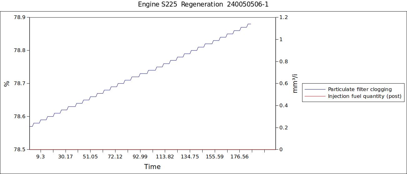

LP EGR cooler will be changed next week.
The DPF I'm sure has a crack as I've been doing exhaust wipes for every run for a few months and it can be very light to thicker depending on speed /time ..so not sure what to do on that ?
Turbo issue was a surprise, sensor was changed last garage visit, so another did they just do it and not even check it on diagnostic.
Thought my days laying under a motor on a Sunday where over , apparently not .
Ok I've just been under van and can just barley see turbo actuator link arm , it moves manually, disconnect at turbo boost sensor vac pipe and when vacuum applied by mouth I got vacuum, but it's impossible to see if link arm moves , did Multiecuscan test on boost control solenoid,I got a few clicks so assume ok .
Will have to ask garage to check when in next week.

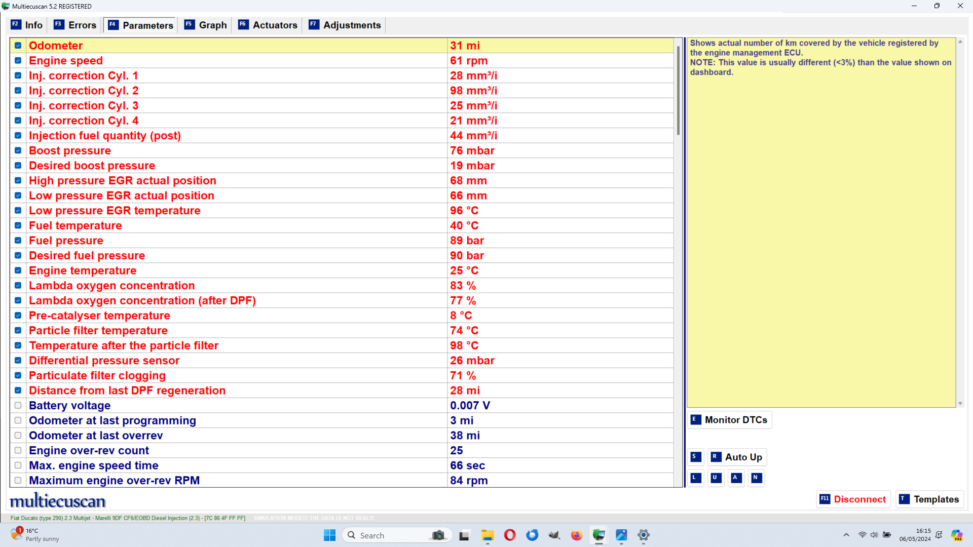

Here we go folks, I look forward to seeing what the thoughts are on the attached.

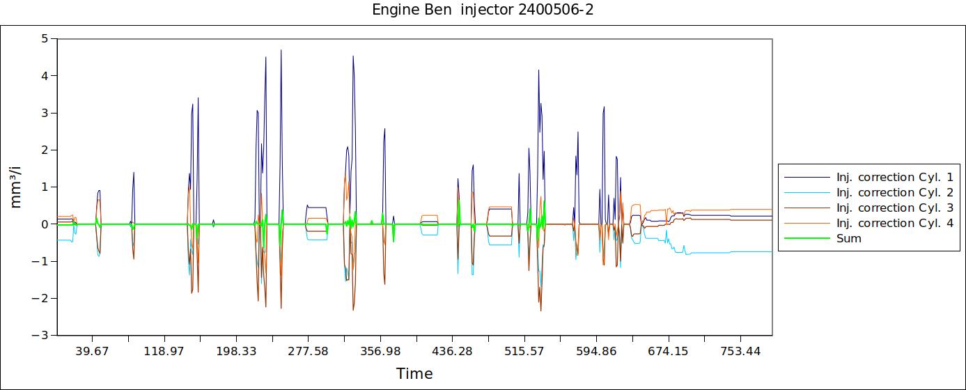

A couple of things I have noticed as a novice, injector 2 seems to be at odds to the other three and although I had the oil changed a few thousand miles ago, with the correct spec, I doubt my local garage informed the ECU, which seems to be a thing. Should I tell the ECU about the oil change even though it was a while ago??
1 would register the oil cha nge now. No oil changes have been registered at all.
2 you have 1 reprogramming. When was this, please post page F2 with software version.
I will look at csv later.
Software version is 23, not sure when the reprogramming was done, I took the van in for a recall around 2019, maybe then or previous owner? Will register the oil change now.

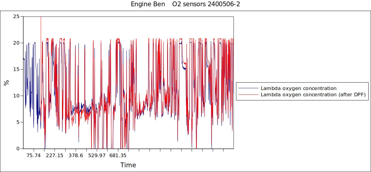

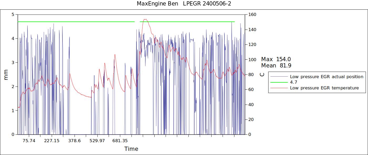

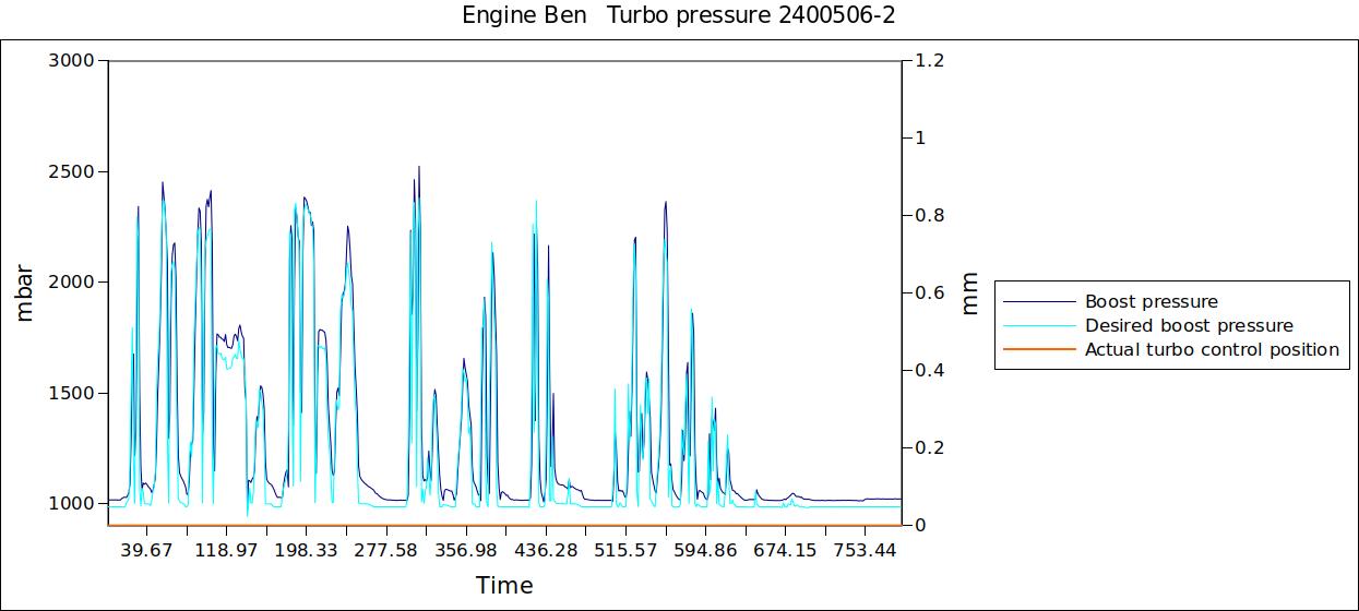

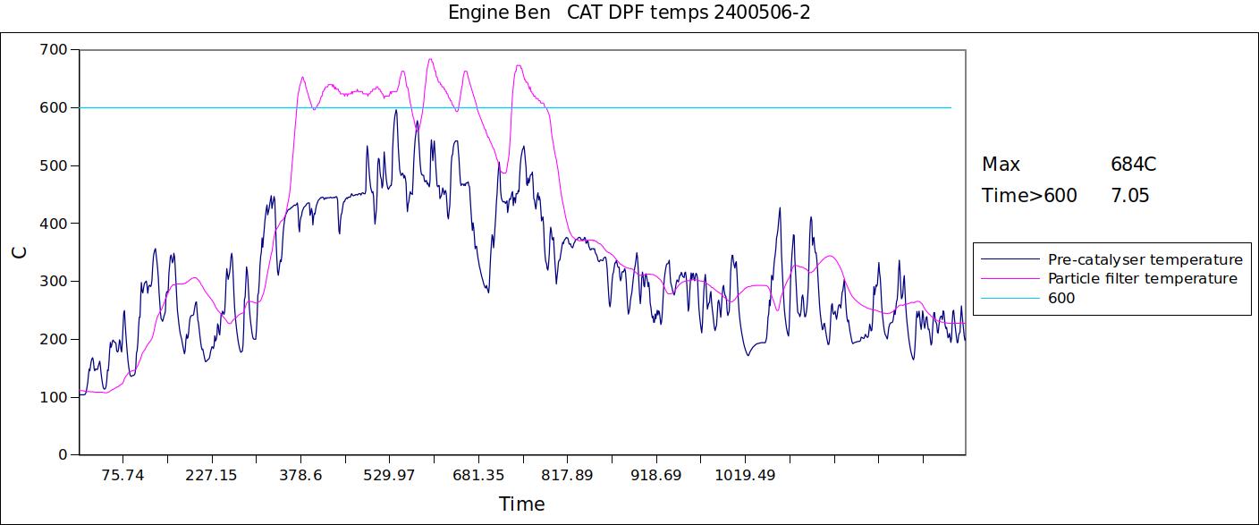

the version of template 4 must have been an early one quite a few variations from the most recent and the txt file i sent. But what have we got.
Injectors 1 outside Fiat limmit of 2 2 close
O2 and turbo OK

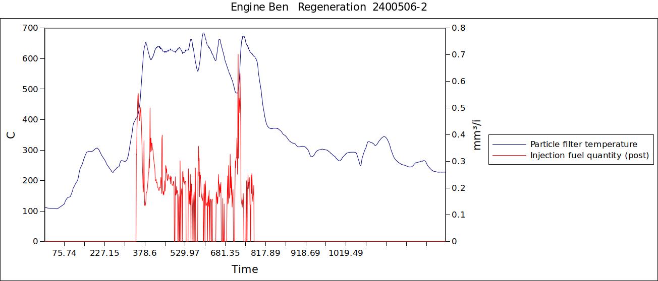

DPF max temp during regen 684C. I have very few captures of a regen to compare against.one oct 23 678C
duration 4.7min
I think the regen has interfered with the LPEGR activities so would really need another run
