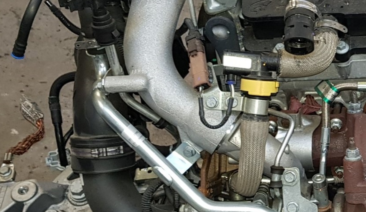

I wonder if it is the yellow component in the photo? it is listed as "Engine breather hose Fiat Ducato 2018-2021 2.3D" https://www.auto-ricambi.eu/engine-breather-hose-fiat-ducato-2018-2021-2-3d-p127108/View attachment 449614
Your guess may be better than mine, but it seems to be in the connection from the crankcase. From earlier diagrams the roughly rectangular engine cover at the upper RHS of the photo, would contain the oil vapour separator, with the vapour outlet being the truncated black object at the top, that is secured by a hose clip.
The object i think you refer to is a hose that connects somewhere over the gearbox end. It will be interesting to hear from muttley 1994 when he returns
Thanks, this second photo is interesting. I would expect to find the air inlet hoses at the gearbox end. No sign of any other electrical connection, so the yellow object is prime suspect for being the oil vapour heater.
The yellow thing looks very similar to vapour heater I moved out of way when when working on a Peugeot car last week . So I agree.

I do believe it is the assembly with the yellow item. Check engine warning light on dashboard is continually on.
I have measured the voltage across the supply connector which measures approx 5v which I think is OK as it comes directly from the ecu (Pin 57 on my vehicle) and has no other connections (does not come off the fuse board), the negative wire gives a good solid electrical connection to ground.
So before I order a new unit which I think is part number 5802052418. I have unplugged the connector from the yellow thing and started experimenting with connecting various resistors across the terminals and have managed to clear the warning light so it looks like it is the blow by heater resistor unit that is faulty.
