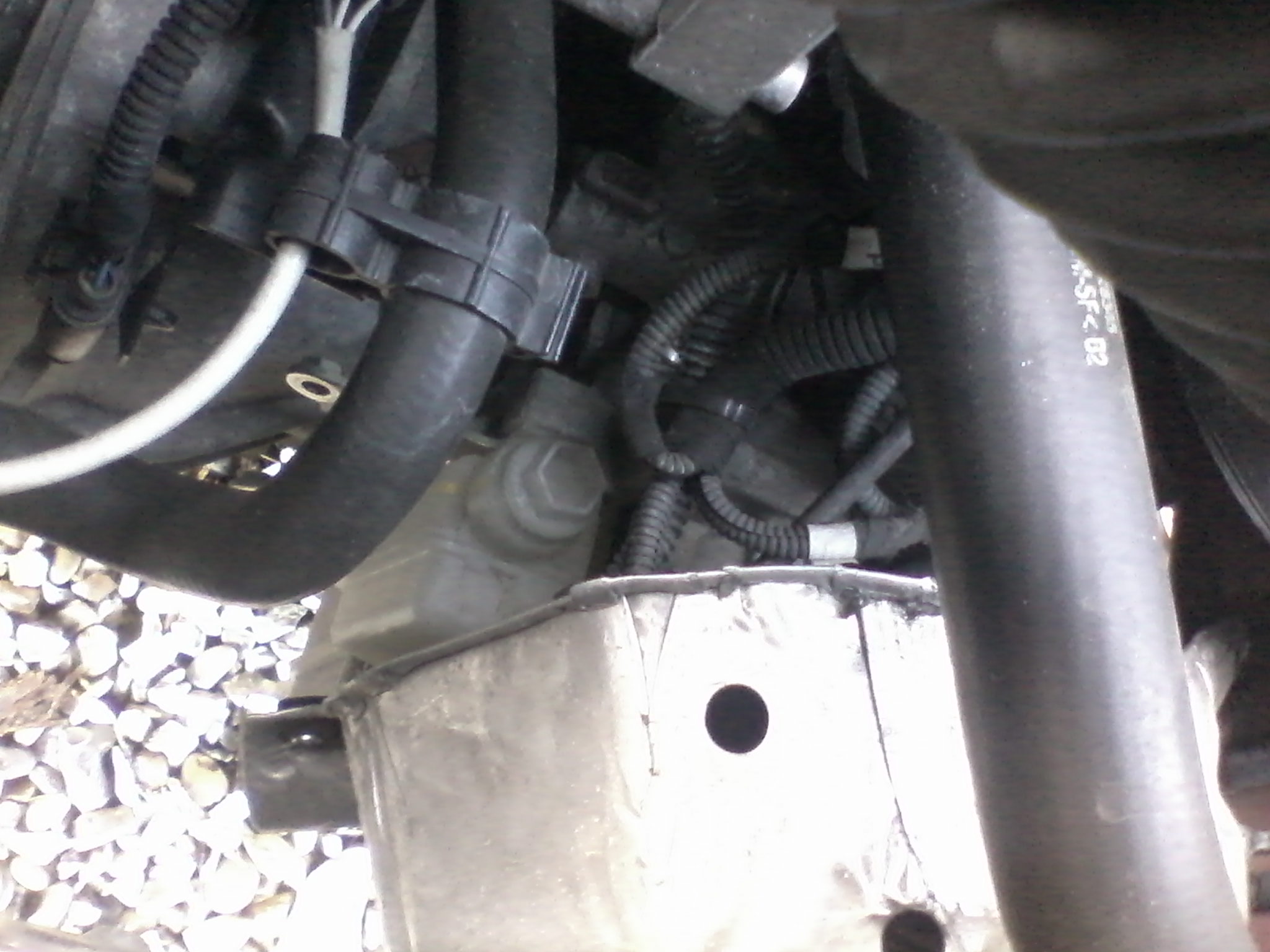

I think you do end of line/service on MES this does purge the clutch of air and calibrates the clutch travel. Theres no others i can think of. I would not drive it until the the fluid is topped up, but then again how long has it been like it?
out of interest is it REALLY CLEAR? ( no Colour..), as there is NOTHING visible in the reservoir

OK, I'll suggest to my father that he buys it from his nearby Fiat dealer then... it seemed pricy to me, but I've never bought any!The part number for it when I had it for our Panda Dualogic in 2010 was 15081616 from my records, and price was £8.60+VAT. So that eBay price seems a bit steep.
I did see elsewhere a PN of 15081616 mentioned and assumed that the /26 replaced the /16, but it was only guessing.
