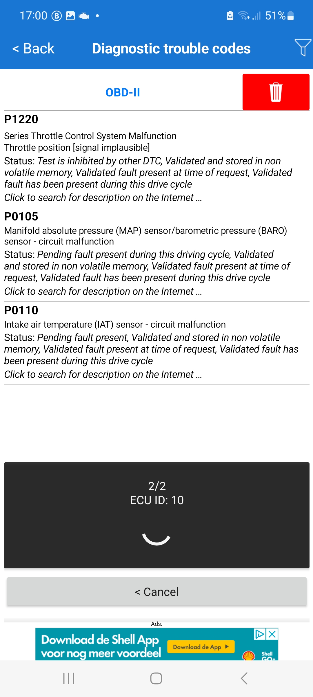

Yes. When I disconnect the MAP sensor the ECU immediately sets P0105 (MAP sensor circuit malfunction) and P0110 (IAT sensor circuit malfunction).
When I reconnect the MAP sensor the fault codes disappear.
The system however also sets P1220. When I remove it, it immediately returns.

Enclosed a snap shot of the DTC's.

Please stop just changing things randomly
As I have already explained the throttle does not normally open fully when you floor the throttle, it a fly by wire system it will open just enough to achieve what is request
We don't need to change things until we find the correct part by chance
