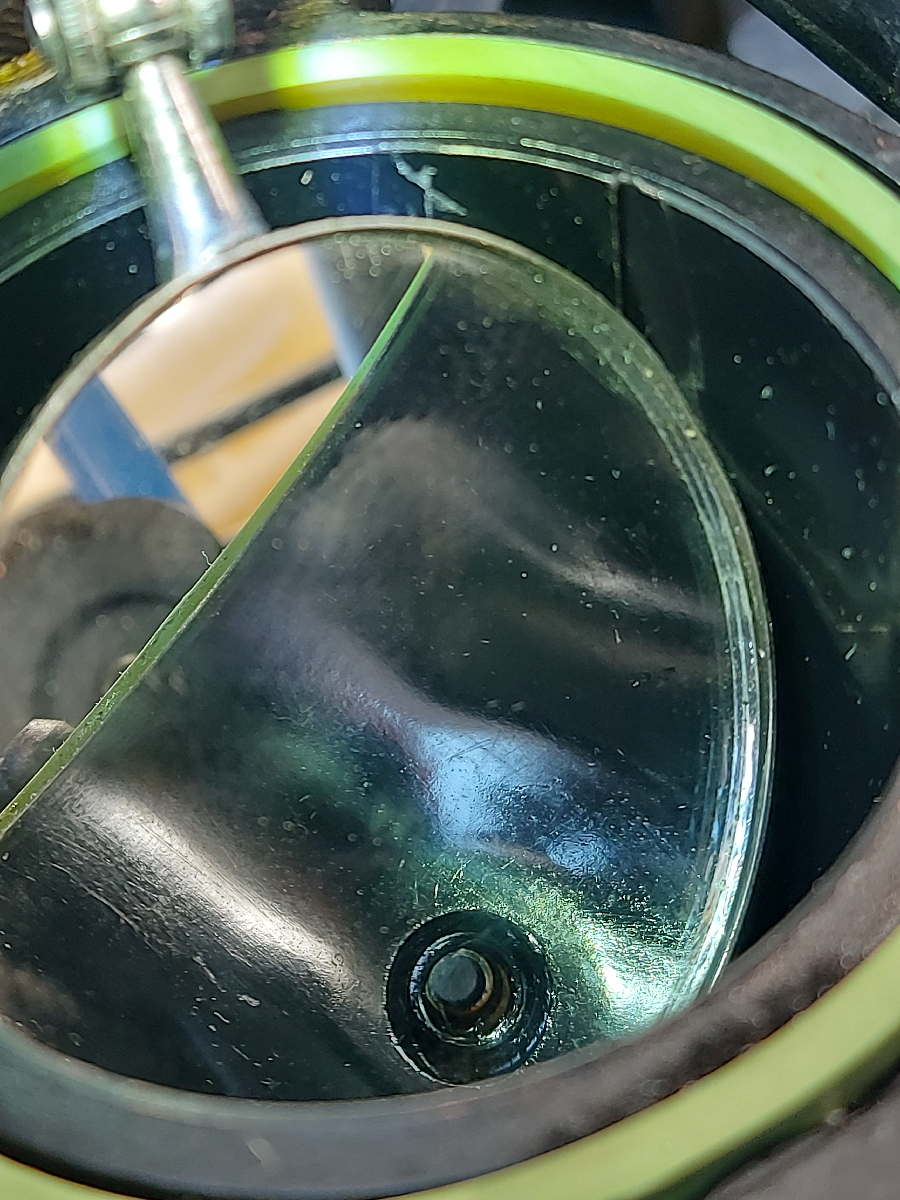

Sucking is the wrong direction any change if you try blowing
I have tried blowing as well and I am able to blow air through that hole allbeit not very much.
I have also stuck some into the hole to look for something that might be clogging the hole. I didn't find anything 'soft'. So I pressume that the hole is open as it should be.
This is a picture from inside the manifold looking into the connection of the smaller crankcase venting hose.
I see what looks like a brass tube with a plastic insert or something. That looks pretty standard to me so I guess this is some sort of tuned suction pipe.
The question I ask myself is why Fiat uses a hose with a relatively large diameter if further downstream there is an obstruction with a potential risk of clogging...
Any other views on this?
I can imagine that if this bore gets clogged all air with oil will po past the throttle valve causing massive contamination.
