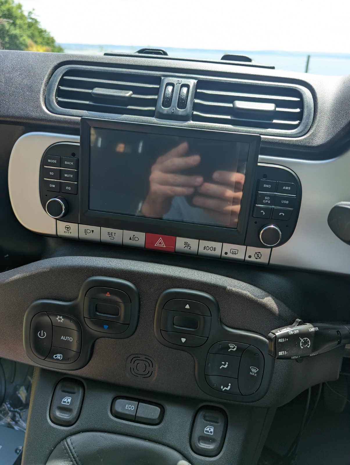

Once everything is installed, a test of the unit before seating it home is required. Everything seems to function, so it should be as easy as sliding it in. But of course, things have been too smooth so far, so, let's throw a spanner in the works.
The unit doesn't fit the hole. (Story of my life!)
The problem is, the screws on the unit that hold the security locking clips onto the unit sit too proud, and prevent insertion. Both sides however can be removed. This of course makes theft of the unit that much easier, but, I'm looking at it this way - it also makes removal and chucking it out the window easier if the thing catches fire whilst driving.
Once in, the unit sits snuggly, and doesn't move, despite now missing its locking clips.
