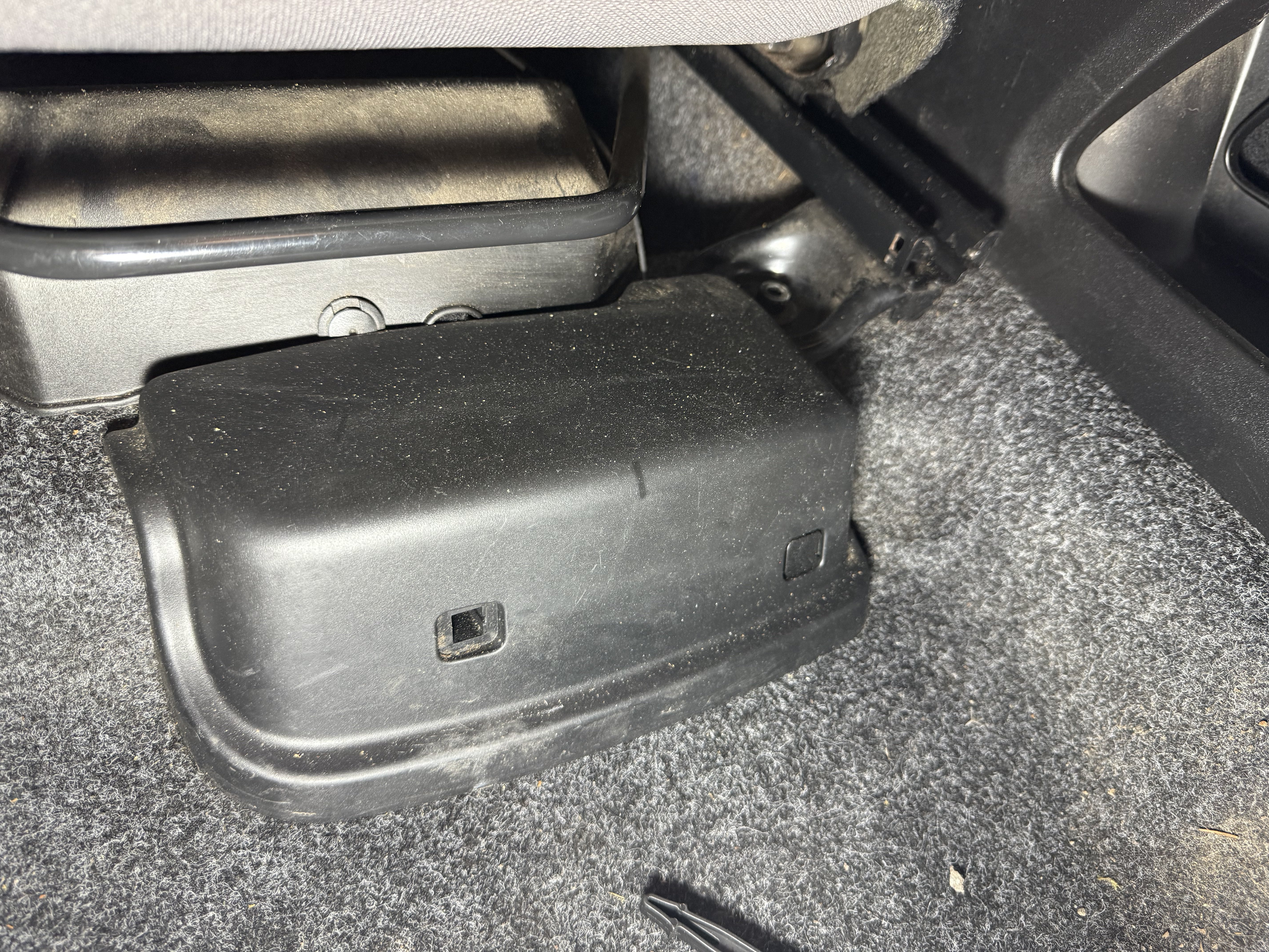

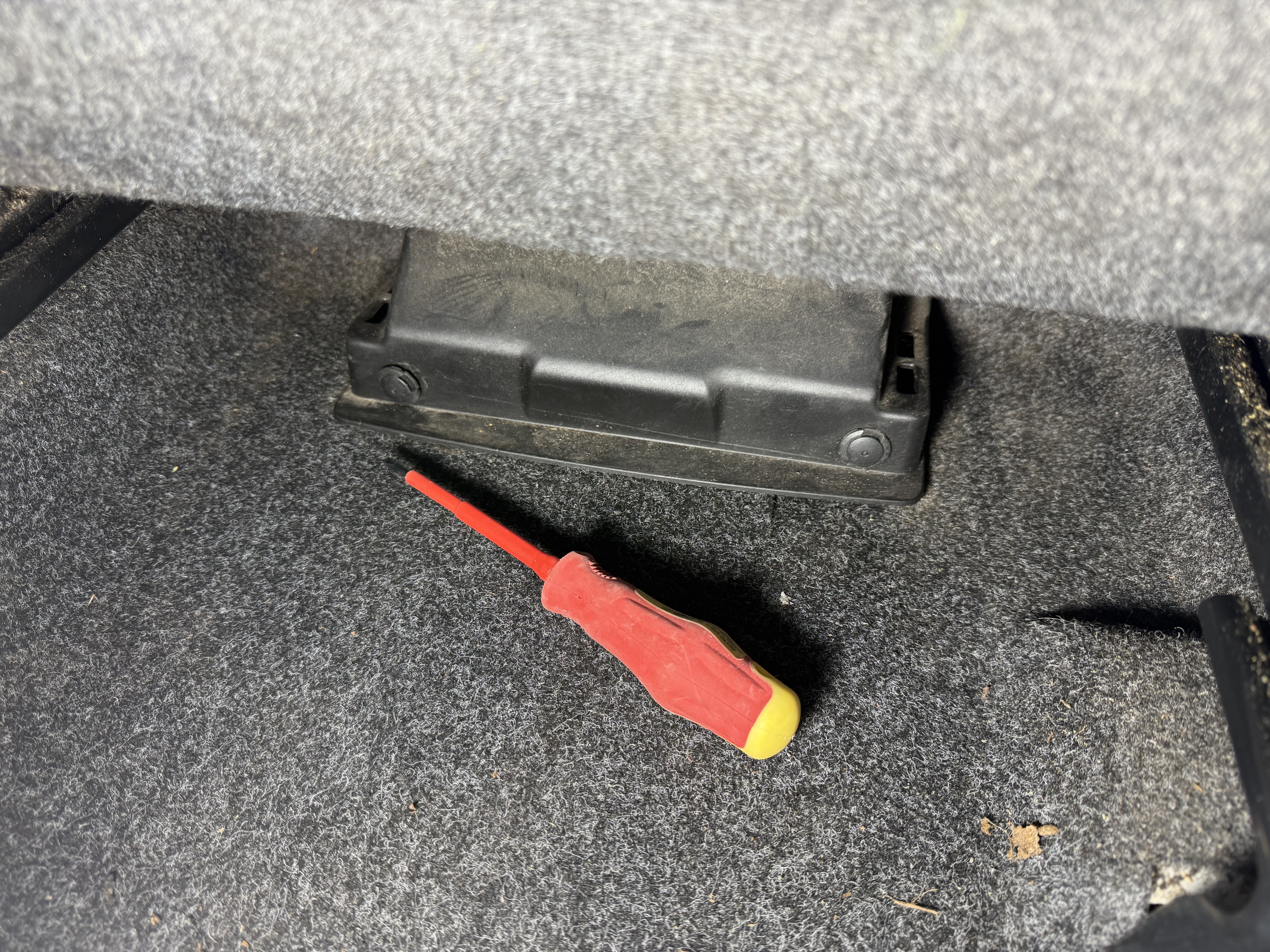

Much easier to get to than on a 500 by the looks of it! Seat still in place. Removed the trim from under the front of the drivers seat (pull out 2 x plugs then pull forward)
Then removed the single plastic retaining peg from the front of the B&M cover and two from the back…

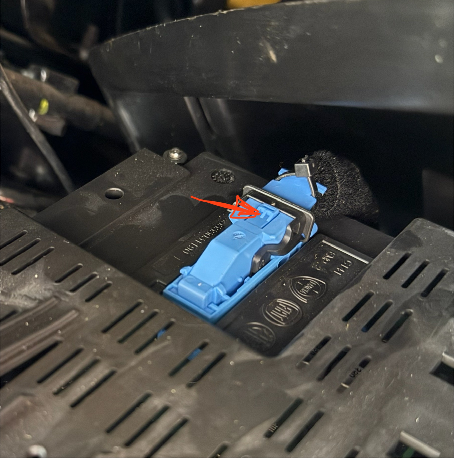

The module is secured by 4 x 8mm nuts. To remove the loom plug, first depress the little tab (arrow on first photo) then pull the black lever back which pulls the plug out (arrow on second photo)
