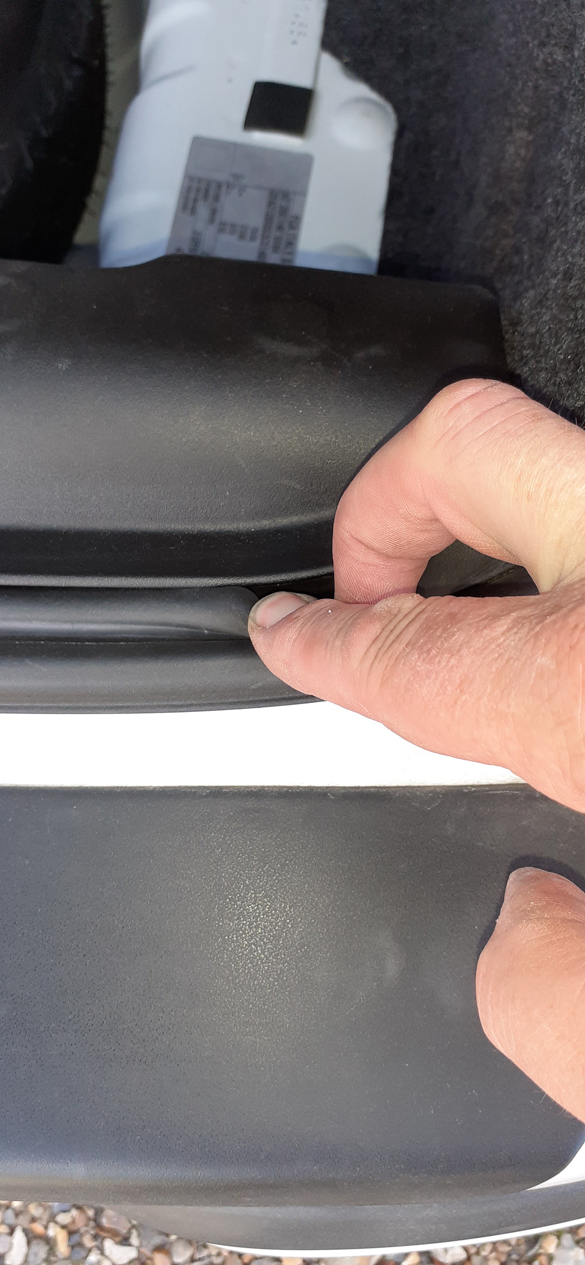

The wheel arch trims make life much harder on the the Cross style bumpers. The edge trims on the bumper need to be removed first to avoid damage. However once these are sorted the bumper is just given a firm tug rearwards once the fixings are removed to get it off. Make sure you place a blanket or old quilt on the floor first to rest it on
There are 16 fixings there are three cross head screws on each side. Two 10mm bolts underneath and four torx bolts two in the tailgate opening and two in the wheel arch. Two further screws each side hold the bumper-edge trims. Each trim has four ratchet type flat tabs that need help to disengage. before pivoting them off.
The bottom 2 screws in the wheel arch liner can easily be seen. Mine came out without the need for removing the wheel first, using a short screw driver. Then undeneath the bumper behind the mid line of the wheel a third one (each side) that can be seen and removed from behind / underneath the car.
Then more difficult to access are the two screws that retain the black trim section that is attached to the bumper.
These are best removed so this trim can be removed before taking off the bumper as the end is FRAGILE and will break othewise.
It can be glued but will not go back properly if it isn't.
On the reverse of this bumper edge trim are three screws also seen / accessed in the wheel arch. You need a mirror to find them easily. You only need to remove the two that are at the ends of the trim. Leave the third (middle) one alone. The trim is then held on by four tabs that push through slots in the bumper. These are a little tricky to release with a flat blade to lever the tabs to the side. The last tab was awkward. The bumper-edge trim then pulls out to the side of the car and off. Warning You need to be aware that it requires two things to extract the trim without breaking it (not counting luck) Where it fits into the back wing / quarter paned it slots in but has a very fragile lip tab end. This requires you to pivot / rotate the trim while using fingers to pull the wing trim (Gently but firmly away from the bodywork slightly to open the gap under teh wing edge trim. Only pull the wing edge trim a tiny fraction (1mm max) to remove the bumper edge trim. The black wheel arch trim is stuck on to the car wing with a quite thick double sided tape so dont over do this pulling as it will not ever go back well afterwards if you do. So hold the bottom of the trim piece with fingers and pull it outward away from the car while pulling / levering the wing end of the arch trim slightly, and the trim will come out with a little GENTLE jiggling. I did not do it that way. I busted both end tabs removing the whole lot in one piece. Thankfully Easy Fix black plastic glue came to the rescue.as these tabs are required to hold the whole thing neatly in place. Subsequent conversation with my local dealer reveals they pull them off and break the tab / tangs most times too. Get your "Easy Fix" glue from Ebay first. (The dealer uses it too.)
Easy fix two part glue. Even in the wheel arch gluing a tiny break in a little piece of the bumper it had held 5 years since the towbar was fitted, so this stuff is GOOD. But better to avoid breaking this trim tab if possible as the bumper wont fit back without it.
Even if you pull the bumper off and go for repairing the tabs / tangs, to refit it, these trim sections have to be removed to refit tje bumper or breakage WILL occur, so messing about before removal is probably by far the better way.

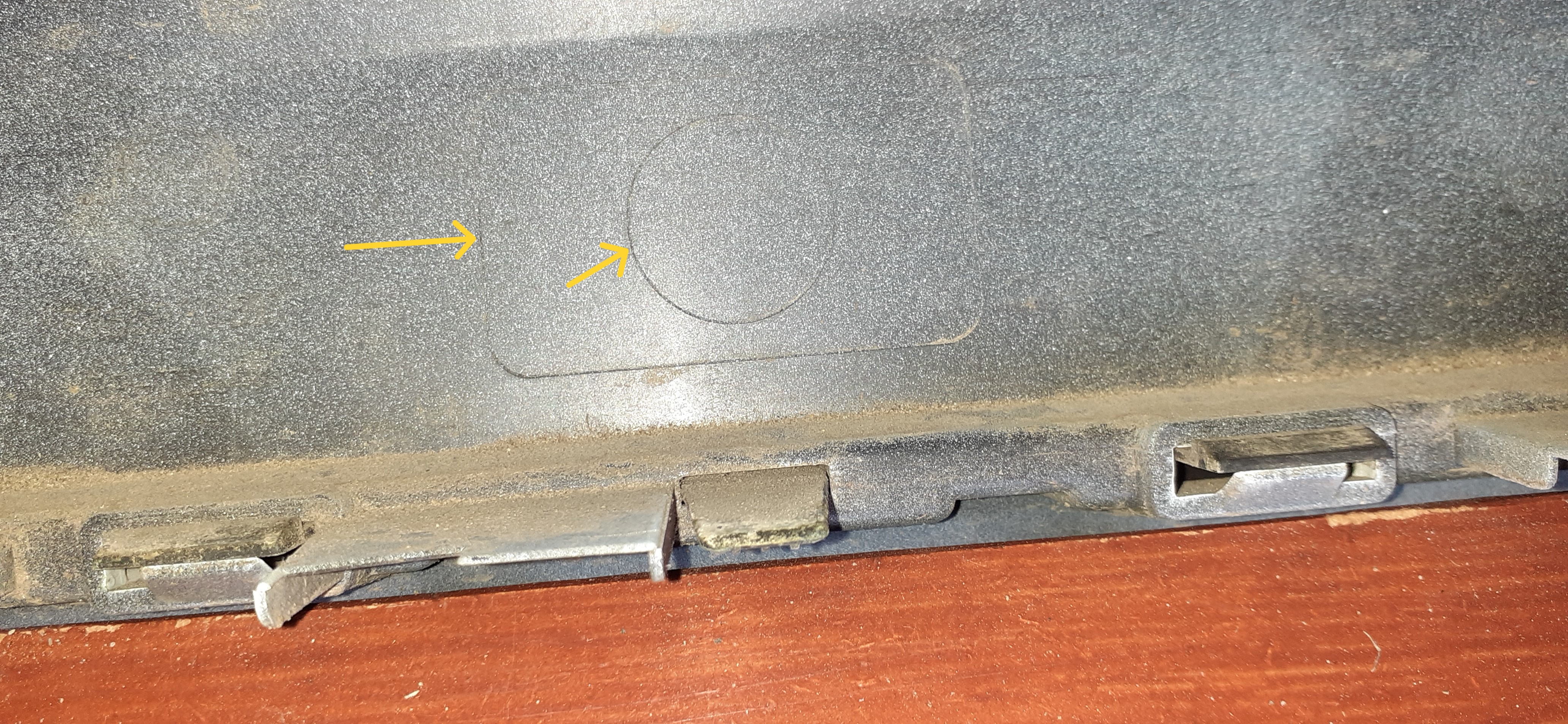

4. Cut the holes
Drilling the holes for the sensors is fairly simple especially if you have a 19mm hole cutter. On the Cross the positions for the factory fitted sensors are nicely marked on the inside of the bumper.
The snag is there are only 3 factory fitted sensors. The accsessori kit has 4 sensors. Good news is the locations for the outer pair which would be difficult to locate accurately are marked, so just mark the centre of the circle and cut your hole. The kit comes with some natty self adhesive templates for accurately drilling the holes so you can place these over the circle (marked inside the bumper) and the dead centre of the hole is easy to locate. A hole cutter will have a nice small pilot drill and a little cutter blade. You need to take great care not to tear the paint as you cut. I always start from the back and finish on the front. Not having a hole cutter I used a stepped drill which is slightly too big at 19.1mm. It did a perfect job which I finished with a conical file to get rid of swarf. The holes were OK at the slight oversize. To fit the inner pair of sensors I marked a line through the middle of the sensor position and maked a point 180mm each side of the sensor to approximate the template for the standard bumper. Fiat stipulate middle sensors must be 360mm apart at the centres. See pic below.
Taking care as far as possible I marked two spots 2cm from the Panel line above the black bumper trim. Triple check this stage to make sure the hole will have sufficient clearance all around to fit the sensor and the washers and lock ring behind on a flat uninterrupted spot on the bumper. The centres of both this pair of sensors must be 360mm apart. In my case I have a tow bar fitted so there is no bumper styrene pad or crash bar, and consequently more space behind the bumper cover. Without this aready being removed holes are needed through the styrene bumper packing piece .
Its obviously vital to ensure that there is sufficient space in the void inside the bumper to accomodate all the sensors and wires before drilling holes!!!. Here the isnstructions show how to cut the packing piece. (see diagram below) The part on the Panda Cross may be different to the picture so may need to hold it up against the bumper and mark the sensor positions and cut openings for the centre sensors.
Measure three time and cut once.

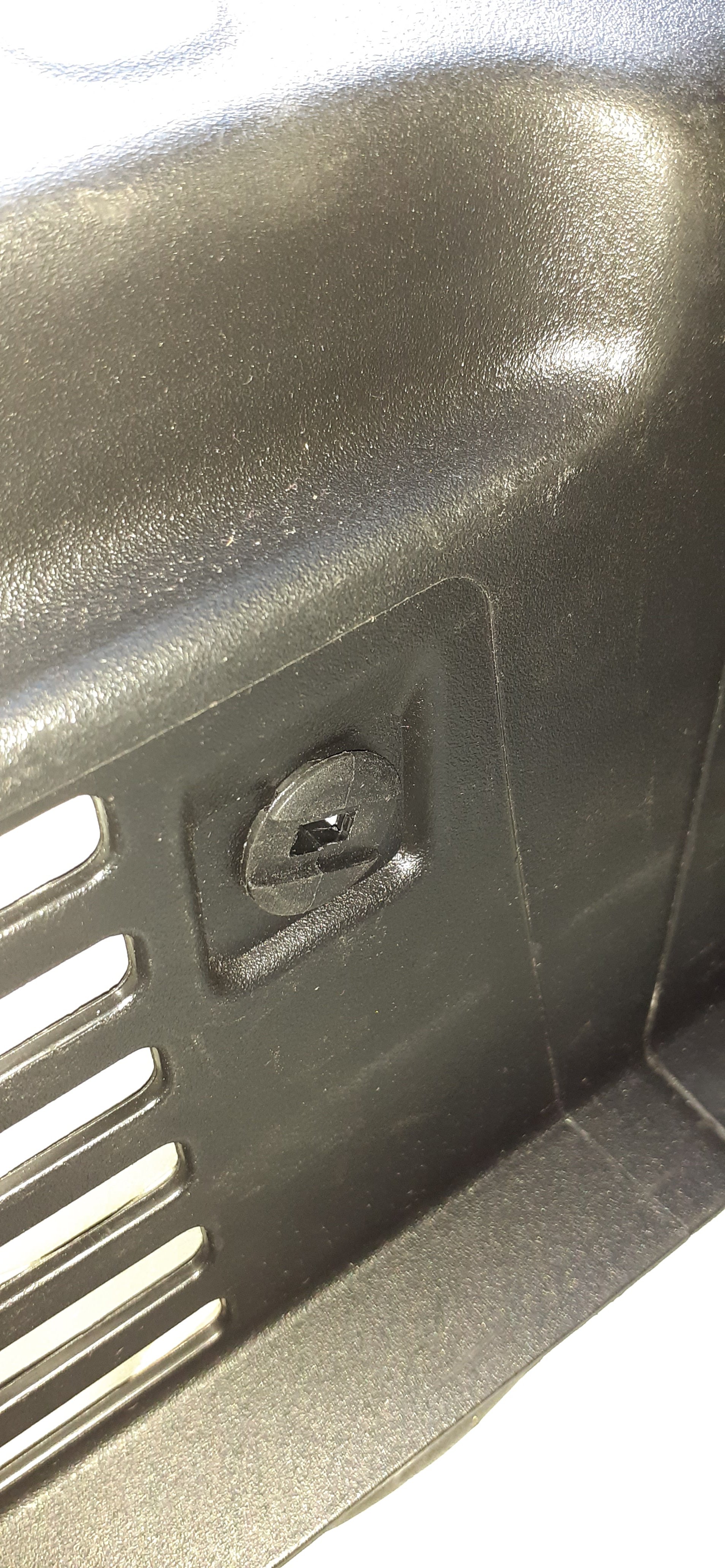

6. Remove boot jamb inner plastic trim. This needs to be removed. Its held inside the boot by 4 plastic trim clips resembling false screws and two muti use plastic rivet types. Remove with care extract the centre pegs and then lever them out forwards. The trim is now further held by 5 trim clips that are reatined in the trim itself. Lift the whole trim upwards and these will come out. some will stay in the trim so make sure not to loose them. Some may stay in the cars panel and need levering out and refitting to the trim before its replaced.
7. Remove Rear shelf side panel.
You need to remove the side panel to fit the reverse buzzer unit. This is held on by two cross head screws. Remove these and then the D pillar trim needs to be loosened to get access behind. It does not need tp be removed. Loosen the left rear pillar trim at the rearmost edge. Ease the tailgate rubber out of the way as you pull the plastic trim panel . The pillar trim is held in place by four push in trim clips, the same as holds the tailgate jamb trim removed earlier. Again watch in case they fall out. They may come out with the trim or stay in the bodywork. They need to be removed and placed back on the pillar trim for refitting. Once the shelf side is loose you can see in behind. It has a little box section thats ideal for the buzzer to be mounted in. Clean the dust from the upward facing surface of this box and use the double sided adhesive tape pads supplied to fix the buzzer after you have plugged in the buzzer wire (red plug. Plugs dont come out again so check you have the correct end before plugging in.

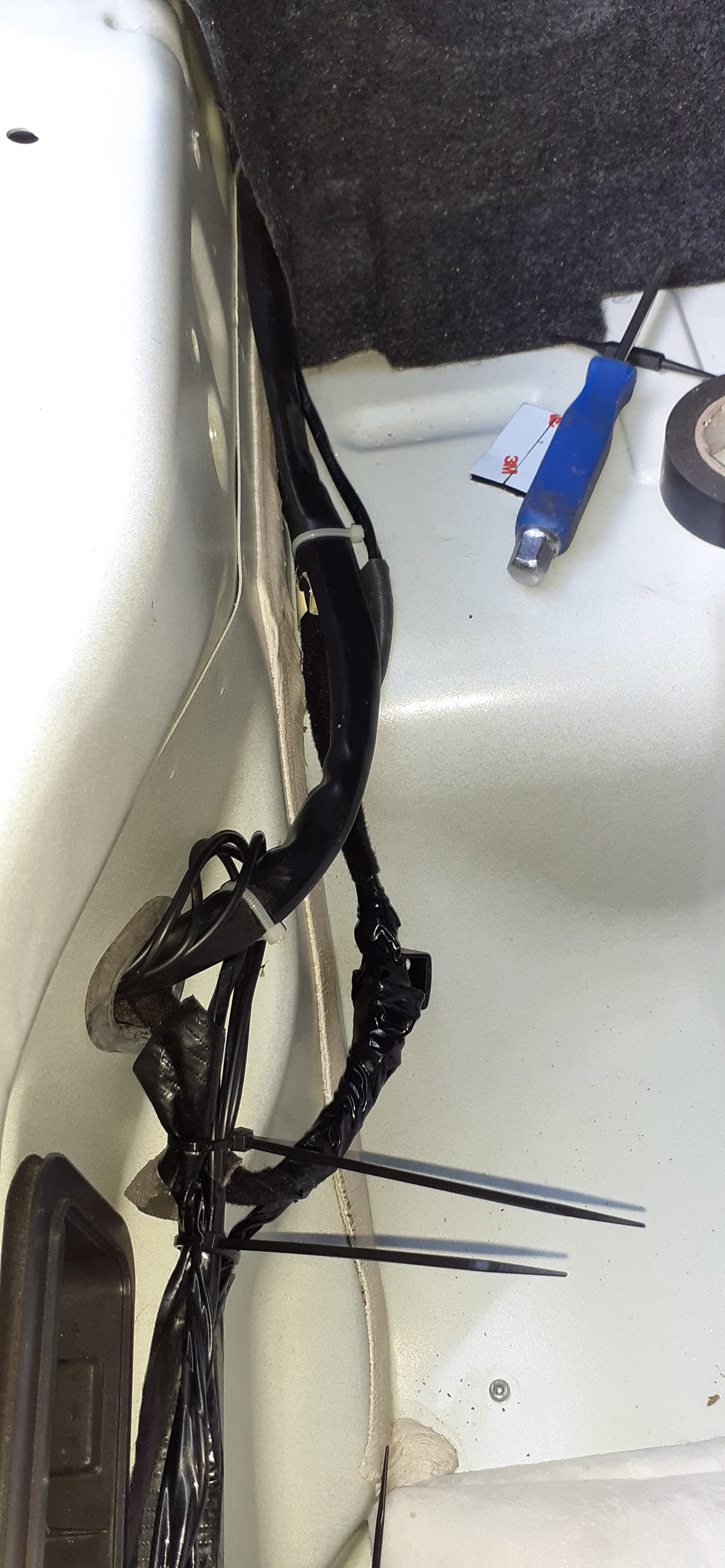

Under the boot trim near the centre you will see the cars wiring loom in a felt wrap. It passes out through a large rubber grommet. You need to identify both of these things.
Cut a slit in the grommet with a sharp knife. Make this about 9mm long. Cars wiring is in the ribbed trunking once out side. See below pic
My sensor wires coming through the grommet next to the towbar 13 core fitted previously (behind the bumper which has been removed) which would normally leave you much more room for the sensor wires but they all fit.
Red arrow - Towbar wiring before RPS fitting , and Blue arrows show bumper bottom fittings. These are nearly identical to the extended brackets on the original crash beam.Yellow arrow is the rear fog wire / bulb.
Unfurl the four sensor wires and straighten them out They have different colour markings / plugs for the different sensor positions the round plugs go on the sensors, and the coloured squarer plugs to the control unit. Feed the small plug of each wire through the grommet and then pull though enough wire to reach the control box in the rear left corner of the boot behind the side carpet trim. Plug the wires onto the control box SEE diagram. I suggest you wrap the wires with insulation tape to make a manageable harness. Fix the harness in place on the bumper. I drilled available plastic tabs and cable tie the hearness to these. Pic below. Plug the sensor wire as in the Fiat cy placinstruction diagram. See a bit further below.
Sensor plugs must be put in the correct slot
Now consider where the surplus wire will be contained. With no crash beam this was easy. I coiled the excess and tied it securely out of harms way. Plug the sensors to the harness as per the diagram instructions. Drawing above (59)

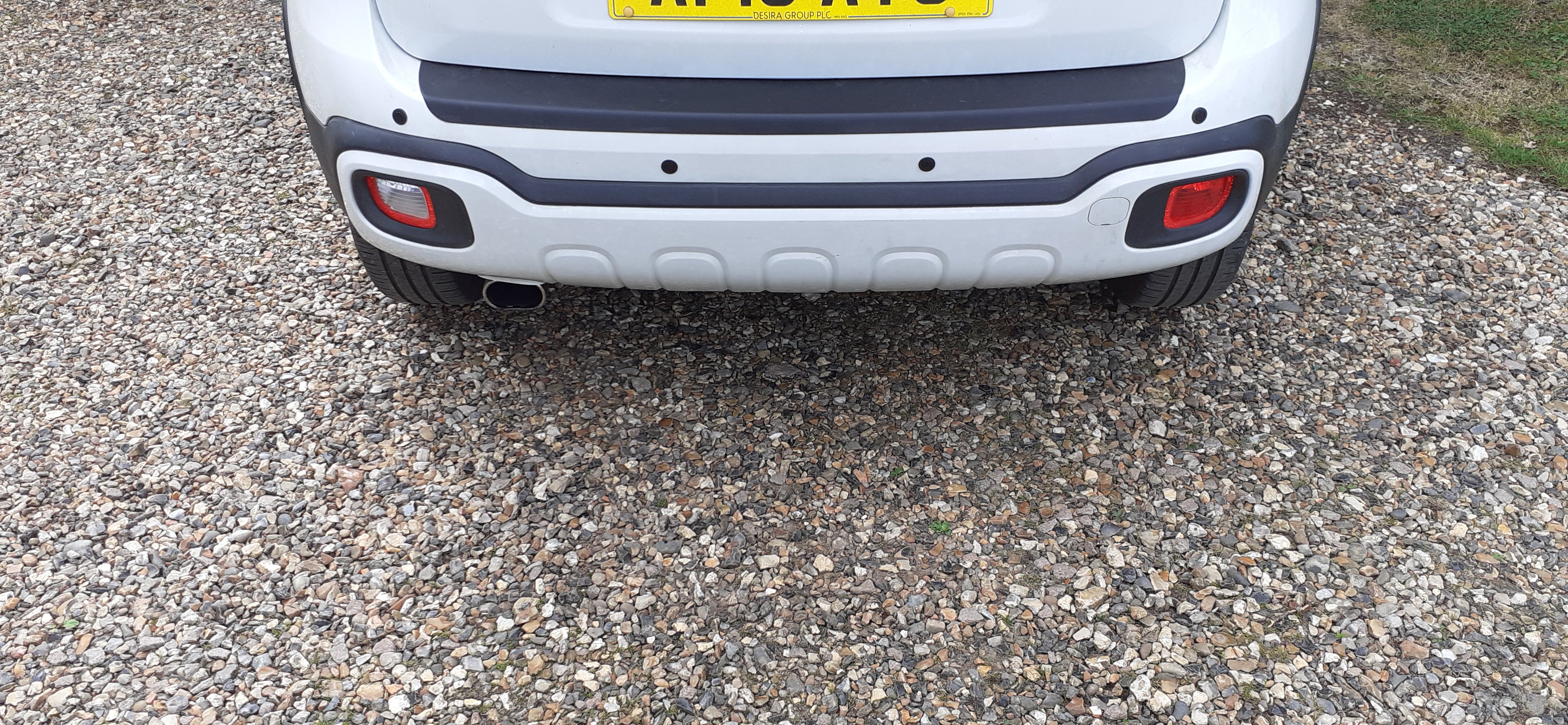

8. Replace the bumper cover.
An assistant will be very helpful. Lift the bumper and offer is up, slot the cover imto the side holder bracket and push it into place. Loosely refit the upper two torx bolts to hold it in place.
Sorry its rotated 90 left in this pic.
With the main bumper cover in place get the wheel arch end trims and replace them on the bumper. Insert the top loop into the gap behind the wing trim. A little outward pressure on the wing arch trim may be needed to get the loops tangs in behind the wing trim BE GENTLE. Then line up and slop the tabs into the slots in the bumper cover and press the trim into place, Refit the two cross head screws that hold it to the bumper from in the wheel arch , Fit the bottom fixing bolts. Get hold of the entire bumper, one side at a time with an arm under and lift it up until the panel gap is tight. Hold it and tighten the top torx bolts. 5ft/lb is plenty, nip up and
DONT overtighten and crush the bumper cover by overdoing it.
Refit the wheel arch tox bolts.
Check the panel gaps and if needed lossen the bumper and lift / re tighten. Tighten the 4 torx bolts but dont over do this. Tighten the lower bolts and refit the 6 cross head screws in and under the wheel arch. Use aluminium or copper based grease ' anti seize on all the bolts and screws before refitting.
Replace the RFL and reversing light light bulb holders. You can reach these under the bumper.

This is meant to represent inside the boot. The grommet on the wire is the big one idetified above .
Right pic above completed wiring
Red arrow is cars harness
Yellow arrow is the parking sensors yellow red and black wires
Orange arrow is my towbar wiring to relay / ssocket
Blue arrow is the wires to the park sensor unit which on m car had to be in the right side off the boot as the left was occupied already by my towing relays. Putting the park sensors on the right side meant I had to lengthen the red wire whch was not long enough to reach across the car. I use one of the other wires that was too long to extend it and soldered the extra wire to facilitate this. Best if possible to put the RPS unit on the left and avoid this hassle.

Finally wrap or tie loose wires neatly, and tie into place with cable ties. I prefer to wrap wires in insualtion tape as it gives a little more protection from abrasion and damge over subsequent years, as well as looking factory fresh.
Finally refit side trim and the tailgate jamb trim and make sure the tailgate seal is not trapped or crushed at the bottom or sides by the refitted trim. It can be fiddly to fiddle the rubber seal out and into place. Recheck that all fittings removed have been replaced and tightened correctly.
Enjoy.
