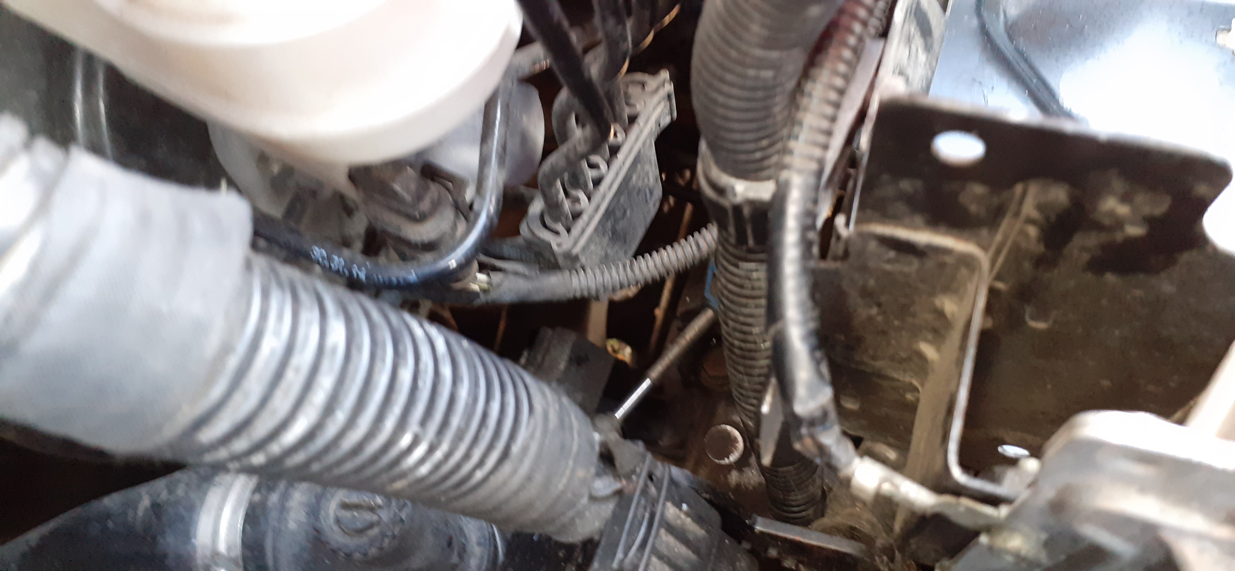

Remove the front wiring harness (fans wires I think) from the tray. This may be gently levered and twisted side to side to free it. There are three other fixings. I use the trim pry bar inserted between the plastic clips and the back battery box while squeezing the retaining lugs together from the front with fine nosed pliers.
Don’t just rip the cable fixings out or you will ruin them. They will fall out easily if you get this right.

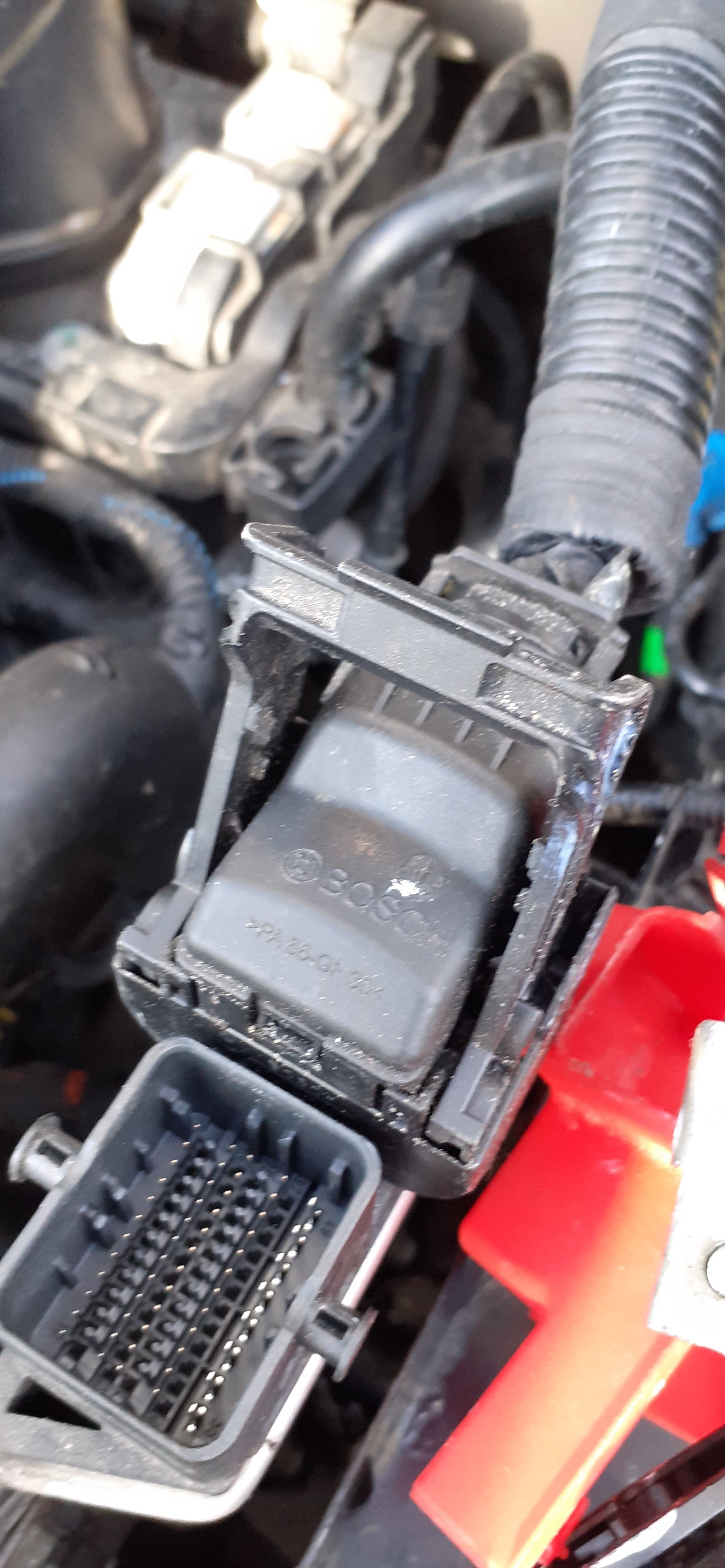

Firmly but gently remove the two ECU wiring plugs. Lift the latches right open and this will ease the plugs put of the sockets. Take care to nurse these.
Don’t bash or bang them the pins are fragile. If you have an electrical contact cleaner spray it would do no harm to clean the pins while they are exposed.
Take care not to bend these pins.

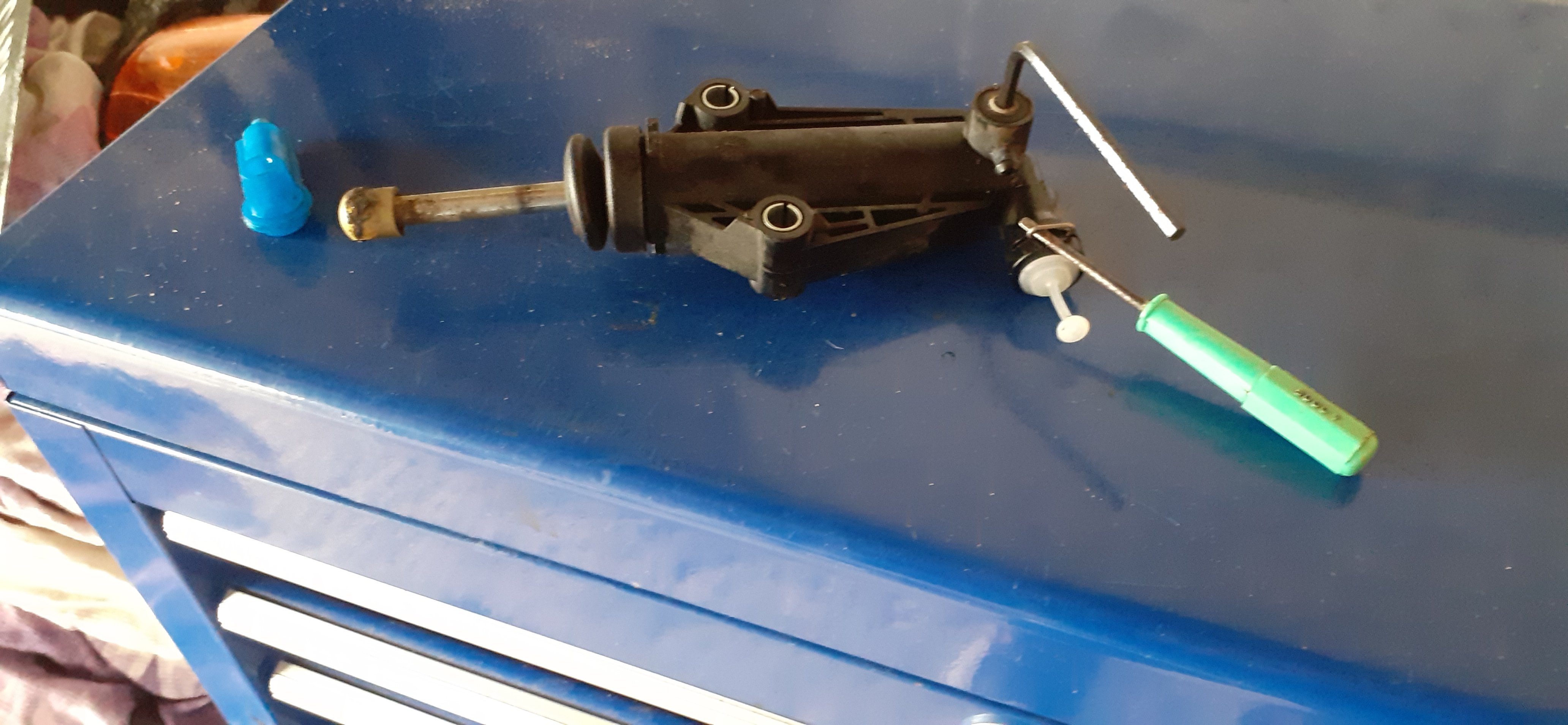

Removing the slave cylinder is easy. The pipe is a push fit. It’s held in place by a spring clip see photo. Lever the clip upward. Push a very small screw driver vertically downwards by the clip and then lever the clip up and remove it.
This photo shows the screwdriver under the clip. But have it vertical and push down to get the clip moving to start with. That’s the Allen key in the bleed screw.

Replace the ECU plugs. Ensure the levers are fully opened. Offer the plug squarely to the socket and gently press down as you flip and close the lock lever. The lever pulls the socket into place and will click as it locks Repeat the second plug.
Lever half closed. Open it right towards you to start the refit.
