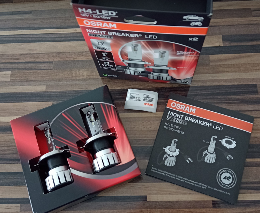

The box contains this:
You might think 'how hard can it be?'. However the innocently looking little pamphlet unfolds to something A3-like with four different scenarios to choose from.
Also, my first thought was 'will they even fit in the reflector housing?' - but that's for you to find out by reading on :)
