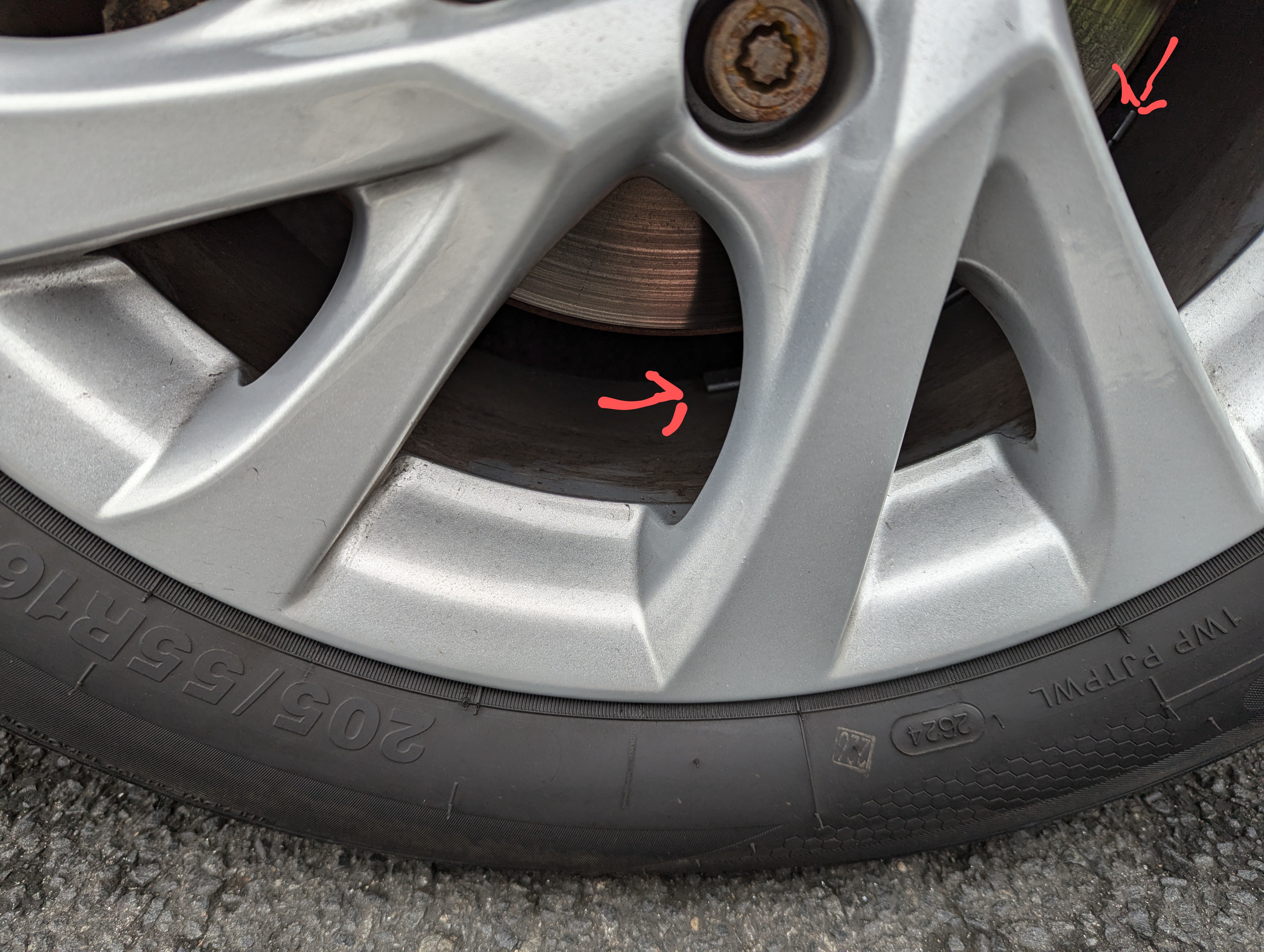

Not sure this will come out in terms of the photo..
Now I know there's a school of thought that says budget tyres...that's what you put on a Toyota but the steering has a slightly strange quality to it at higher speed it's fine but small high frequency vibration.
Good god it's got a full 45 degrees of wheel weights..there's no way these brand new tyres are actually round not too concerned as they will be in the bin shortly but wow who thinks this is good enough to trust long term.

I think the skill is lost, wehn I got my front tyres replaced on the Jeep XJ, one wheel tyre combo was decidedly ‘not right’. I took it back as it was most definitely out of balance at 60-75mph.
As they were going to do it whilst I waited, I asked if I could see the results. I’ve used them for years as they do everything from a scooter to a combine harvester.
On initial removal, and whacking on the balancer, you could see over a third of it was weights and was definitely out of balance still. He said it was probably a dodgy tyre but they had n more in stock, and this being a Friday they weren’t going to get any in from Stapletons till at least Monday. I asked him to hear me out and try something (I’ve mentioned on here before about tyre fitting).
We removed all the weights and rebalanced, he marked the rim and tyre positions and we removed the tyre and set the wheel in hand motion and remarked the rim.
Putting the tyre back on a full 180, from the tyre mark and the second mark on the rim, tried it again, still out, but, only two small weights to rectify…I called that a result and gave him some beer money.
Wehn I was shown how to do wheel tyre combos, the 90’s in the trade at a Fiat dealership, it was Stapletons who came and showed us how to do it properly!

But yeah...I've got to say I've never operated a balancing machine but surely when you're up to say half that many weights you'd be like "maybe there's something else going on here".
Perhaps the wheel has a buckle in it....at which point they'd probably not mention it to me but the fact it largely balanced eventually suggests it's probably not.
Despite the weights the wheel doesn't shake your hands etc there's just a bit of weird feeling hard to quantify to it that isn't there at lower speed. More like white noise than vibration.

It may be "static balance" that is out rather than "dynamic" as you don't feel steering wheel shake.
Especially with that amount of weights.
Static is where if you let the wheel spin freely it would settle at the heaviest position, probably where all those weights are.
It was more common in the past and you could actually see the cars bonnet shaking as the wheel was trying to go up and down.

I'm hoping it's not a buckled wheel though that's pretty unlikely given the lack of visible damage to the wheel...but one side has no wheel weights and the other ALL the wheel weights... although of course if your quality control is that bad you could also accidentally produce a straight tyre.
Very odd indeed, if it needs an alloy a matching one is about 130 quid or I could get mobile service to true it up.
It'll go on the list for after the Citroëns heater and the TPS system on it is fixed.
Although I'm going to straight up ask them of the wheel is bent when it's in for the TPS sensors.
I can't see any weights in the pic, but the concentric lines around the bead look off. They are there as a guide to ensure the tyre is seated properly on the rim. Could be the photo angle, but it looks like the bottom part is closer to the rim. If the tyre is not seated properly, it will effectively be oval, slightly.

In terms of weights..I've added red arrows to the start and end of the continuous line of weights on the inside of the wheel.
That's very observant of you PB, does look like it's not quite seated right doesn't it? and the positioning of the wights, if that bead is not right, would be consistent with it.
