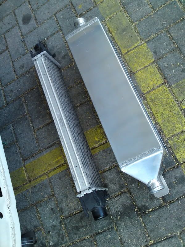

custom exhaust-63mm-without catalyst,new intercooler(bigger 6.4litre),soft piassini,boost controler manual forge,induction kit forge

Here in Brazil, my friend did some upgrades on his Punto T-Jet:
Catalyst off
FMIC (much bigger than OEM)
ECU changes
He got 185hp. Everybody here liked the new performance after this changes.
I guess your Bravo with 192hp must be funny a lot too! (y)
New intercooler
New downpipe
Original Intercooler
Original x Upgrade
Punto T-jet upgrade: 156 whp, 185 hp engine @ 27.5 kg torque
Original T-Jet x Upgraded T-Jet
