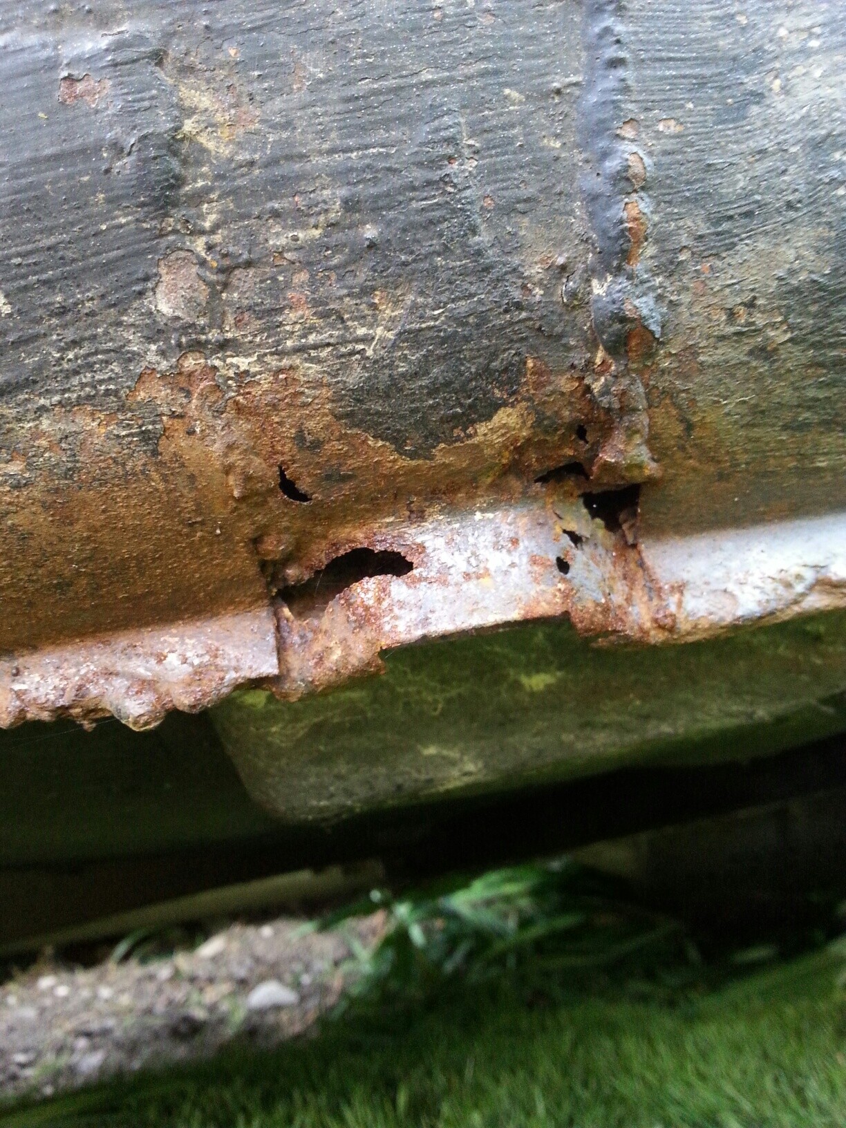

I have now come to the point of tackling the driver's side sill. Since I have a new complete sill in my shed it would seem daft not to put it on. See attached pics of the existing sill. I am sure that once the old sill is off I will find more welding practise behind it!
My question is very straightforward - how do I get the old sill off? It has a couple of patches on it which you can see through the under seal on one of the pics.
I want to get the sill off as neatly as I can obviously.
As usual, any comments gratefully received.

Ideally you need to find the spot welds and drill them out, then where the new sill joins on the wings cut about 15mm below this with a cutting disc. The 15mm is there to allow you to put a step in (joddle) the bodywork, then the new sill will sit flush against this.

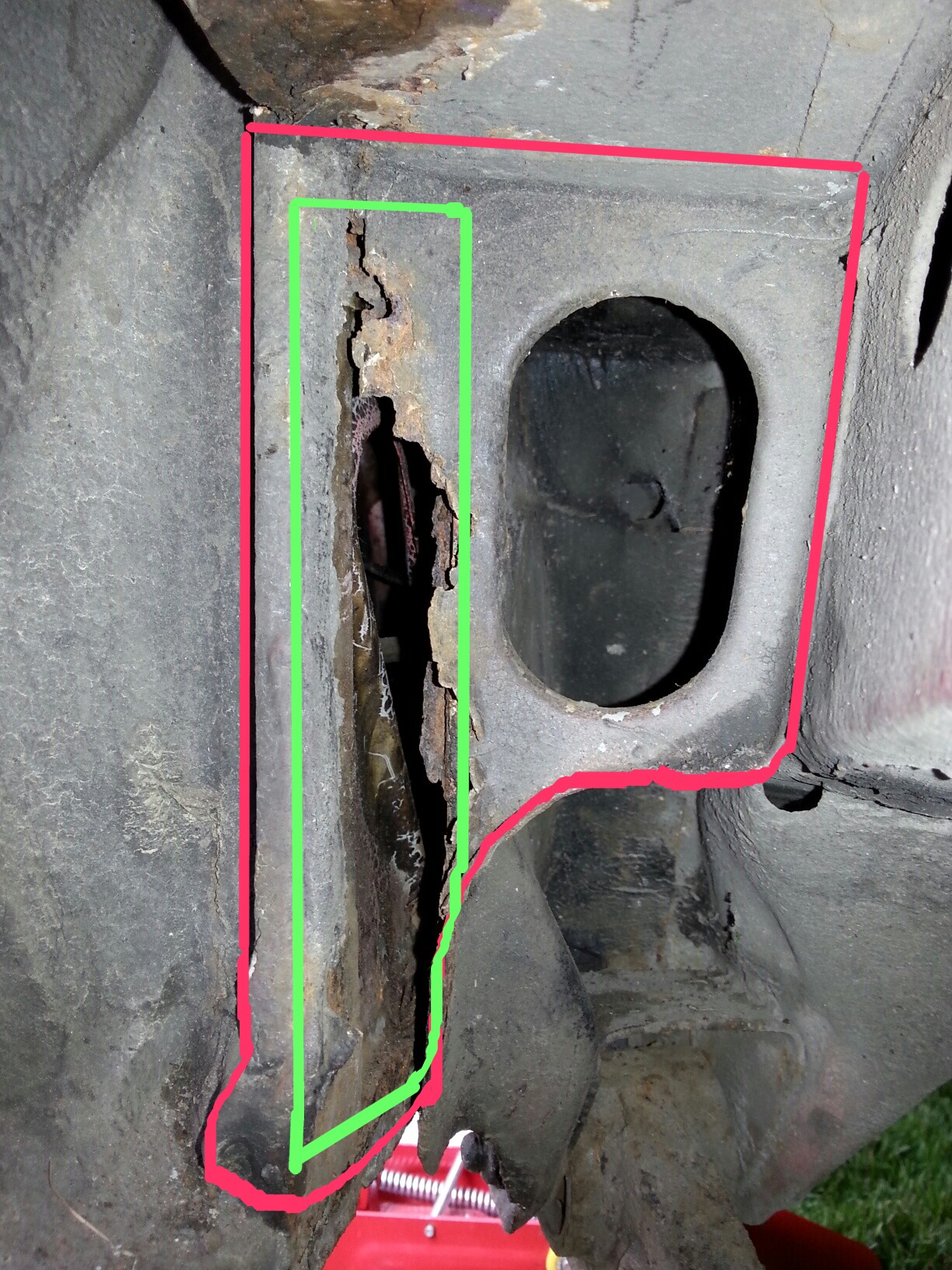

I am not sure how to tackle the under the wheel arch problem. I am not sure that cutting the sill off in front of it will allow me access to that piece that needs repairing.

So, if I make a steel patch to follow the green line on my picture that should be ok I think?
Any advice as always gratefully received.

yeah that will work.
i would have cut out the rust in a square then welded the patch in level with the cut. ;)
thing is with patches, water gets behind the old rusty bit and the new patch.. give it 2 or 3 years and the rust is back again.. the pain is, you have to cut twice as much rust out and contend with old welds.
this part is only spot welded in too. so you could get away with seam welding on the bit with the 0 in it, then just spot welding it to the side of the inner arch.
when i was taking the rear leaf suspension off bex.. that whole thing came along with the rear axle. all the welds had rusted through.
