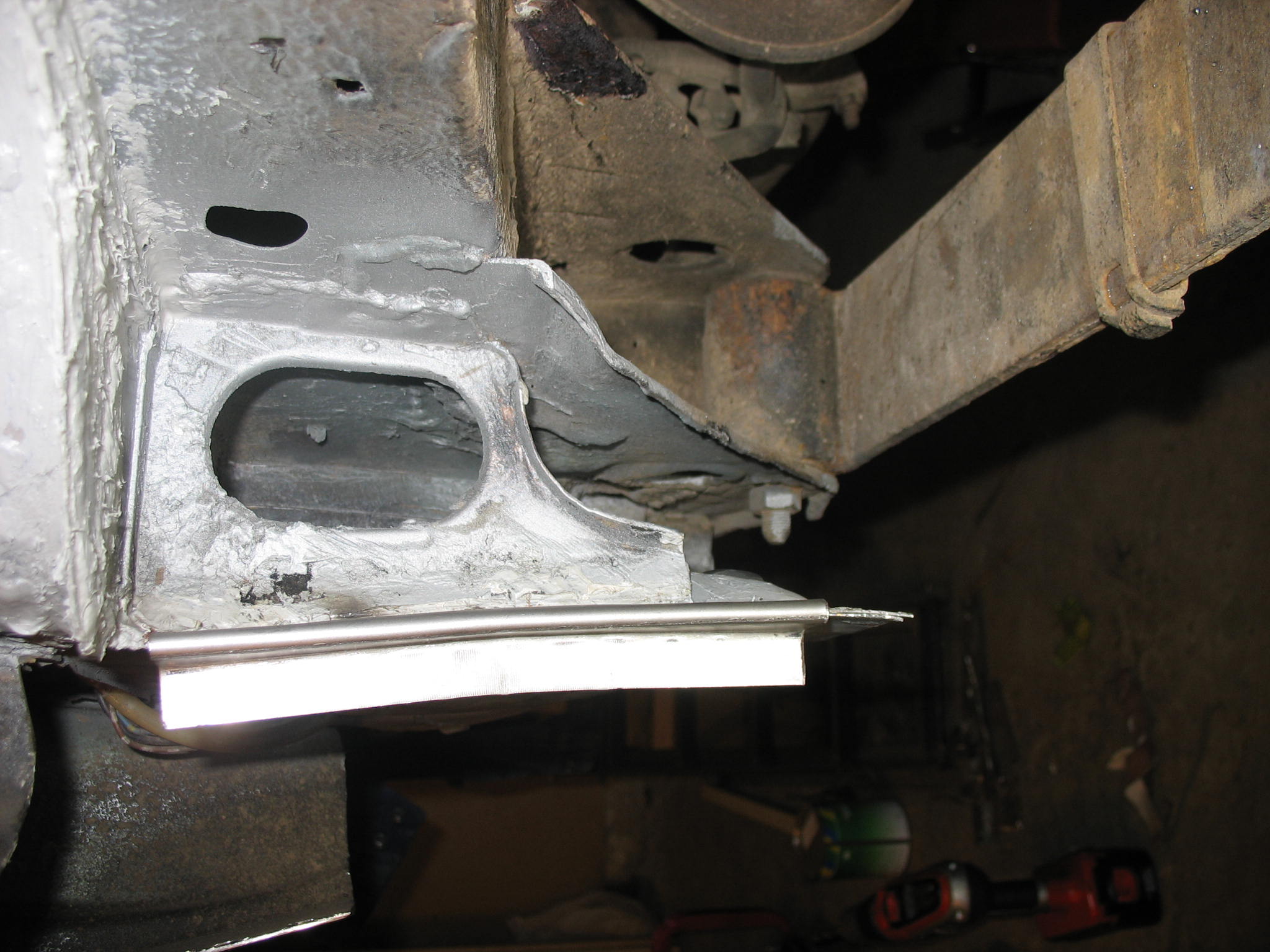

Does anybody have a picture of what this section (see attached) should look like?
I am trying to work out how the bottom section should look.

I have the biggest part to do now, the near side inner and outer sills and the edge of the floor where it meets the inner sill.
Also this section just below the suspension arm mounting (mine is 2wd and doesn't have leaf springs). I can easily see where I need to re-instate the oval section, but the bottom section has disappeared in to rust and dust so i am trying to find a picture of how it should look.
The other side is almost as bad hence not much help.
could bring my panda for you to see in the "metal" if that would help,(y)
Thanks Stiggy. I might just have to take you up on that.
