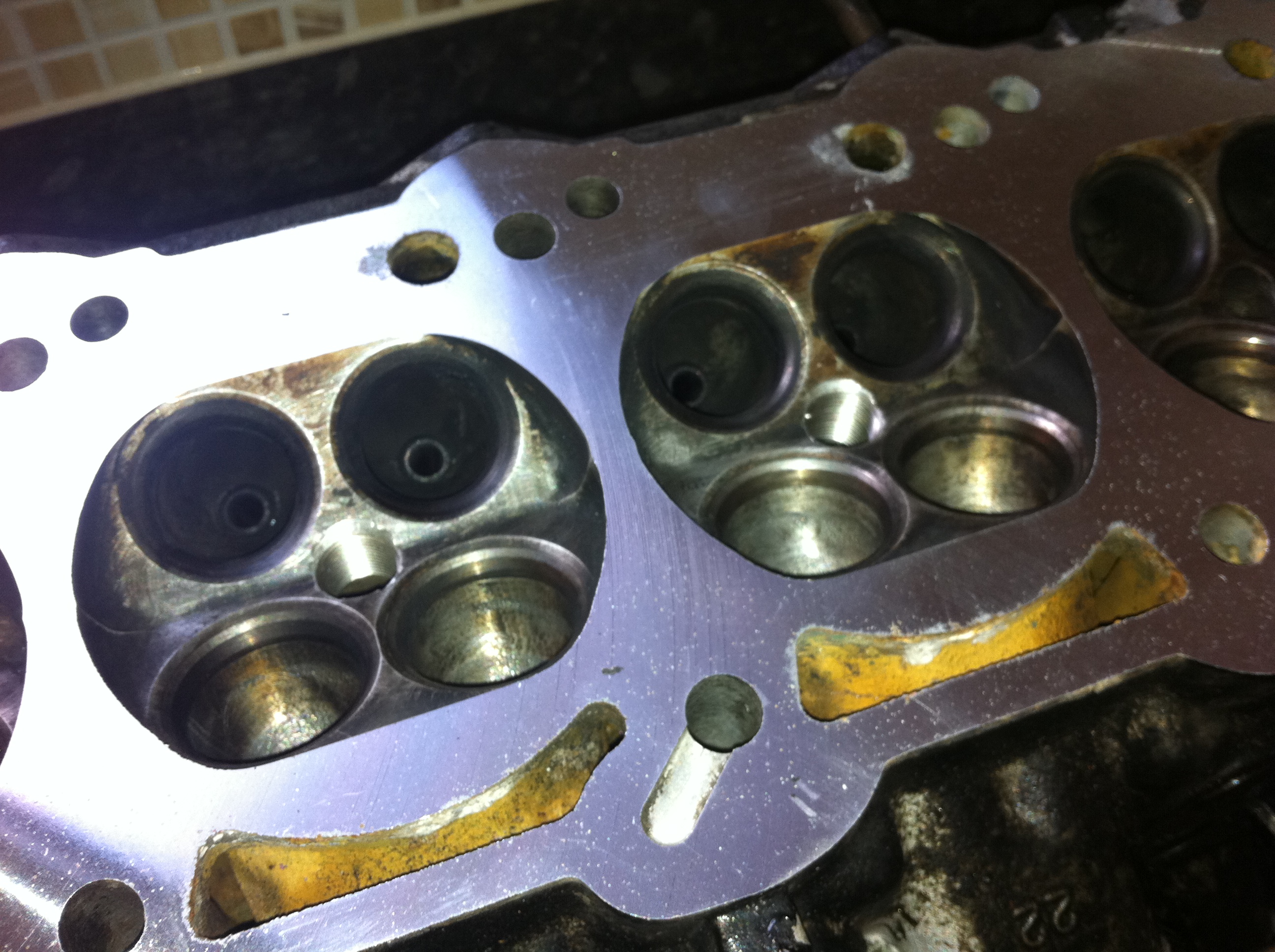

I stripped the engine down, and took it down to my fave machine shop... I know the chap quite well, and he done the work 'off the books'...
I had the following done for £85....
Full head skim, helicoil in two plug holes & acid dip.
Bottom end Honed & acid dipped....
He also got it done in a fast turnaround (under 24 hours)... However im not 100% happy with it, as i dont think he noticed an issue i had with it due to it sitting....
The engine was sat outdoors in the rain (no bonnet on the car, and a cracked inlet)... This caused one of the bores to fill with water, and caused corrosion on the top of the piston, and also on the wall of one of the bores.
I was under the impression with a good hone, this would have removed the 'extra' layer on the bore itself.. However the hone hasnt done anything, so this is around .5mm heigher than the standard wall of the bore...
I really dont want to run it like this as i dont want to damage the top ring on the piston... He says it should be fine due to the second compression ring being under this mark, but after spending around £500 on the rebuild, not including the engine itself, id rather not chance it...
I was thinking sitting with some wire wool trying to clean it off, and then getting that one bore re-honed... however i dont know if this is a safe thing to do?
Anyone got any ideas... Ive been told its fine, but im not so sure.

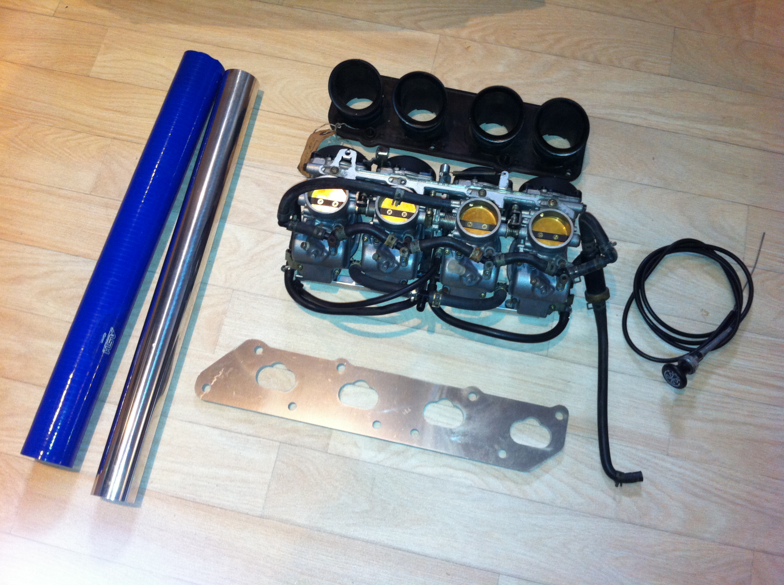

Anyways, enough of the negativity... Here are some other bits ive been getting ready for the sei (and just to add, i may have found a local one... £350...broom yellow lol)...
Most of the alloy has turned up for the inlet manifold... My Mr's dads tig welding it apparently at work (honda) so should turn out quite good... However as long as it works i couldnt care what it looks like lol...
The silicone tube is ready to cut down to attatch between the manifold and carbs :D
Ive also bought a choke cable, so i can actually use the choke thats on the carbs, which stops issues with the bloody cold mornings in jan & feb, when i hopefully have this on the road for... (engine block depending lol)...
Also as you can see, i have some slightly large, but better engine mounts from a VW of some sort... For the pair i paid around £20.. which is a lot cheaper than some standard ones im sure... They have 3 holes in the top, which are threaded, meaning i can hopefully drill the seicento chassis, and bolt through via a welded strengthening plate. Should make the custom mounts fairly easy to make... (famous last words....)

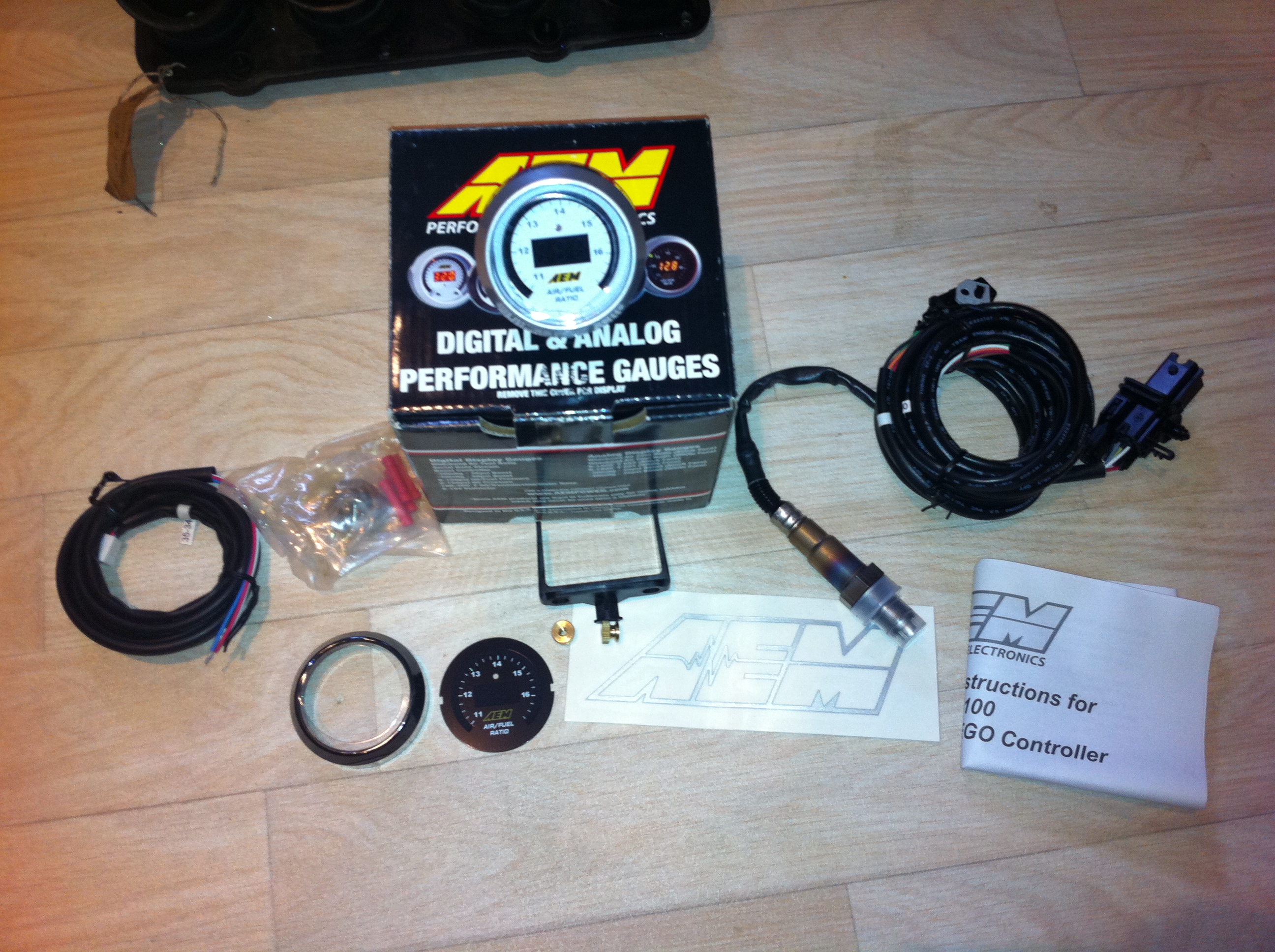

Ive also got my AEM lambda sensor... Great bit of kit!! This ones brand new, and for my xmas from the other half!! I had one in my fiesta turbo, and i couldnt live without the thing, was great to get the fuelling correct, and more importantly... it lit up, flashed and said the word 'POO'!!! Anyway, ive stolen the boss to weld into the downpipe from the box so im not waiting till xmas for it :p
Finally, ive sorted out the plumbing for my bike carbs. (thanks to copying my mates set up thats been removed from his ford zetec). I now know where all the pipes go.. there are two breathers, a pipe in and out for water, and then a single petrol feed... I still need to either buy a bike fuel pump, or a facet solid state pump... I also managed to track down some trumpets from a bike, as you can see in the pic... These need a little adapting, and some holes filling... But i think it will be worthwhile :p
