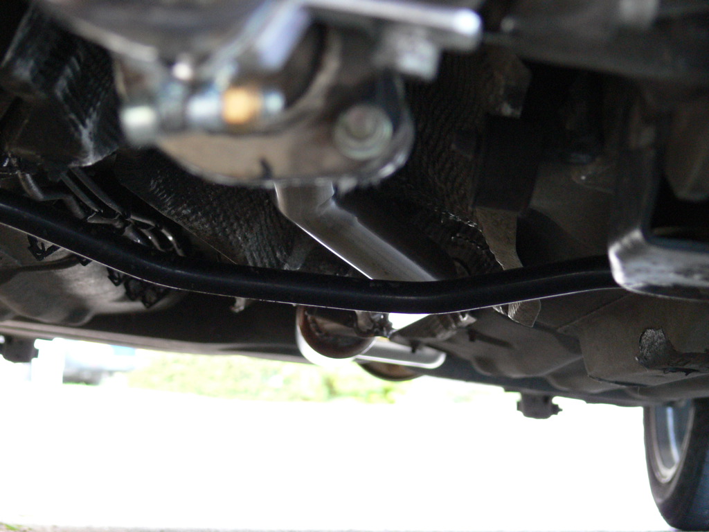

Heres the exhaust from the front:
The back:
Some other shots:
All of those were taken with it tilted up 50% on the kerb so i could actually see under lol.

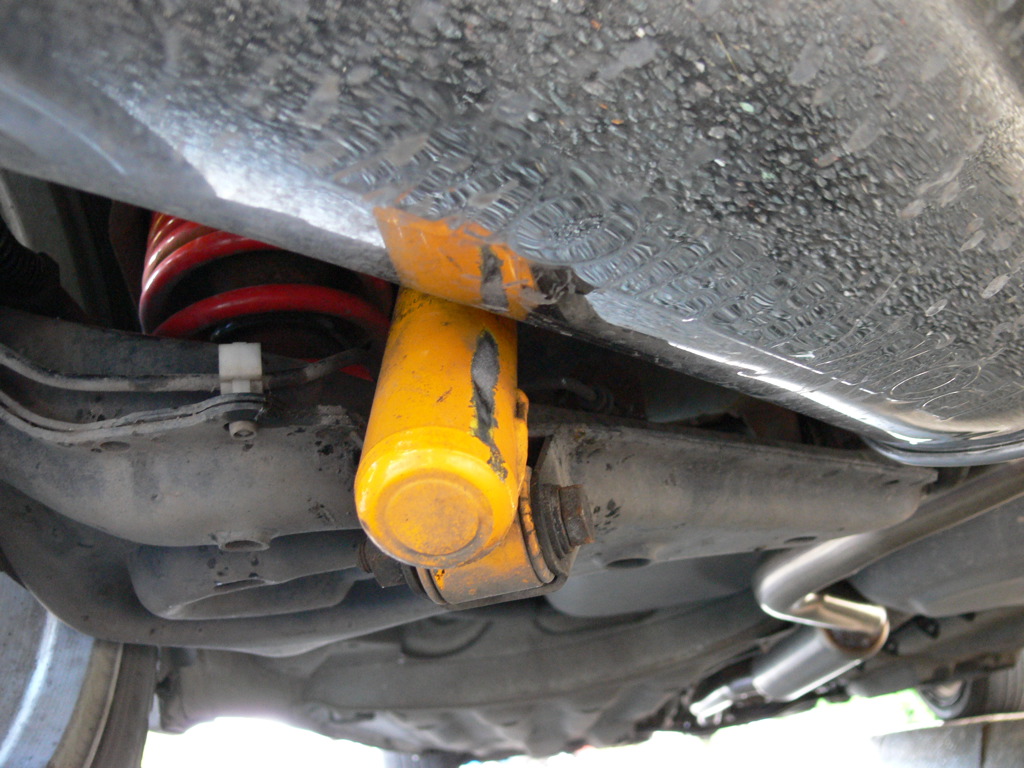

The bad though, Since fitted I have had a knock sometimes, but thought it was normal. When I took a rear passenger, it was 10x worse and I turned back to home because of it.
Below is the reason why :(
the rear box is knocking and wearing away the suspension strut! So I'll have to ring up and see what they say tomorrow.
Otherwise its still good and rapid!

Just hope those struts hav thick walls, as it is actually scratching into it, ite indented :eek:
Hopefully it will all be fine, and some paint will sort the strut out, but I was a little bit annoyed. Will have to see how its remedied, but it does mean a day off work, or a long cylce for half a day :(

Went under and nearly got stuck when taking pics lol
One hanger is no longer used after they fitted it....Would make me panic, but that's when the original mpi manifold WASN'T bolted to the engine/gb.
Now the supersprint mounts to the gearbox bracket, there is really no need for the hanger right up front.
The other hangers seem ok. One seems to be doing very little, no stress on it, but it does feel solid and, by hand, hardly moves.
I will prob replace the hanger mount's for poly ones soon anyway.

Well booked it back in today, took time off work to get there and back. Luckily my mother works over the street so i borrowed her car to get back to Nuneaton to work.
Came over this evening after it was fixed and adjusted.... it was exactly the same! They seemed a bit annoyed but finally decided to take it into a bay and i showed them what was happening. They said they hadn't noticed that, and on the test drive there was no knocking again.....that's because when i got there my rag was still tied to the strut :eek:
I can't afford to take any more time off now, so its going to have to wait till saturday :( I'll have to cut up a coke can to protect the damper a bit more.
