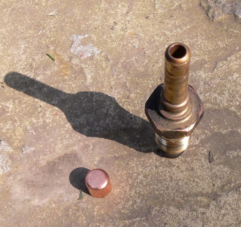

Here is the temperature adapter I bought, it converts the 1/8 NPT temperature sender to another thread.
I measured the plug I had next to the thermostat, and luckily got it right. It's a 1/8 npt to 5/8 unf thread. This allows me to measure the coolant temperature in the head, next to the thermostat. £10 from demon tweaks but seemed more elegant and reliable that tapping the thermostat.
