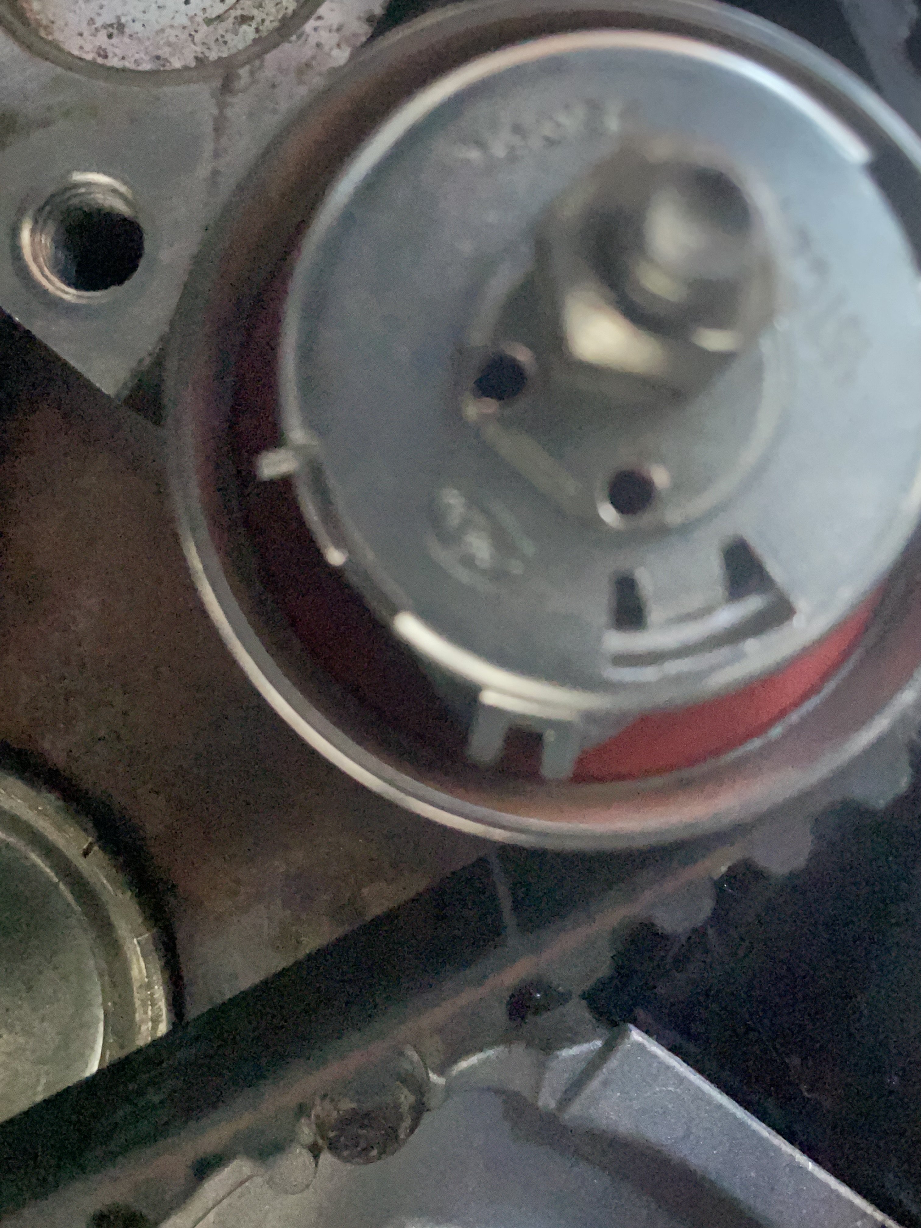

Thanks everyone, I think I got it right then🥳 the only variation I can think is I’ve taken the cam out with pulley still attached out for machining, will I have to take the pulley off to refit at some stage? 😬

You've got the timing tools haven't you? So I'd be leaving it alone until I'd built it all back together, Fit the timing tools and then the belt - remembering you'll need to turn the cam slightly clockwise (usually about half a tooth, to get the teeth to mesh so the cam locking tool will need to be removed to do this. Once the belt is fitted don't put the cam timing bar back in but tighten the belt adjuster bearing (crank locking tool still in place - you'll see the top pulley turn just a little anticlockwise as the belt tension goes on, and now, if you've reassembled it correctly and the cam pulley was correctly timed to the shaft in the first place (which, in my experience, they nearly always are) you should be able to slip the cam locking tool back into it's slot in the end of the camshaft. So, to answer your question directly, No, I don't think you'll have to slacken that pulley bolt - unless the pulley was incorrectly aligned befor you started. The crank locking tool is in place during all of this and only gets removed when you're ready to turn the engine by hand to check for resistance before turning the starter key.
