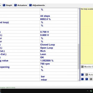

I would start by looking at the idle steps heres working car with 44 steps

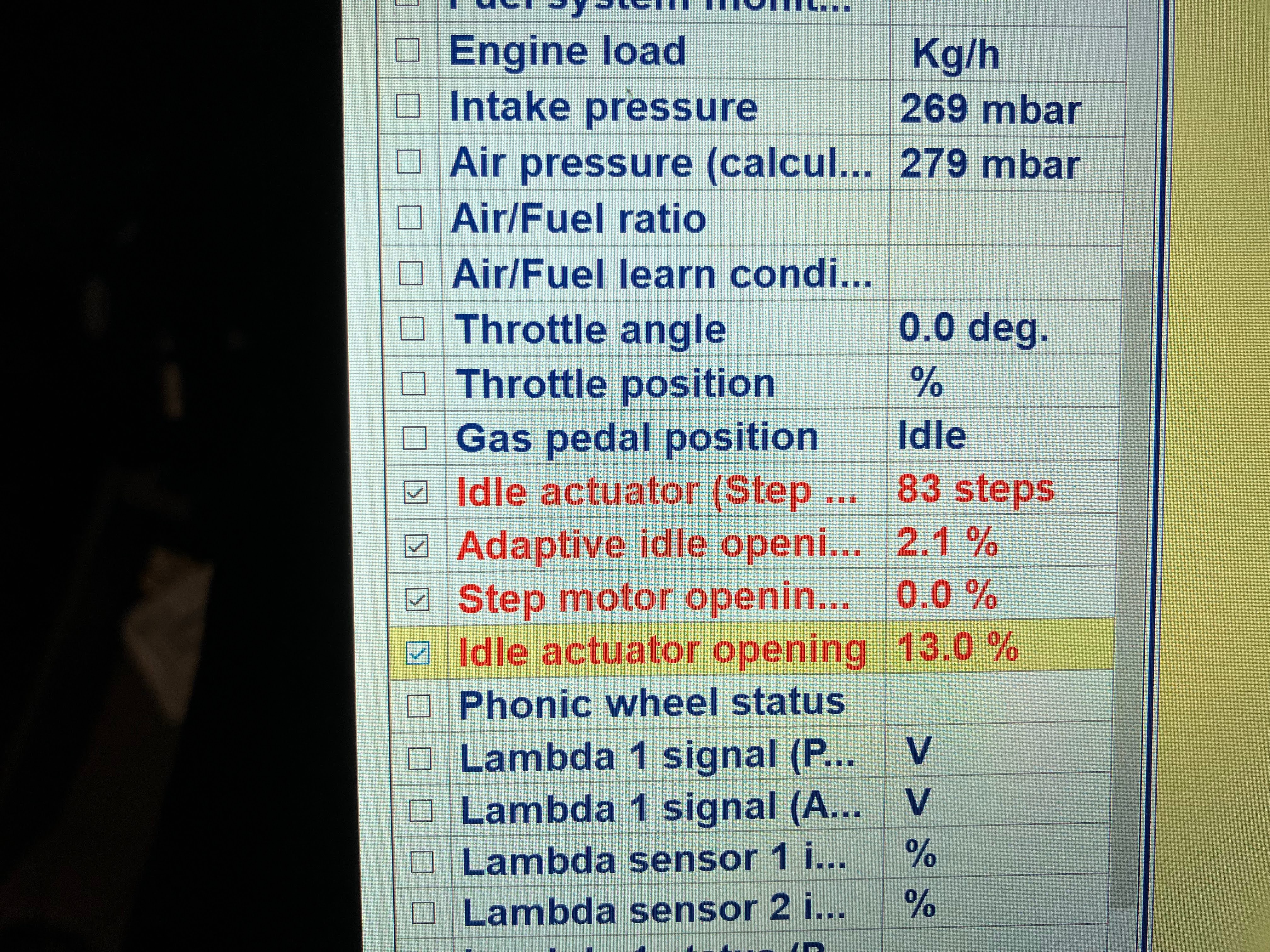

And a faulty car, that stalls if you operate the front windows
83 steps

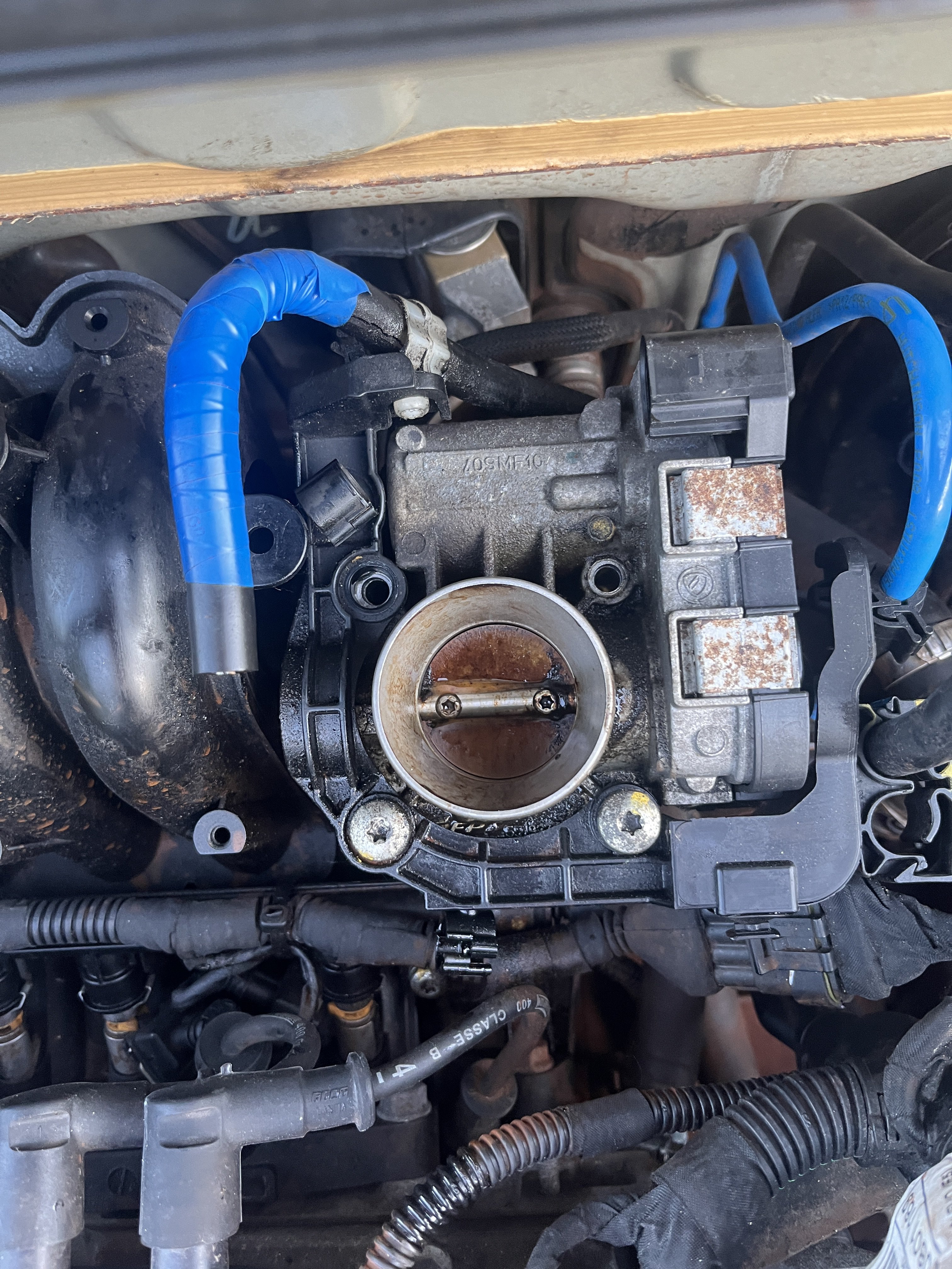

That's a flyby wire throttle
Not cable
No idle control valve

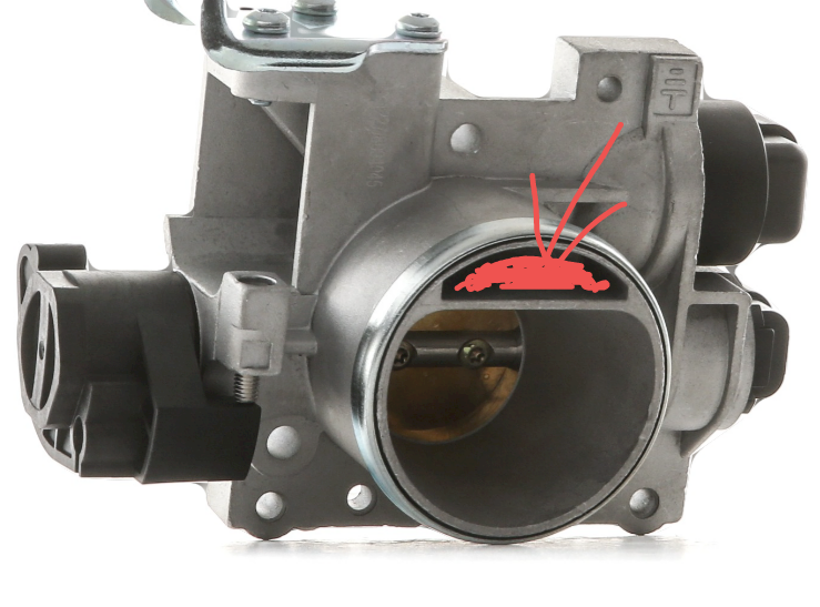

Engine off, ignition off
put some brake/carb cleaner on a rag, don't spray it inside
Push the butterfly valve open and clean the sides where the valve sits
Looks like it's been cleaned recently
I tried cleaning it a little I think
I might just remove the throttle body and clean it
I get scared I’ll drop something down there lol
Doesn't have to be perfect
I don't think it going to help
It more for versions with cable throttles
The valve just has to be able to shut fully
