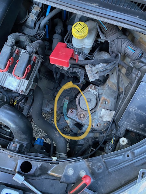

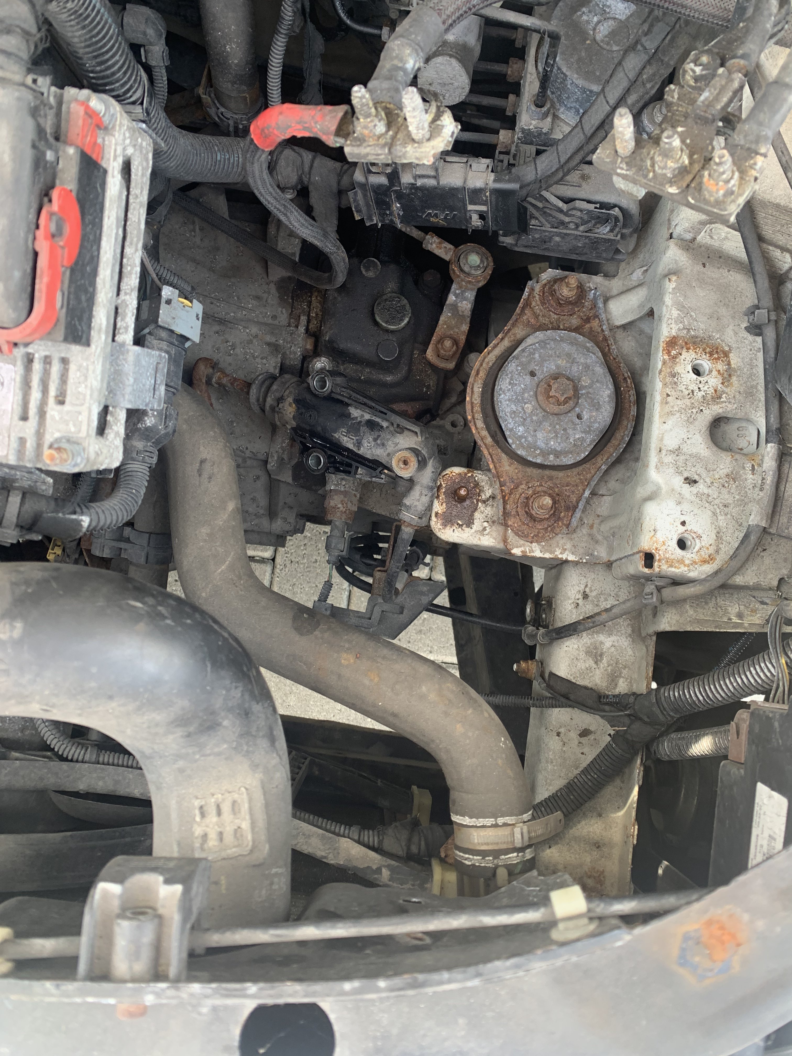

Ours is a 09 plate you can just see the battery on the right

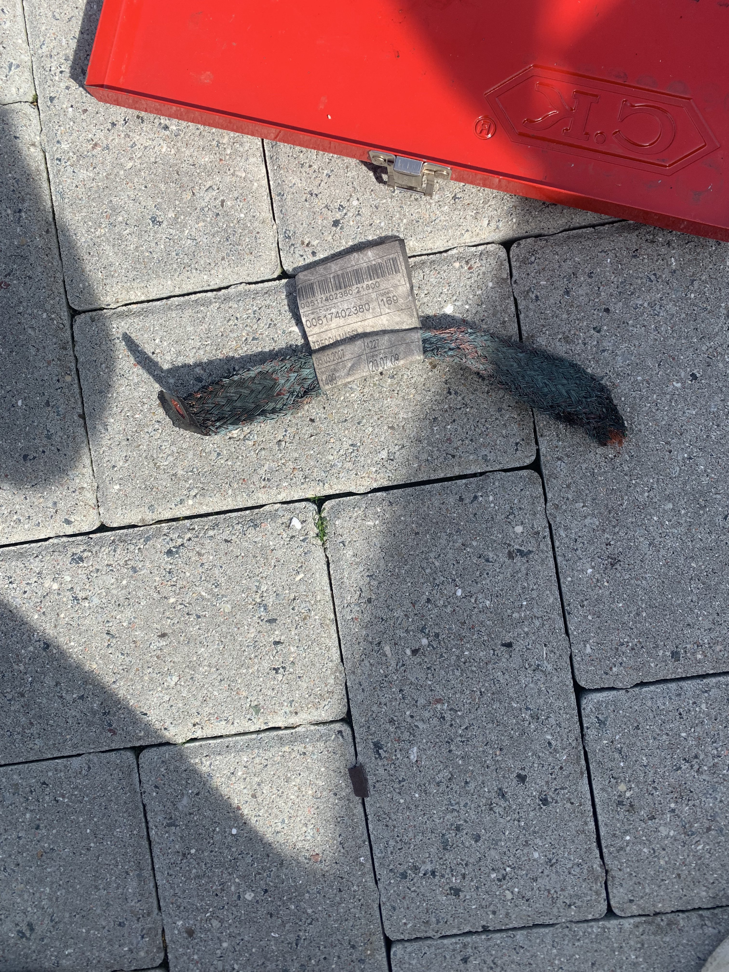

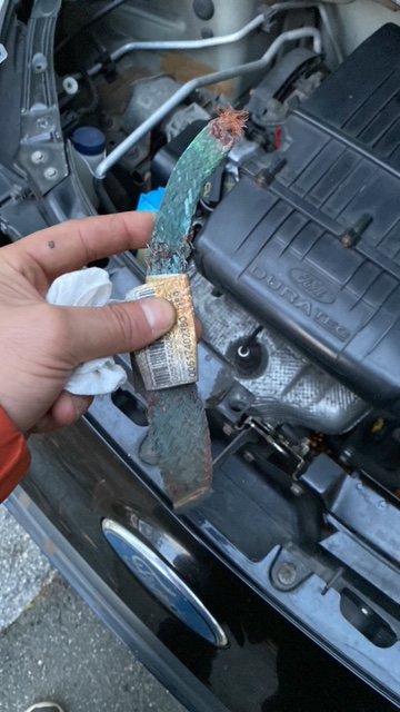

Guys, I have done it!! I can’t believe it worked. Thankyou all so much for your help and advice! You’ve saved me hundreds and I’ve got my car back on the road now!!!
I take it you got the nut off and fixed the strap, and all good? Clutch OK?
Keep an eye on the rear tailgate electrics the wiring is known to fail.

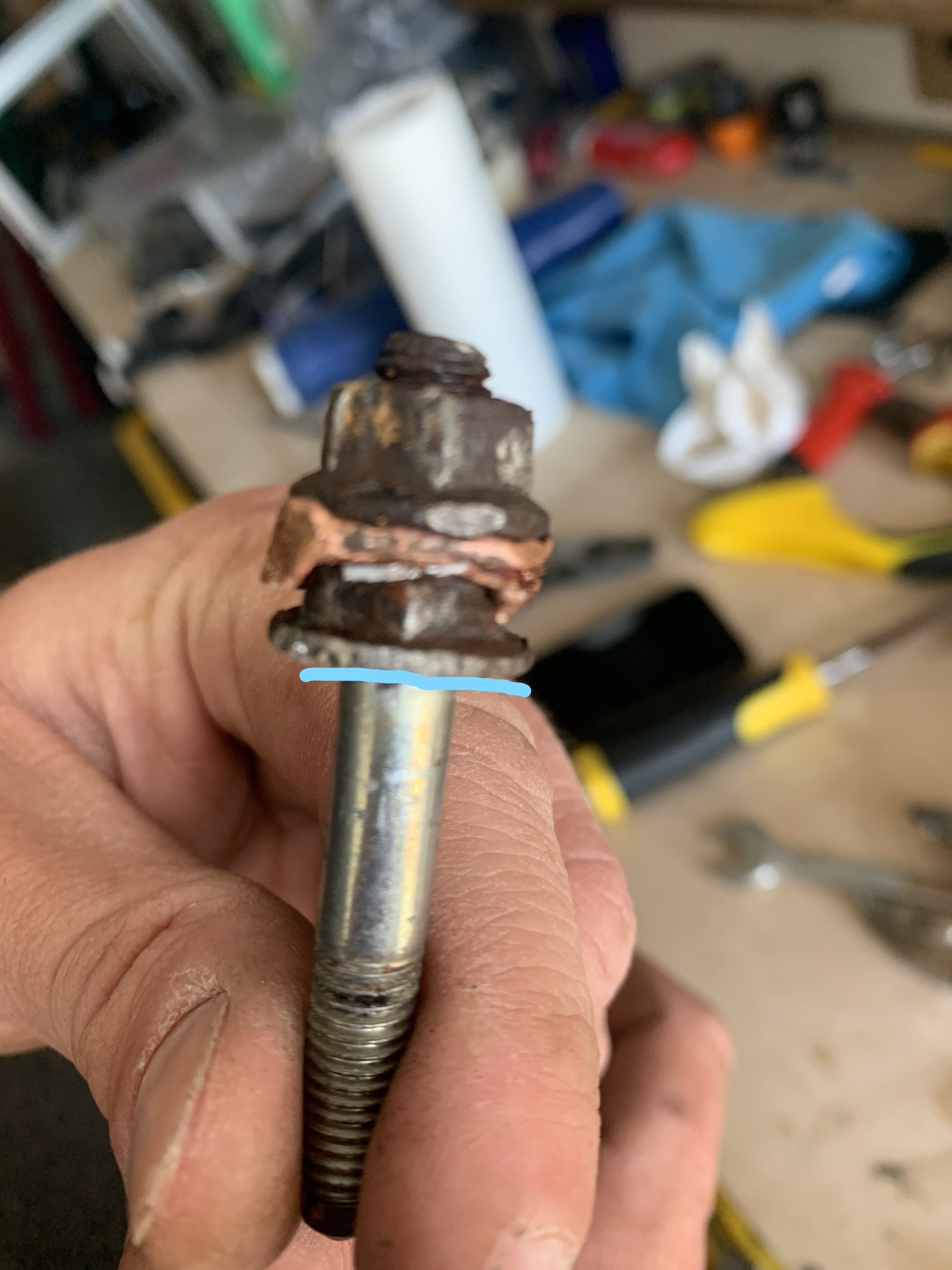

I have failed at the last hurdle. The rusting bolt.
Hello guys
I am writing from Germany.I have a Ford Ka 1.2.I had the same problem.And now I am triying to fix it.I will fix it because of you all. Thank you very much.
I just want to ask that where can i find this screw ? I can't separate it. or Can i put earth strap to under nut ?
Thank you

Yes you can use another nut, but first heat it up using a gas torch hold in a vice and use two spanners it will come apart, you may need to heat it until quite red hot so a shield maybe needed to concentrate the heat?

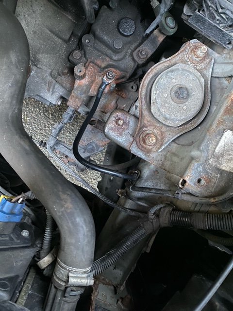

Hello,
I fixed problem with new cable.Thank you very much to all.It was a great feeling to start the car after my own repair.
but I could not seperate nut I have not gas torch or vice.I just put cable under the nut.
thanks millon times.
