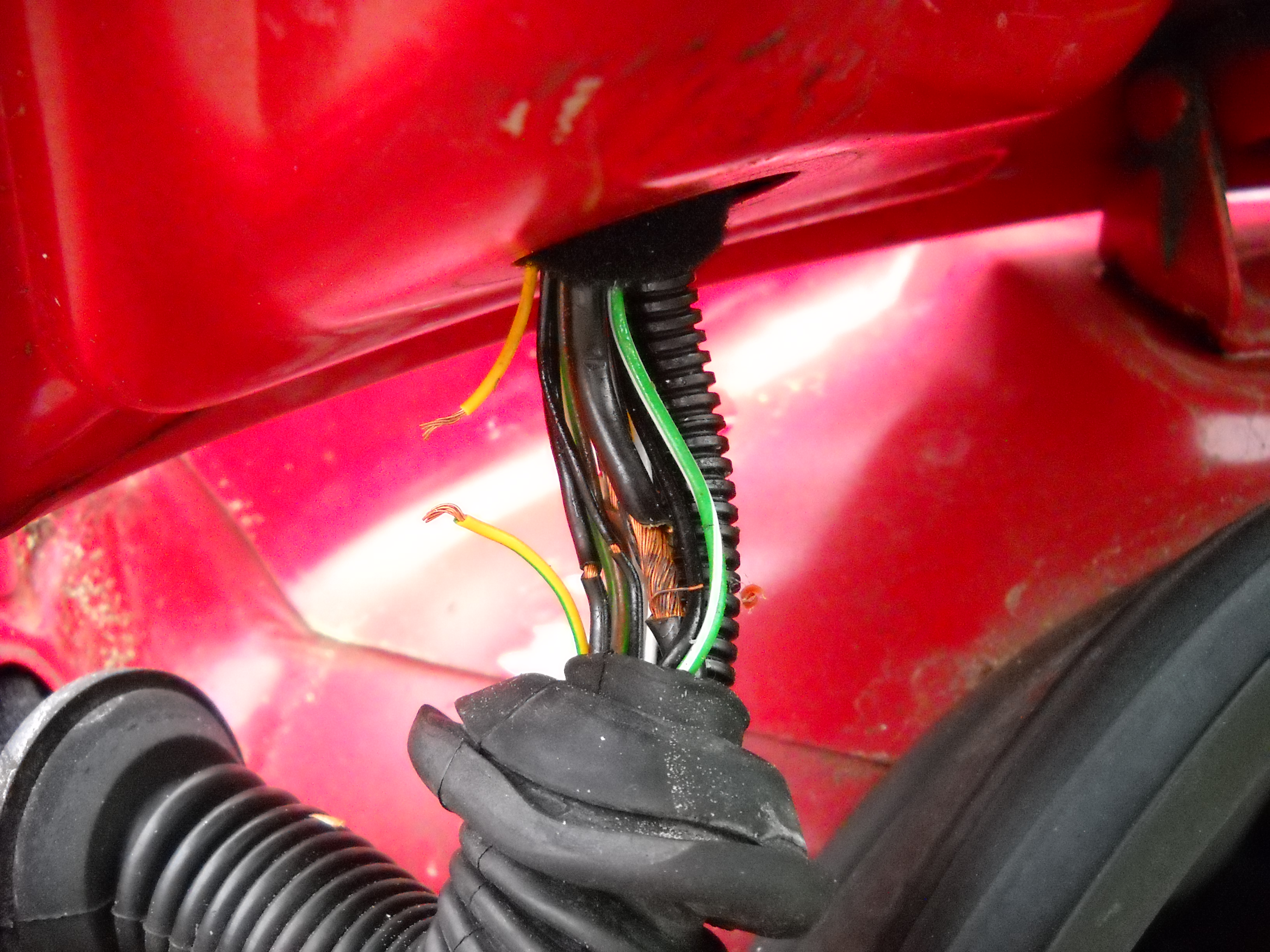

Check the wiring loom where it enters the rear hatch; this is a common failure point and often gives these exact symptoms; a short at this point can fry the airbag ECU.
If you've not owned the car from new, it could have been repaired before; we're seeing a lot of second and even third failures following substandard repairs.

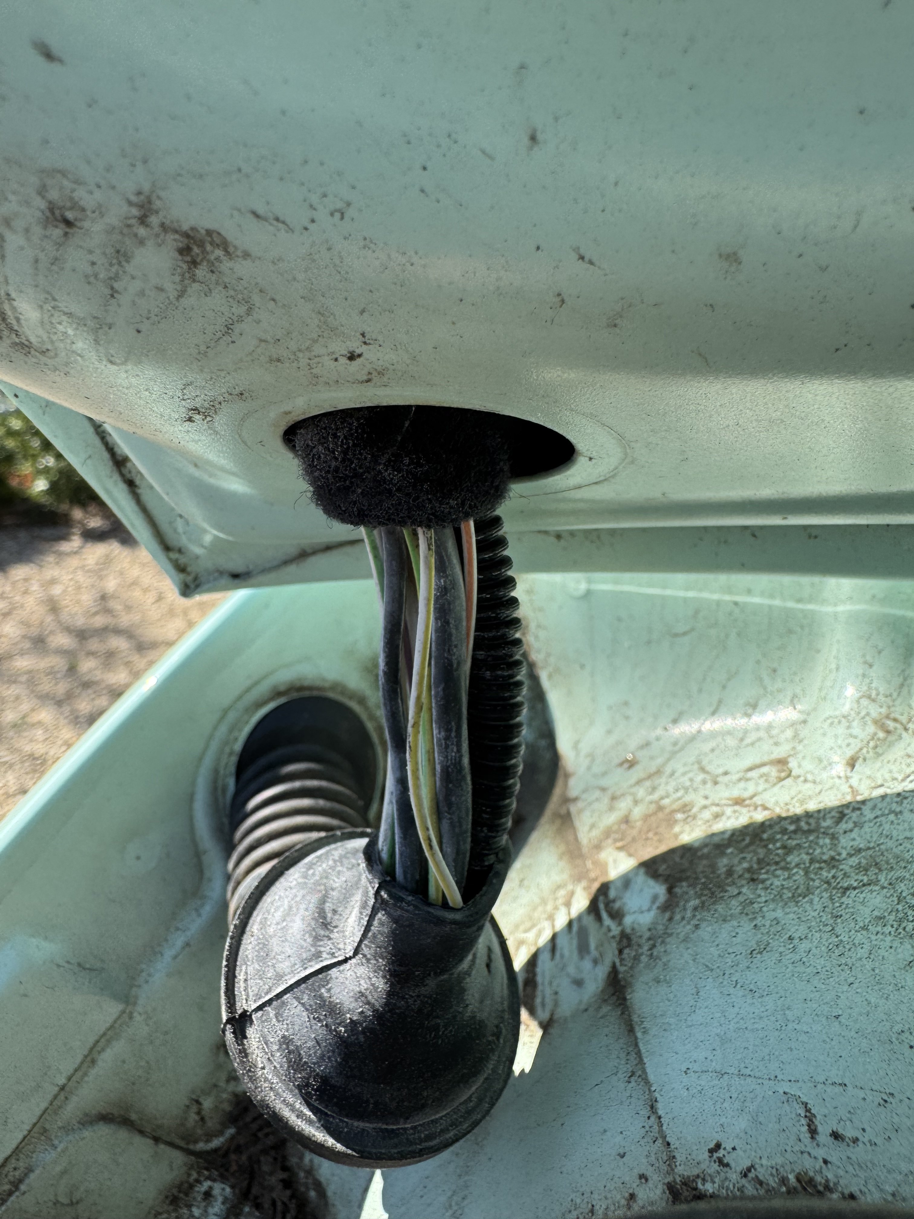

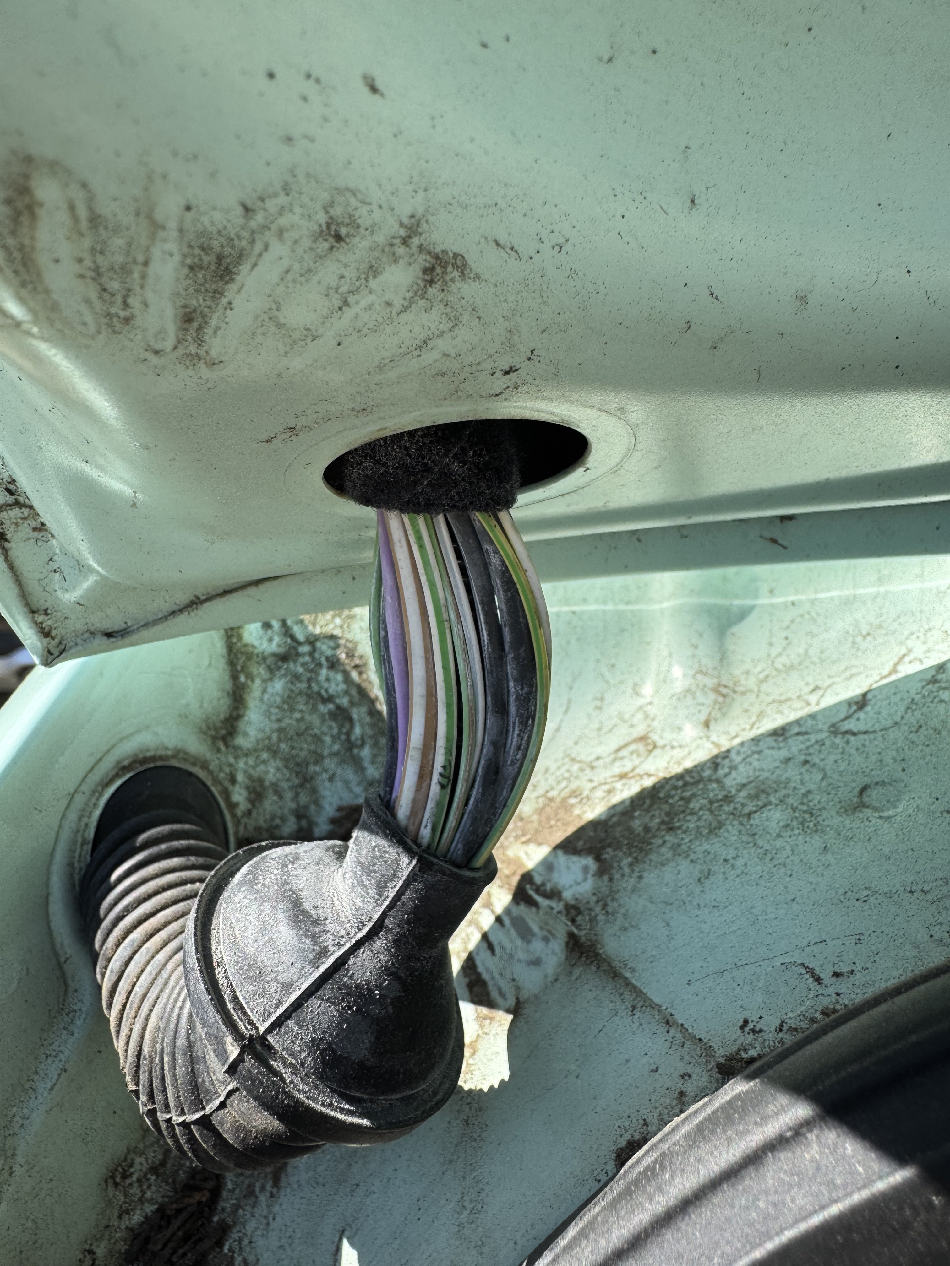

The hatch wiring, as in the wiring that connects the tailgate to the roof/c pillar at the rear top left?
It’s encased in a rubber tubing, no signs of damage from the exterior, I can only pull the tubing up so much to inspect the wires but there’s nothing obvious, all looks very clean and neat, very ‘factory’
That's normally what you'll find. The grommet looks pristine; peel it away to reveal the wiring inside and it's anything but!
Mine failed on the hatchback side, not the bodyshell side.
These look pretty clean and tidy. No obvious breaks

Agreed, that's where I'd expect to see a problem if there were one.
So if you experienced the faults and the wiring was the initial cause that then affected the airbags? If I’ve read that right.
Then presumably an earthing issue? What else is airbag linked at the rear tailgate aside from a common earth? Does the 500 have crash sensors linked to the front airbags at the rear? Thanks
