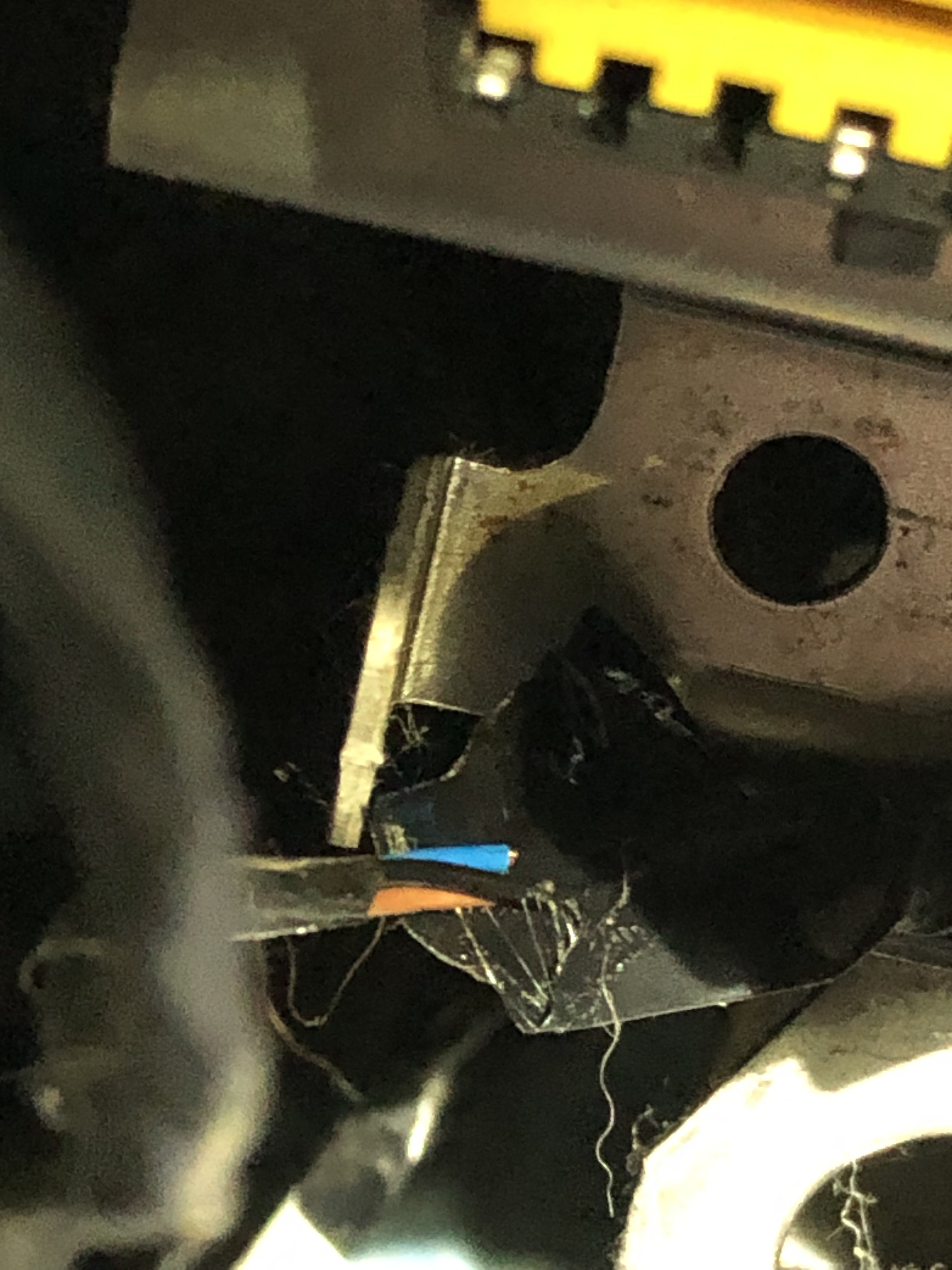

Opened odb port cover and found this

Are the cut wire going to the obd port? If yes I think I know why they're cut, no can signal?
The engine sound, clattery and rough, the car is a pop so no blue tooth.
the cut wires….not actually sure they are cut, they are taped up but the other end is connected to a tag/ bolt/screw. My intention was to reconnect them….I can added another photo tomorrow….what would be the reason?what are the wires?

Just need to know what that wire is do you have an idea John?
SO closer inspection leads me to believe that the third black wire is a tiny earth and the others have been cut imho

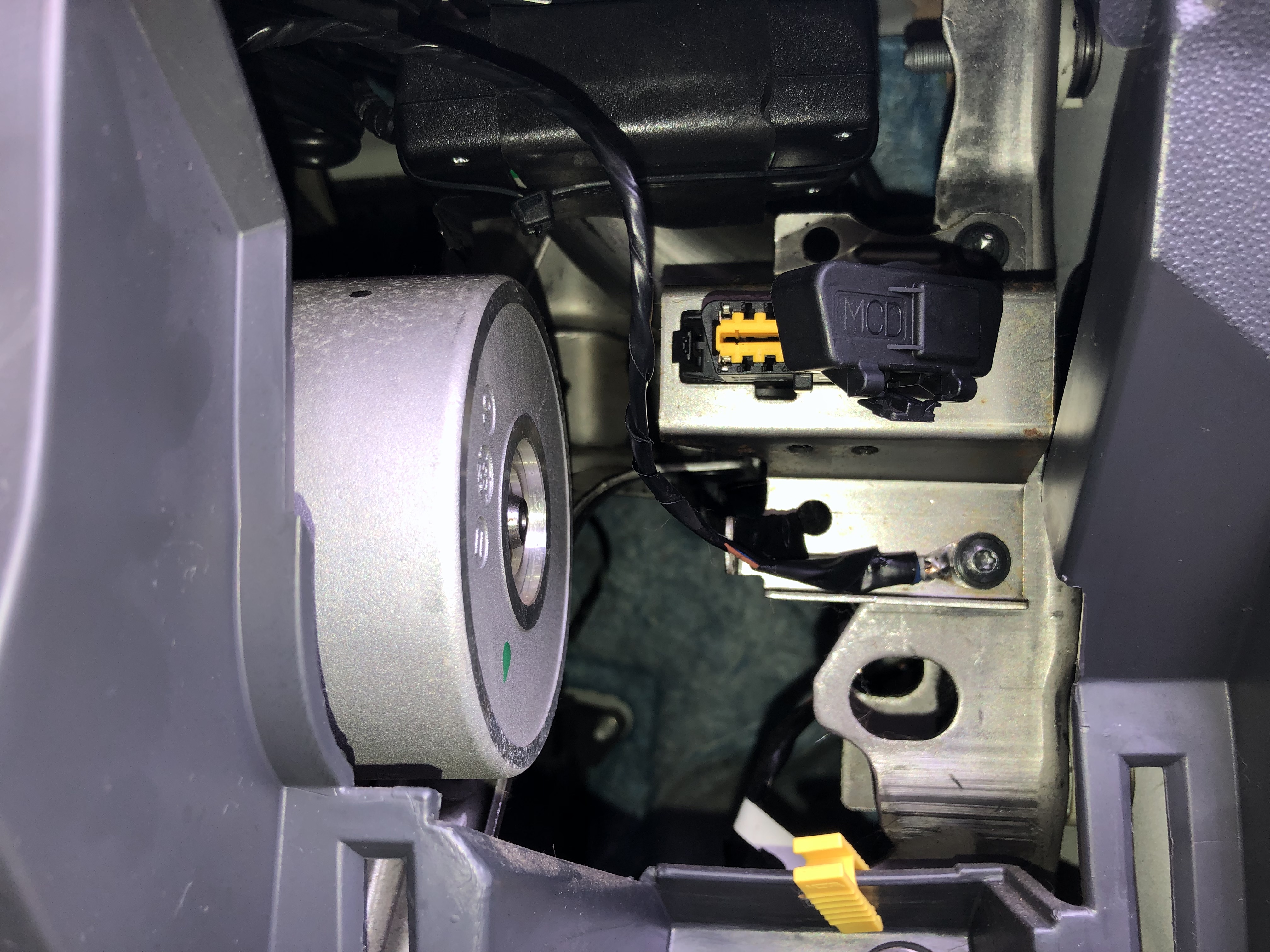

feels like they go up into the lower steering wheel area
Can the lower cover ( the one below the bottom half of the steering wheel be removed?
