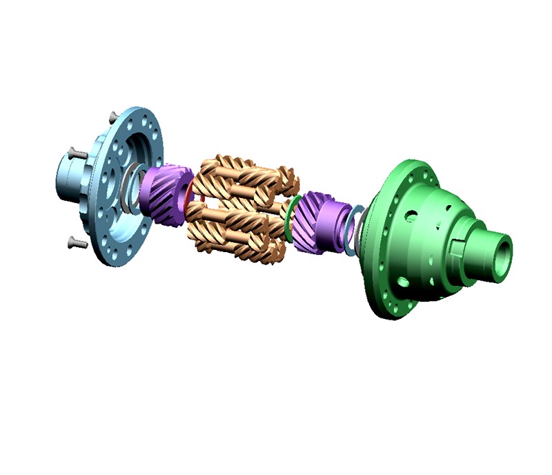

thats great news. you might be the first to fit it too. so it made no difference with yours being selespeed?
annoyingly they only engine that isnt compatible is the alfa 1.9jtd 8v M15 and the fiat 1.9jtd 8v M50 (mine :( ) the 8v mjtd and 16v mjtd share the same diff so can have it fitted.
The differential came today!

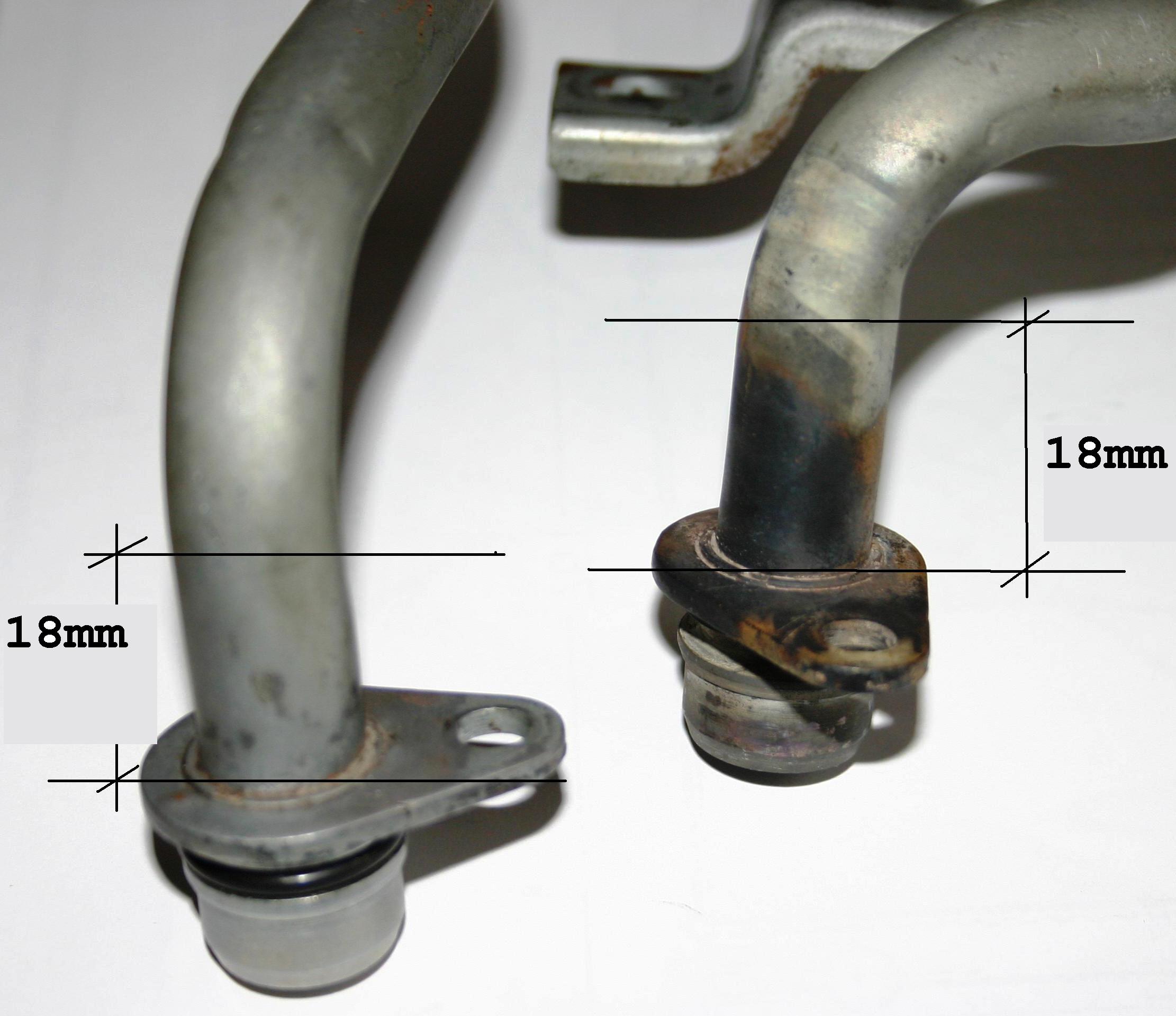

Is there anyone out there that I could post these pipes too to have altered? I need 18mm cut off and then brazed back to the fixing plates in the same orientation as before they were altered. There is enough straight pipe to do this although is doesn't look like it on one of the pipes!

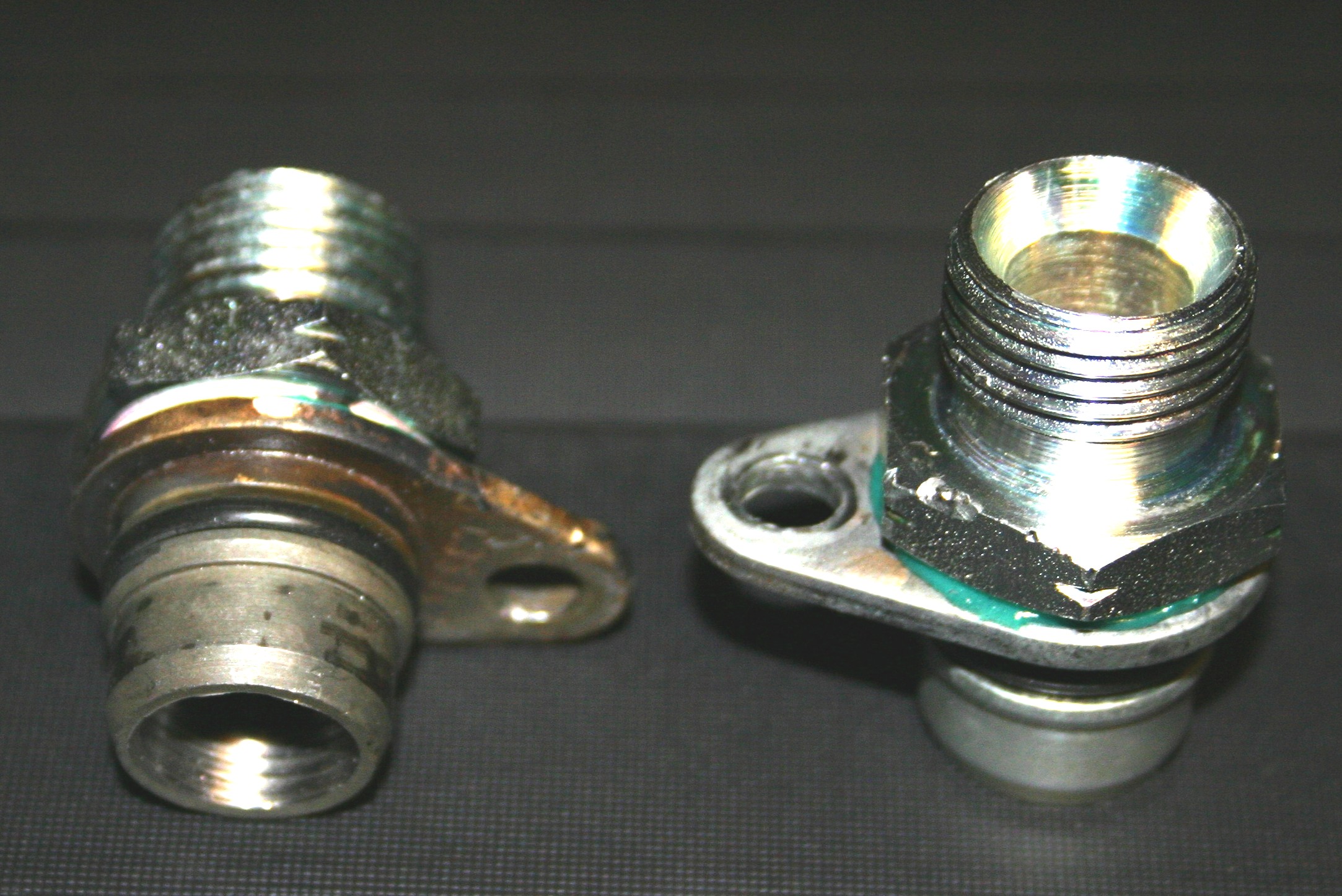

Found another way, cut the pipes off flush with the union, dilled and tapped the union to M16, bought some adaptors, 1/2BSP x M16 X 1.5 (mm) and screwed them in the Fiat union's. You will need to remove the fixing studs on the sandwich plate and replace them with set screws as you can't do the hold down nuts with a socket as the socket hits the new union.
A couple of pictures to show what I mean.
Thats some nice modification work there, i was going to offer to do the job when i got time but you've made a good job of it, theres not too much restriction on the ID after that is there?
Jordan
The ID of the original pipes are just under 13mm. Although the outlet on the new union is 13mm, the M16 part screwed into the Fiat unions goes down to 10mm ID, hope this wont affect the flow? All the pipe connectors I've bought are 10mm ID. The Aeroquip hose is also just under 13mm ID, I was advised that these connectors went with this hose.

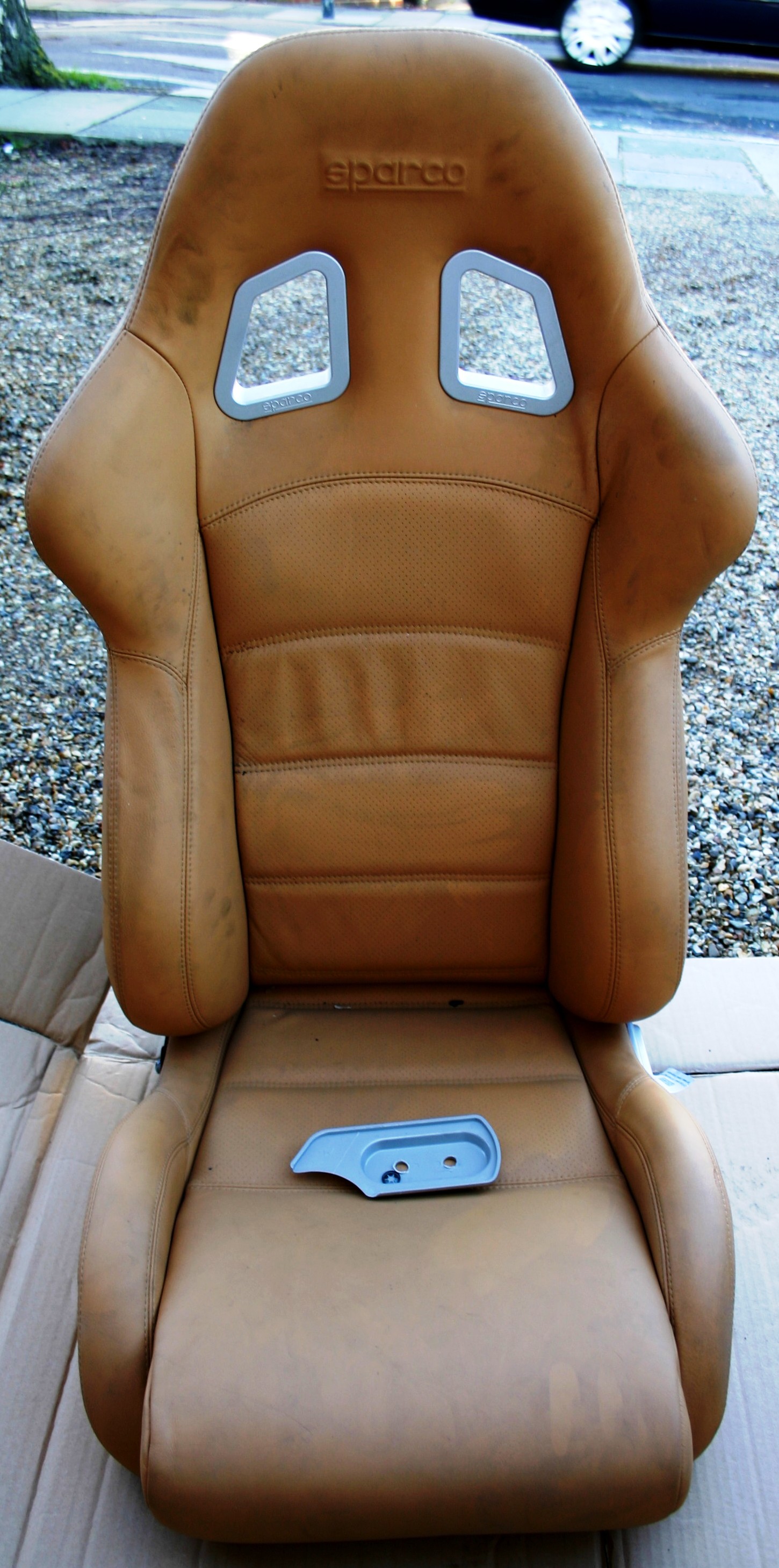

Managed to get hold of this, bought it on the spur of the moment, but thought it was worth it, as they are he seats I wanted to put in the car later. Just need to either save to buy a full retail one, or just wait. Got it from Ireland for £303 including shipping, not bad considering the cheapest I've seen them for is around the £700 mark plus shipping!
you know the seats have airbag sensors in them? will you try and transfer them to the new seat?
I realise the existing seats have airbags and sensors, the sensors were always going wrong on the passenger seat! When I eventually change the seats, I will just have to see what is involved with these sensors and how they are fitted to the seat.
They make the Stilo without airbags in the seats, so I will just look on eper as to what is different between the two, it might just be just the case of changing the airbag ecu?? I don't want warning lights permanently light-up on the dash!!

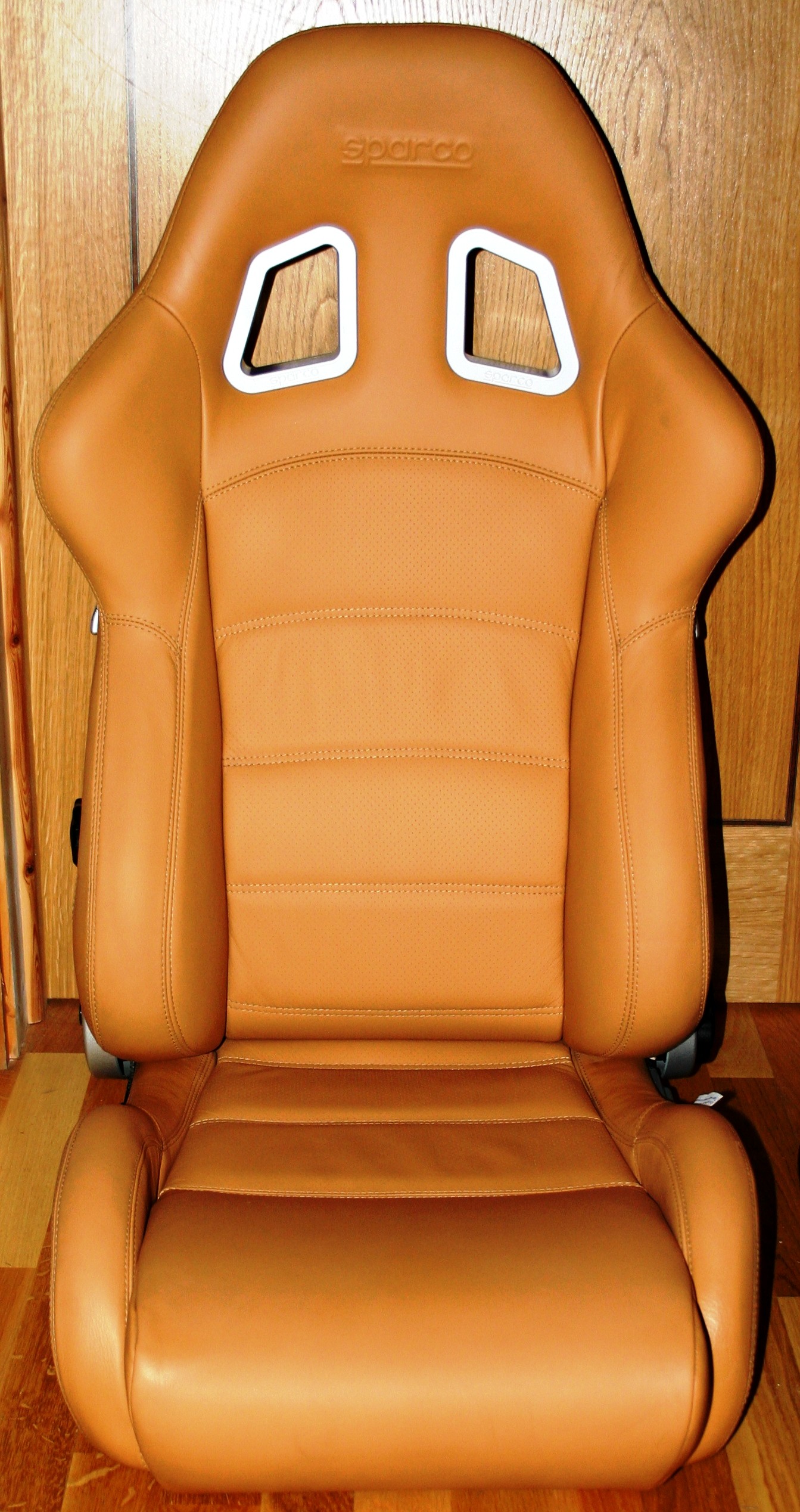

Wow nice seats! you re-trimming back to match?
The above picture is what I wanted.
