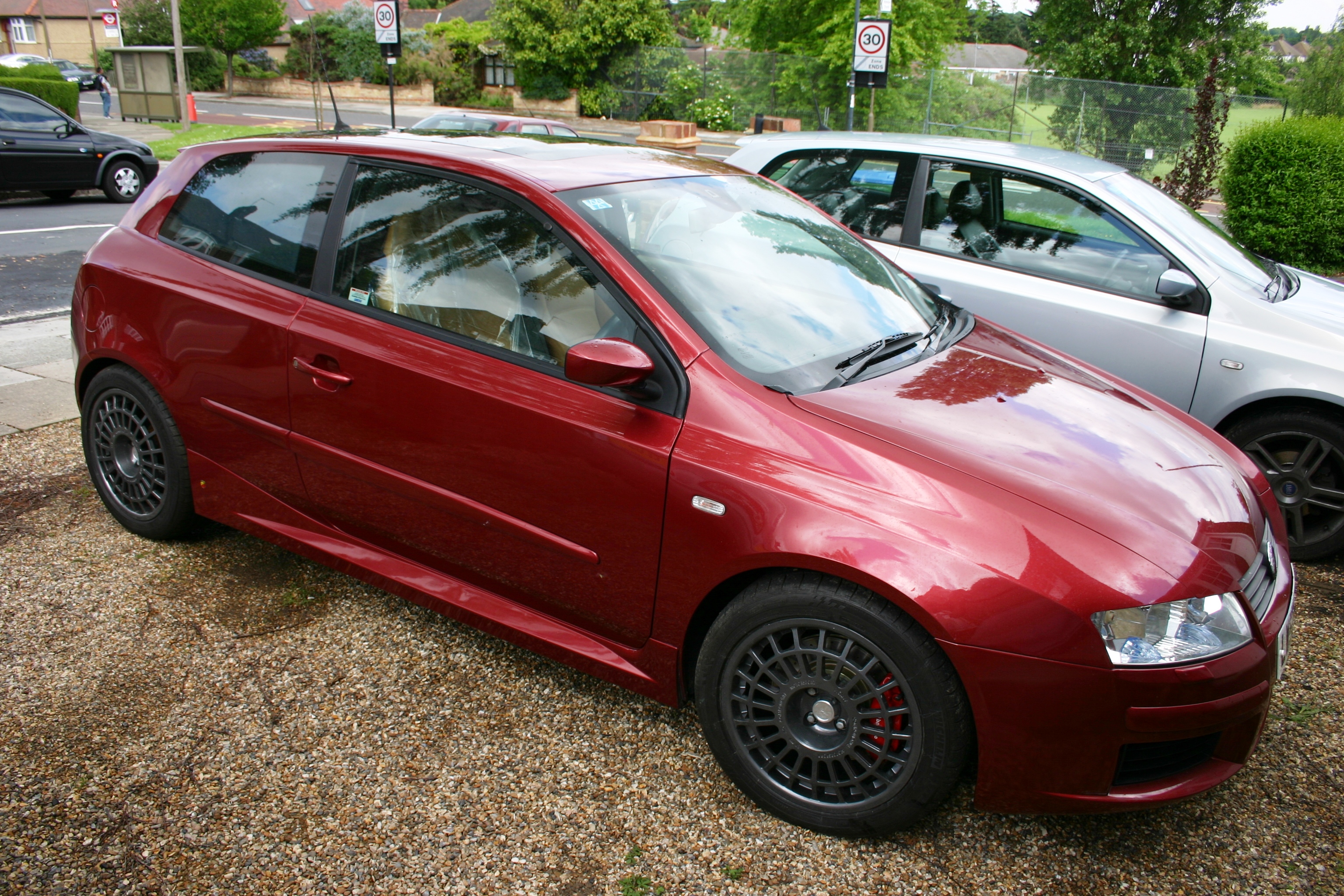

Not too well, it's been sitting in my garage for a couple of months now waiting to find someone with a Fiat examiner to come a get the thing started, got so bored of waiting, and needing the car back on the road, have taken the turbo, pistons etc off and putting it back to original (engine only).
Leaving the new forged connecting rods in as well as the turbo camshaft. Without the examiner, I could not unlock or pair if you like, the thesis turbo ignition ECU, so I've given in, after all that initial enthusiasm and money, I just needed to get the car back on the road.

About eight months work and approx 10.5k although of that it was about £1100.00 for the Brembo's, £450 for the suspension £1000 for the seats. £1200 for the wheels and tyres, so the engine parts came in at about £7250 on the engine, of which the rods and pistons where £1500, exhaust manifold £350 etc.

Finally put the car back to near original, accept the forged con-rods.

Come to the end, and its gone full circle! After spending a shed load of money and fair few months of my time, I have reinstated it back to near original. Mainly due to not being able to find someone with a Fiat Examiner to come to site and start the bugger! However, here is a list of what I did do in the end:
Compomotive TH2-1775 Wheels a Michelin Pilot Sport tyres.
Alfa Romeo Q2 differential
Koni Sports suspension all round with a 30mm drop
4-pot Brembo GT brake upgrade
Forged con-rods
Schumaker rear silencer
Sparco Milano Prestige beige leather front seats
Carbon fibre water transfer printing of all centre console plastic trim
At least I have learnt an immense amount about this car and now know what is involved in this conversion, if I ever wanted to start it up again!!
