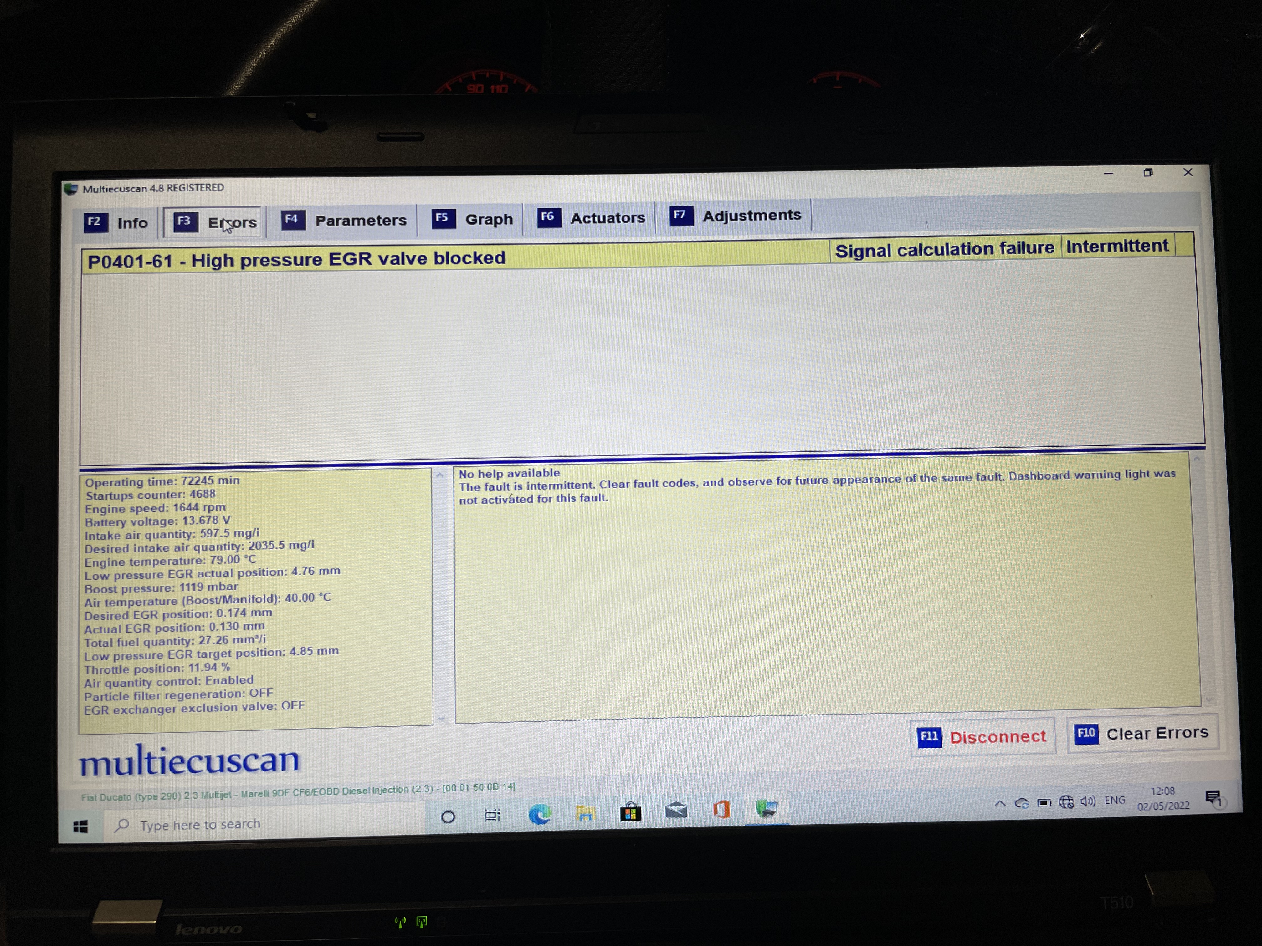

On the way home after 2,6 km limp home mode P0238-061, reset, came home with no problems. Connected MES and there was pending code P0401-61

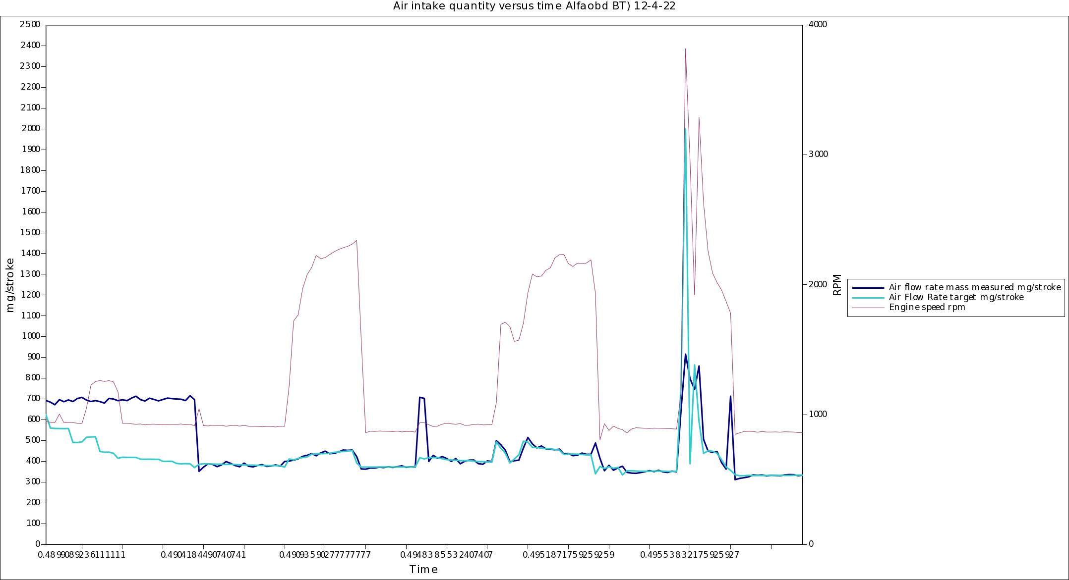

attached are a number of graphs showing air flow. Descrepancies show when under acceleration.
I Have done some trials with both MES and Afaobd using OBDlinkSX usb cable and VGate BT dongle.
note Alfaobd and Mes uses different units.
These were taken as a stake in the ground before getting ecu update and changing the MAP sensor (to se if i have one of the incorrect sensors.

5/. yesterday when we were out for the day, P0401 and dash light came on when I decelerating at slow speed with foot off. Manifold airflow would have been very minimal so a blocked manifold could strangle what flow there was.
6/. I have MES screenshots of both the fault and the dpf status.
