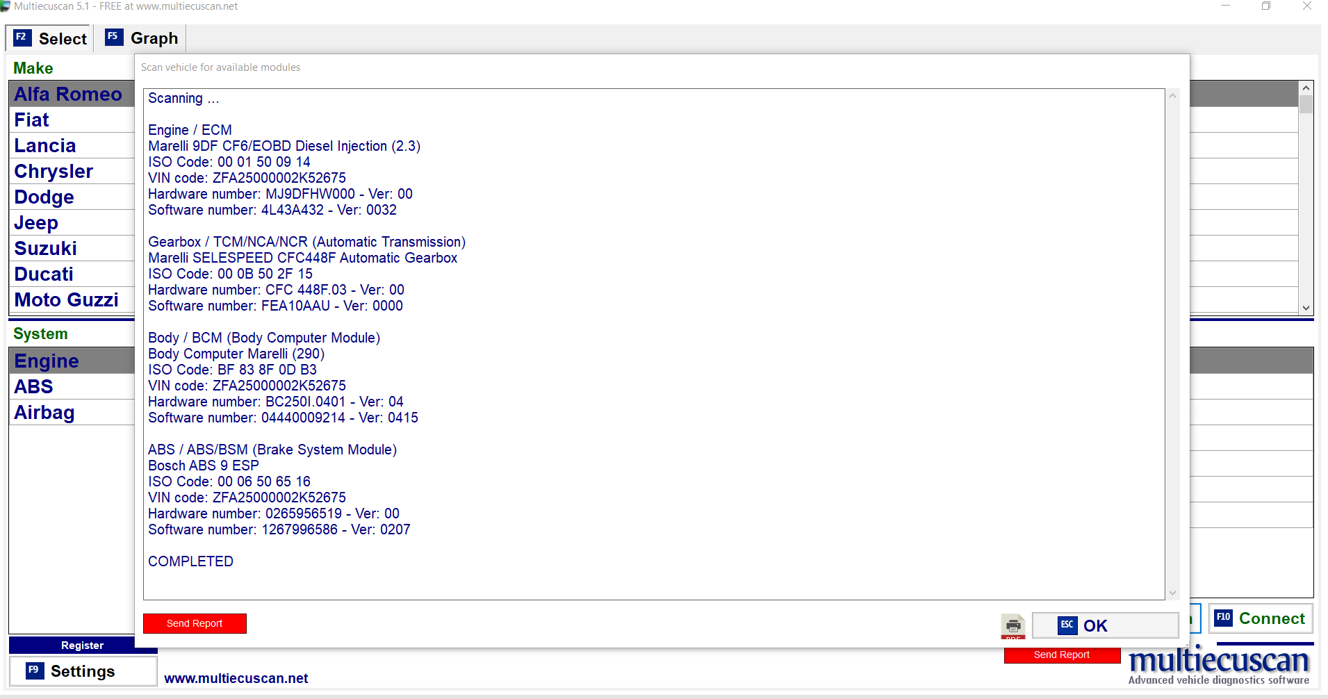

Got the Vgate Bluetooth adapter and used Multiecuscan to obtain the data. It looks like the dealer either installed or the van came with V32 firmware. So this is all correct I assume?
