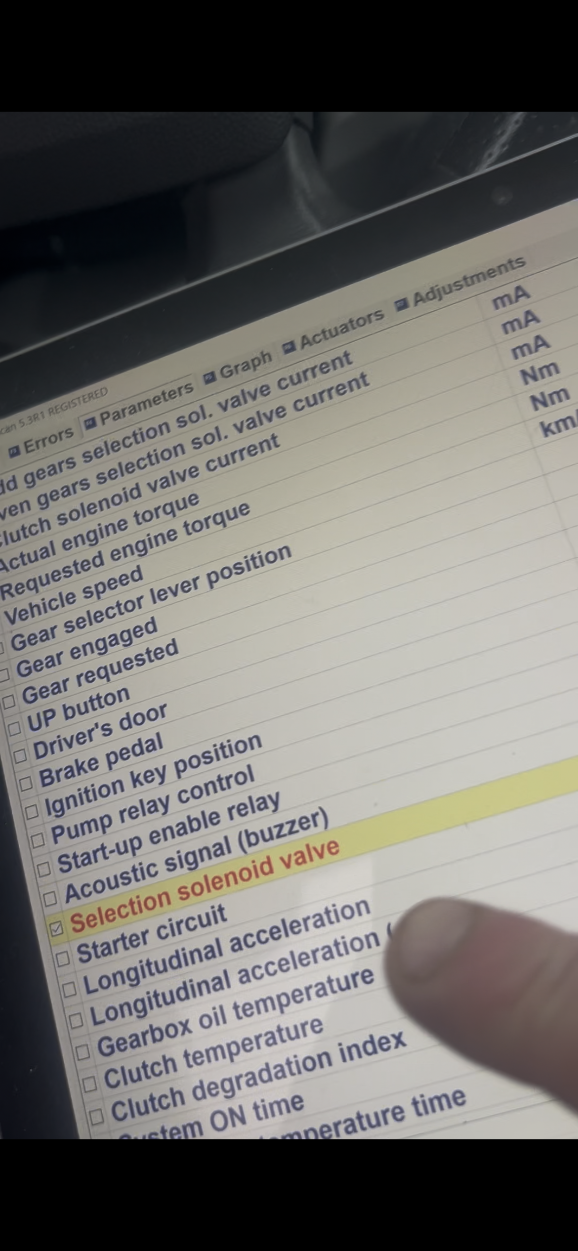

Just a little update on my van since I did everything myself with the no gear situation
So since changing the clutch position sensor and Evo solenoid been no issues
I keep testing data is mes just to check sensors etc are good and everything has relearn
One thing I noticed today even tho gears changing great
Clutch seems great
But in parameters I am noticing
Selection solenoid valve says not active
Which I would have thought this would going up and down with gears selected
Can anyone check please if it’s the same
Can anyone test the comfortmatic that has no issues to see if this goes up or down please
Since the work I did I have no issues driving at the moment but did notice
Up or down in gears which I would have thought this would register

But this one may be nothing ,, but from my experience every solenoid or sensor does show on mes doing something and this one doesn’t
Selection solenoid valve not active ??

I can't find that parameter at all in the parameter list for my MES 4.8 so I assume it was added with some later program version. What does the help text (yellow window on right hand) say about it? Perhaps it is EV 3, my version only shows odd and even gears selection valves (EV1 - EV2) and clutch valve (EV 0).
(For what it's worth: for the selection solenoid valve parameters my MES version does have (odd and even gears), the readings are 0 mV with engine off and no gear change in progress. During gear changes while driving, I have recorded currents up to 1470 mA for both).
Thanks mate yes mine do the same for odd gears etc but noticed this one and worried me a little 😂
I will check the window see what it says
