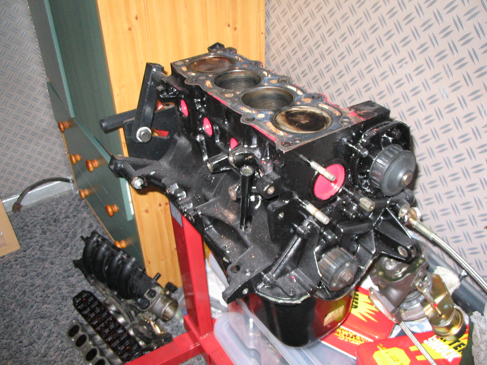

righto! update time. Muchos progress has been made on the thinking front! lol ;) The turbo is going to be 1242 8v MPI with the whole engine management handed over to Megasquirt running alongside an Innovate LC-1 Lambda. So i'm now on the lookout for a P75 head, although i have no money :(! Christmas is creeping up now too, hopefully someone will buy me a megasquirt! lol ;)
Anyways I had a day off work today so took a trip to the scrappy and treated myself to these little babies ;)
Thats right, p85 16v pistons and rods, that's what i'll be running in the turbo block, so as soon as i get some new half bearings for the bottoms they'll be going in here:
Please continue to follow my thread, I haven't given up i promise! For those of you who are wondering, the broom yellow Abarth cinq i bought is going to be the one getting the turbo treatment ;)
Thanks for looking
Lenny

Another question, Who could lend me a hand programming the MS when i get it all wired in? And could someone please work out the CR that I am going to arrive at with the 16v pistons fitted, Trickers thread says 7:8:1 would this still be correct after the head is skimmed? Sorry to be a pain!
Lenny
depends how much of the head you skim off.
i should be able to help with the MS mapping (y)
but if i get a 2nd hand head, then get it skimmed before fitting it, how do i know if it's been skimmed before? can i measure it?
And nice one with the ms mapping, i have them maps that you gave me but neither of them suit the 7:8:1 compression ratio that was given by tricker one has got 8.0 written on it and one 9.8?
Thanks again
Lenny
